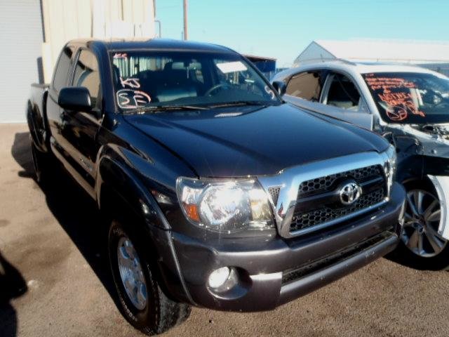

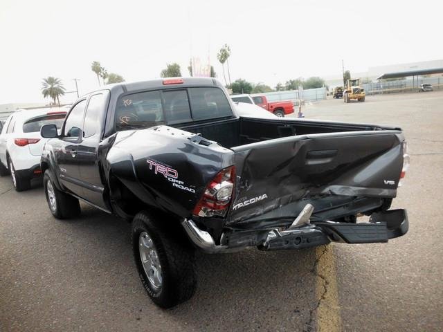

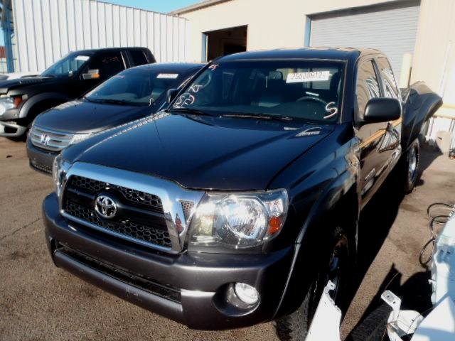

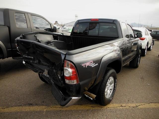

    Hey guys, i want to buy this truck:
    http://www.lespac.com/vehicules/cam...-tacoma-trd-4x4-LPaZZ27554755WWcpZZ27WWgrZZ12

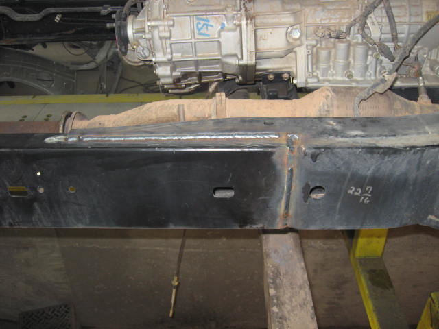

    So i called the guy and he told me the truck has been in an accident and that the box/bumper were replaced and that the frame was damaged. (see pictures below)
    He told me that the left channel of the frame was cut at the factory joint and that a new piece has been welded in under the cab and that is has been coated with the toyota undercoating + antirust. Does that makes sense, i thought the channels were one piece the entire length of the truck (he says the factory frame is made in 4 sections, is that true?)
    the truck seems super clean and with the mileage/price combo seems pretty decent especially for a TRD. What you guys think??
    thanks a thousand guys.

    Good looking truck in the link, but for $22K you can go find one that hasn't been smashed in half. Surely it has a salvage title too?

    So by his pics of it wrecked I can tell he got it from the Copart Insurance Auction, which means he scored it for a decent price most likely.
    Personally I wouldn't mind buying a truck with a correctly repaired frame but I'm definitly not paying full price for it. The car fax history will always be bad even if the title wasn't salvage stamped since the insurance company was involved.
    Now that being said, you can take it to any body shop and have them put it on their frame machine and get a print out of the frame specs to see if it is truely within factory standards, may cost $50-100 bucks but well worth it.
    As for the price, I would make sure I was going to be saving atleast $5k off the price compared to any other identical model for out there for sale.
    Have the vin ran by your insurance company first also to make sure they will cover it fully and there is no hidden salvage stamping.

    From the pics, I doubt it has a salvage title.(of course that's going off of how we do salv titles in TX)
    Toyota (and all manufacturers) have areas in the frame on body on frame vehicles that they will allow a repair section. Basically if the shop follows the guidelines they will section in a new portion of the frame. If done right, I don't really see much of a problem. The section areas are usually within 2 feet of the front or rear of the frame rail.
    I would stay away from this truck though, unless it was repaired at a shop you personally know and trust. Even then, I would discount my offer.

    ok scratch that.... I would definitely not buy it. It came from a salvage auction which means likely a rebuilder did the work. It would probably still have a clear title, but a rebuilder is a lot less likely to follow manufacturer guidelines as they are just fixing a totalled vehicle as cheaply as possible to sell it for as much as they can get

    I paid that for mine without damage off a lease here in the states. That bumper is wrong too, looks like a sport bumper on an offroad package.

    Looks like they put "sport" stickers on the bedsides too, when it started with "off road"...
    I wouldn't buy it...even if the ad says it in 'showroom condition'
