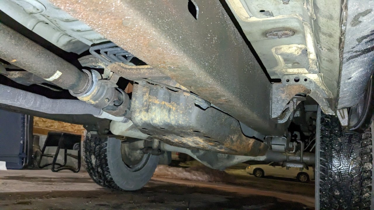

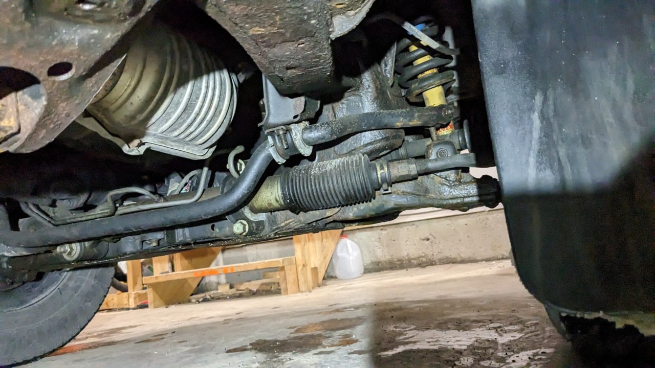

    I was looking to buy this first gen tacoma it looks to be in really good shape 210,000 miles and minimal rust and body is in good shape

    Underside looks clean though.

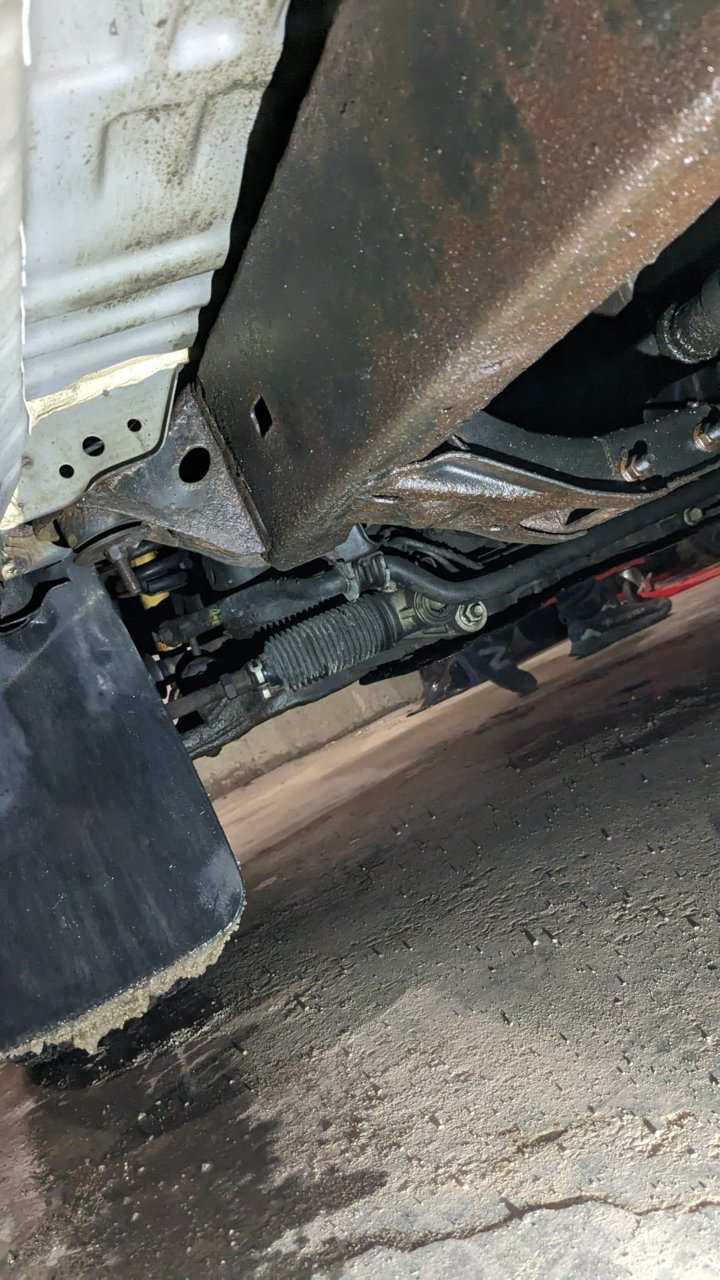

    Man, you guys must be seeing something I'm not cause that truck is something I'd offer $3-4k tops for
    Shit ton of rust specifically around all the body mounts and the part of the frame right behind the front mount; it's flaking and probably worse than it looks
    Really, I'd just skip it and continue my search

    Check out picture number 6, behind the body mount alongside the CAT. It looks pretty flakey there.

    With my very slow internet all the pictures had not loaded yet So not seeing that picture when I made the comments.
    I now agree that has far more rust then minor!!
