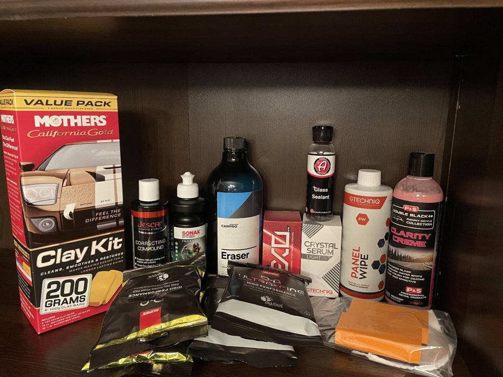

    Yup, the majority of that price is for decon and paint correction. Materials themselves are a fraction of that. As @MGMDesertTaco said above it's tough to beat gtechniq CSL/Evo, it's one of the best coatings on the market and you can get the 50ml kit (enough to fully coat a gen4) for sub $200

    It's not as simple as applying wax or sealant though. Temperature and humidity affect flash times and if it's not wiped off all the way or in time it has to be polished with compound to remove.

    That's entirely dependent on the product. Something like Gyeon MOHS Evo isn't going to be affected much by environmental factors due to the nature of it's quick flashing time, but something like gtechniq CSL/Evo which is a 2step process with slow flashing times will absolutely be affected. There's a reason you see shops in cold climates doing coatings under heat lamps.

    Ceramic Coating is GREAT and professionally applied at $4k is the best. But you can get really good results at home if you spend a Saturday Afternoon on it.
    I've done a whole truck over a week by just knocking out a quarter-panel or two a night after dinner when the weather cooled off.
    Total cost for a DIY could be around $100 plus a few hours of your labor. Is it as good as the $4k job? No. But is the difference between the 4K job and the $100 job worth the $3,900 in savings? Yes. Mine lasted about 3 years.
    My process was:
    1. Wash and Clay Bar the Vehicle
    2. The finest polish / scratch remover. You want to remove as minimal as possible. Just looking to knock the edges off the scratches - ceramic fills them in. Rinse with water.
    3. Iron Decontaminate. Smells bad but pulls contaminates out of the paint before you seal them in. Rinse REALLY GOOD with water.
    4. Clay Bar. Rinse with water.
    5. Wipe with alcohol - no water after this.
    6. Start applying your Ceramic Coat.
    7. Nothing wrong with two coats but it is a little tricky.
    I could get 1-4 done on a Saturday afternoon easy. Then 6 and 7 over a week in the afternoons. Breaking up the Ceramic Coat like that means you start each quarter panel refreshed and focused. Otherwise if I do them all at once, I find that there is a difference in my quality from the first to the last panel.
