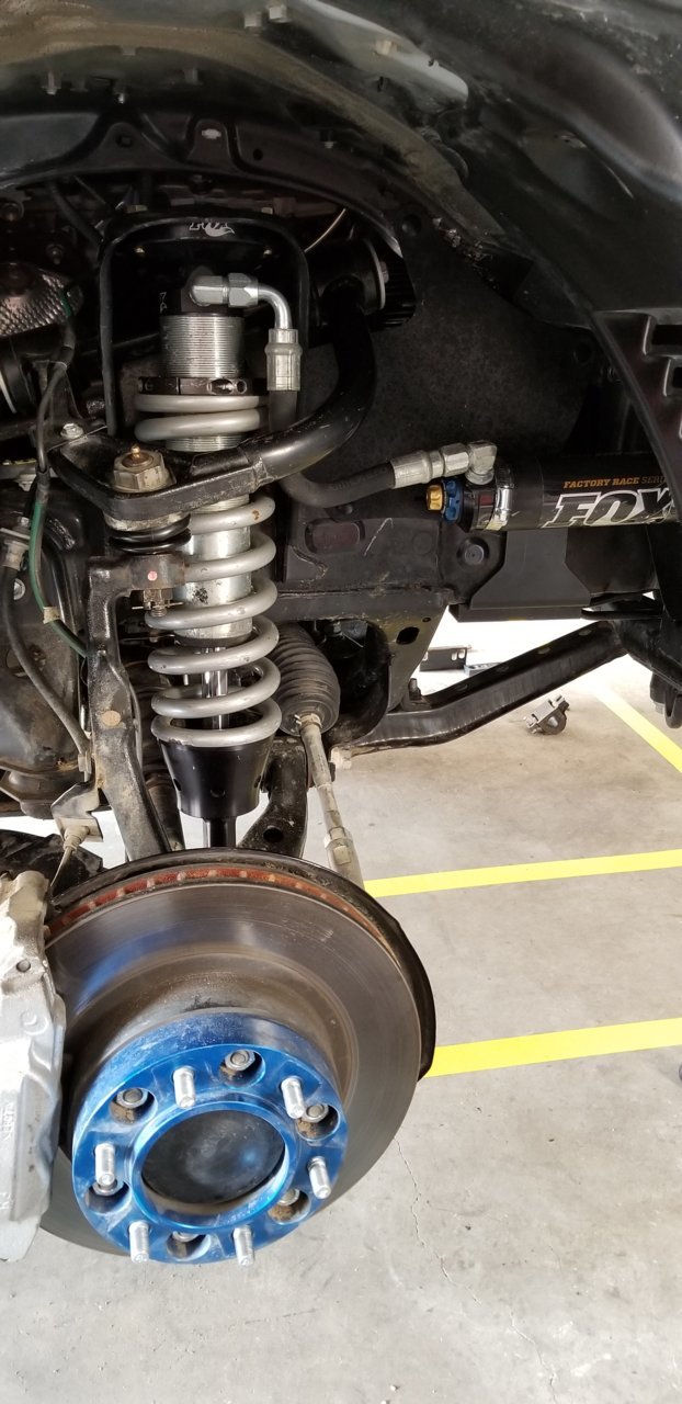

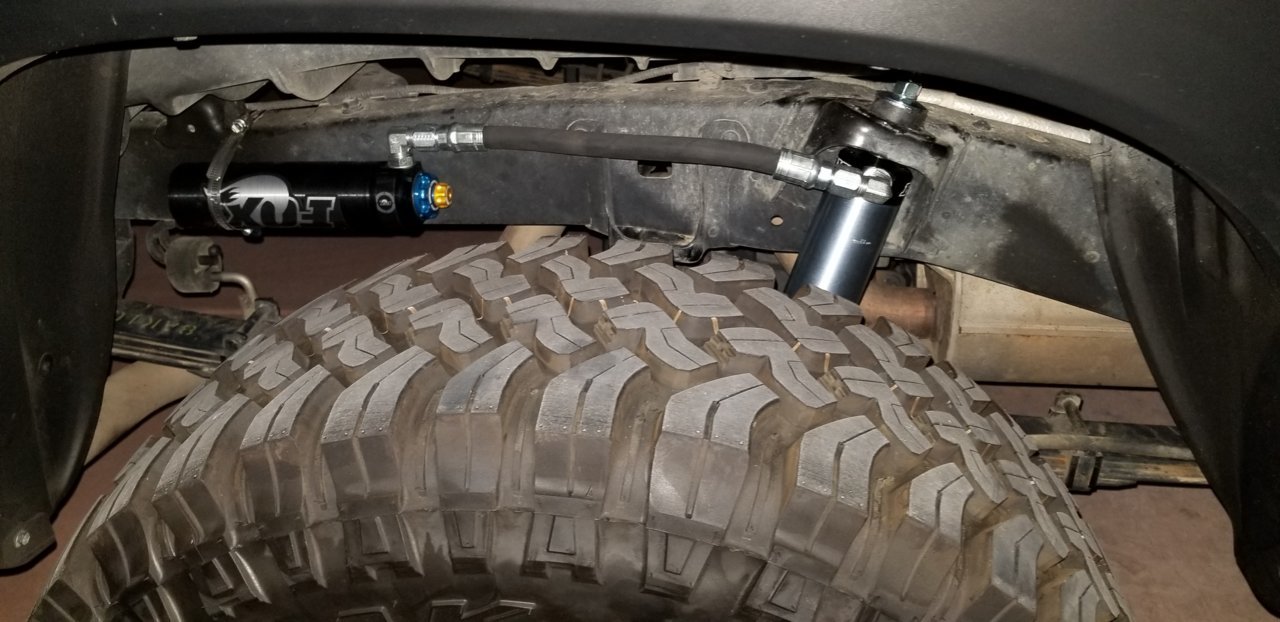

    don't settle for less. spend the extra coin. you'll be glad you did.
