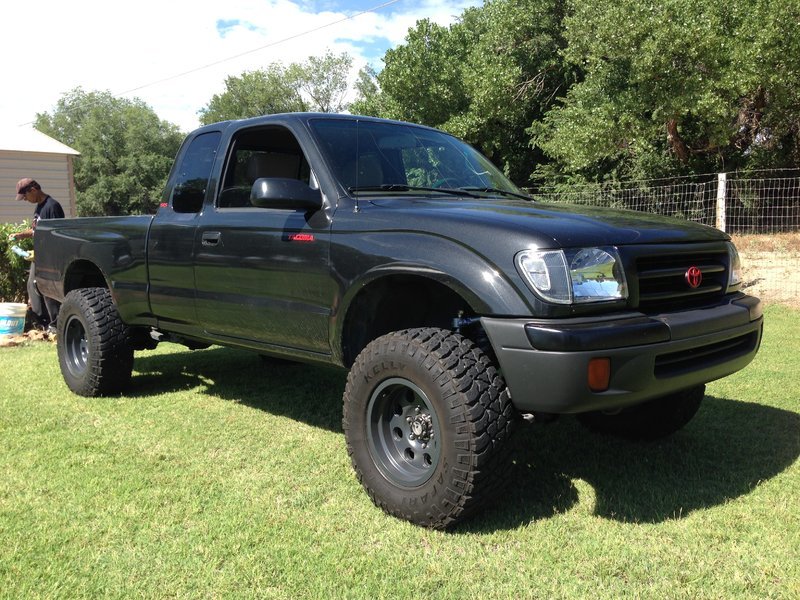

    Here's a couple pics from when I had 31x10.5-15's on my truck. At the time I had a 1/2" block in the back and my Icons adjusted to about 2" or so in the front. I later went to 33x12.5 and replaced the block with an Icon AAL (1.5") and bumped the CO's up a few more turns to get about 2.5" in the front.
    When I had the 31's, I was all motor 2.7 with 3.90 gears and it was ok in town but lost decent speed climbing hills here where I live. Further up in elevation I went, the worse it was. When I first got the truck it had 285's (33's) with the 3.90 gears and it was ok in town still but on the hwy it was pretty rough. I got rid of those pretty quick

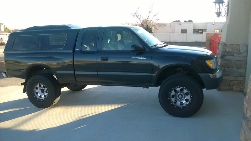

    I just edited my post a bit. I remembered that it had BFG KO's in a 285 when I first bought it. This is what I looked like then. Had a nasty spacer lift

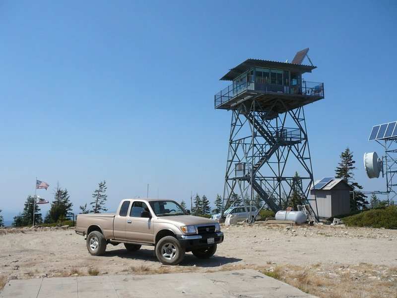

    What question has not been answered? Just want more photos?
    Here is mine ( 1.5" lift, 16" stock TRD wheels, and 265/70 tires) :

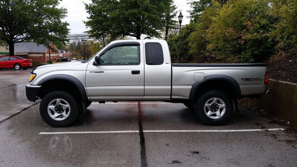

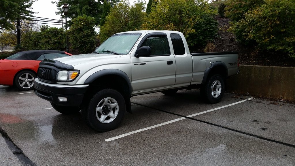

    mine with stock wheels after OME lift. hard to see from lighting but this was last year
