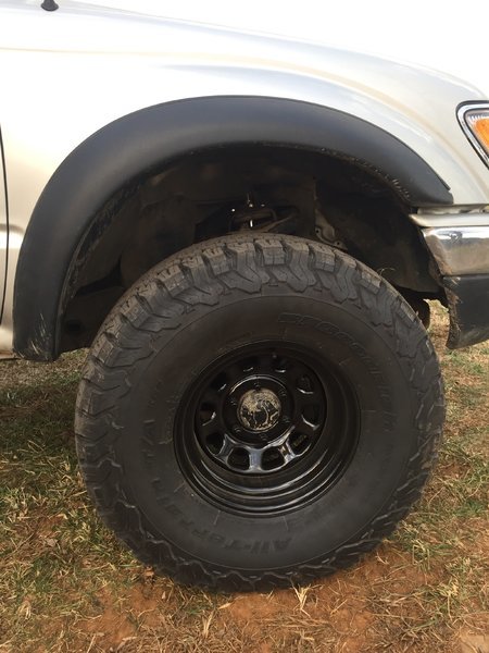

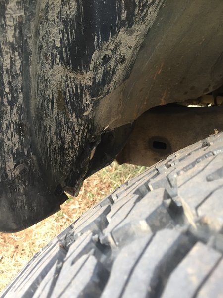

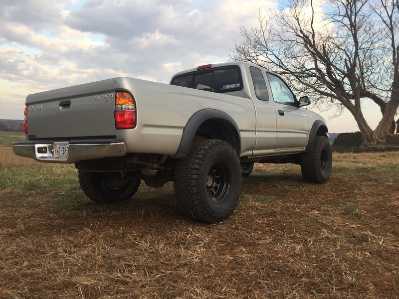

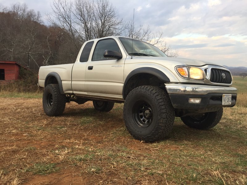

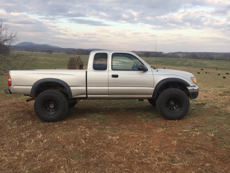

    IMG_3080.jpg IMG_3082.jpg IMG_3084.jpg IMG_3086.jpg IMG_3085.jpg The last pic isnt very good but its the little bit ive done to the pinch weld.

    I my experience is limited playing around backcountry and logging "roads" in the Sierra foothills most of my life, also deep rutted private roads, all having snow 2 1/2 ft or less. Haven't done much hardcore off-roading or with groups, but planning to. Was into muscle cars, am an amateur mechanic, and did engineering & physics course work in college that helps understand what happening with these changes and some of the tradeoffs but I am no expert.
    Bigger tires and lifts mostly create ground clearance and can give more traction and floatation, but do have significant tradeoffs.
    They bigger tires create a longer lever arm, that requires more force from the brakes to slow down the truck at the same rate, and loads the axles more in a directions making axle & bearing failures more likely, and as well as increasing loads on the entire suspension. The heavier tires also require more power to achieve the same acceleration, with increased fuel consumption. Having larger tires is kind of like hauling stuff around; it's a little harder on on the suspension, axles, brakes, frame, so will wear stuff out some degree faster.
    On-road handling is significantly negatively affected by the higher center of gravity vehicle lifts and larger tires create; some people use negative offset wheels or wheel spacers to compensate with a wider track, but making the truck wider which is trade off to me, and may load the wheel bearings more (I think).
    This was my daily driver when I got in '01 until before doing these mods in 2014 (got a Prius), but the project stalled due to some unrelated issues so have only driven it a bit onroad with 33s maybe 500 miles and pulled them shortly after cuz I had some slotted discs that were creating crazy vibration when braking. Finally replaced those discs and pads a month or two ago, just through the duratrac back on the front and truck does feel great again braking (seriously felt like it was going to vibrate apart). I've got to see if there is anything I can do to improve downshifting into 1st; basically have to be nearly stopped... makes the 33s much less enjoyable to have on...
    Definitely some people on here that really know what they are doing, and have much more experience & knowledge then me; one thing to remember is everything has tradeoffs; stock is the balance of intended use, longevity, on-road & off-road performance, operating & replacement costs, that were designed specifically for that exact vehicle by Toyota.
    Don't buy the line that stock is crap, aftermarket components rarely have the quality or do everything as well as stock components will (there can be exceptions). Also trouble shooting problems is much more difficult on a modified vehicle. Good luck and have fun ;)
