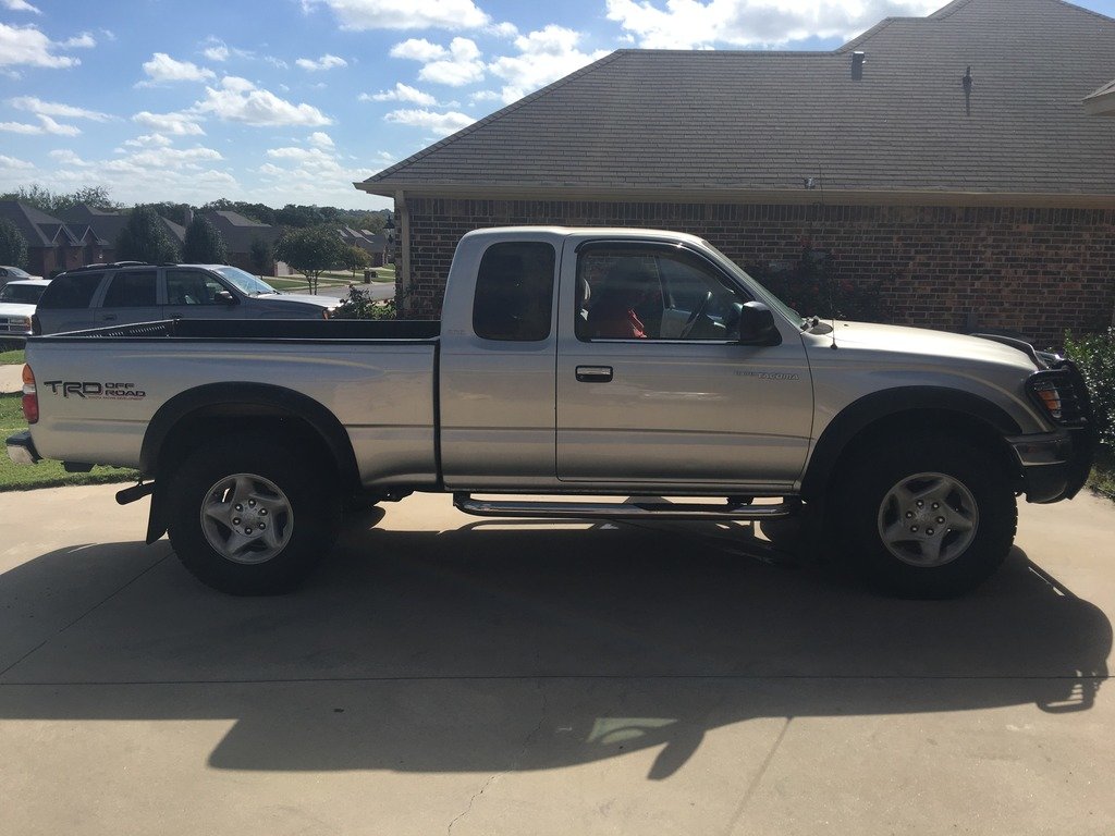

    Here is my stock suspension truck with factory wheels and 265/75r16's. I can't tell that it rubs the wheel well or pinch weld anywhere, but I do get some rub on the frame at full lock. I have a lift kit on order and intend on doing some aftermarket wheels with a bit more back spacing to hopefully stop the rubbing.

    What tires are those?

    Two are nitto terra grapplers (front) the others are a bfg A/T I believe. They were what was on the truck from the previous owner

    How do u think the 265/75s will look with a 2.5" lift?

    Hopefully looks ok, I'll know in about 2 more weeks when I get home and can have the lift kit put on.
