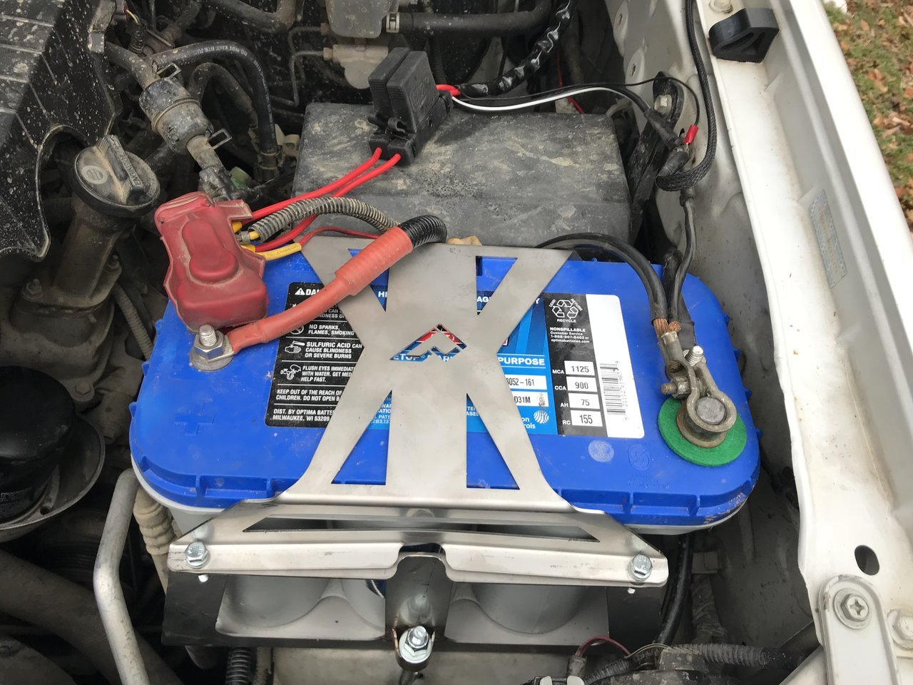

    Nice set up and seems much more practical than expensive dual battery kits. You mentioned you put a nice deep cycle battery in the stock location. So does that battery work with stock hardware? Who made the battery mount you pictured?
  10. Mar 25, 2018 at 8:18 PM
    EatSleepTacos
    Mar 24, 2015
    #151688
    59,830
    Randy
    West Valley, AZ
    2017 4Runner
    That battery cage pictured is made by pelfreybilt, and is very well made. The stock battery holder could fit, if you sourced longer J hooks and modified the factory battery holder. I did that as a temporary solution but feel much more comfortable with the battery cage. That thing is rock solid.

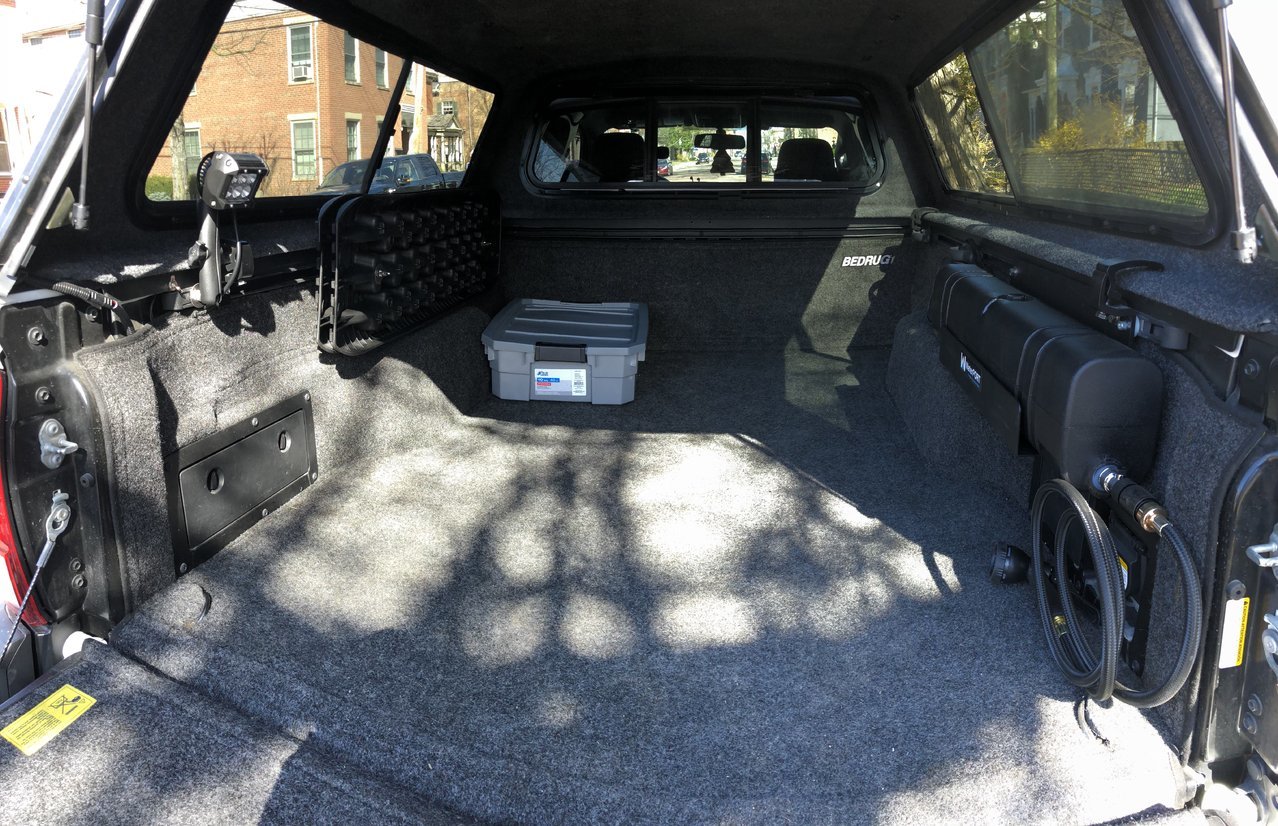

    I like the bedrug. I think that would be nice with the GoFast Camper... I'll have to remember that!

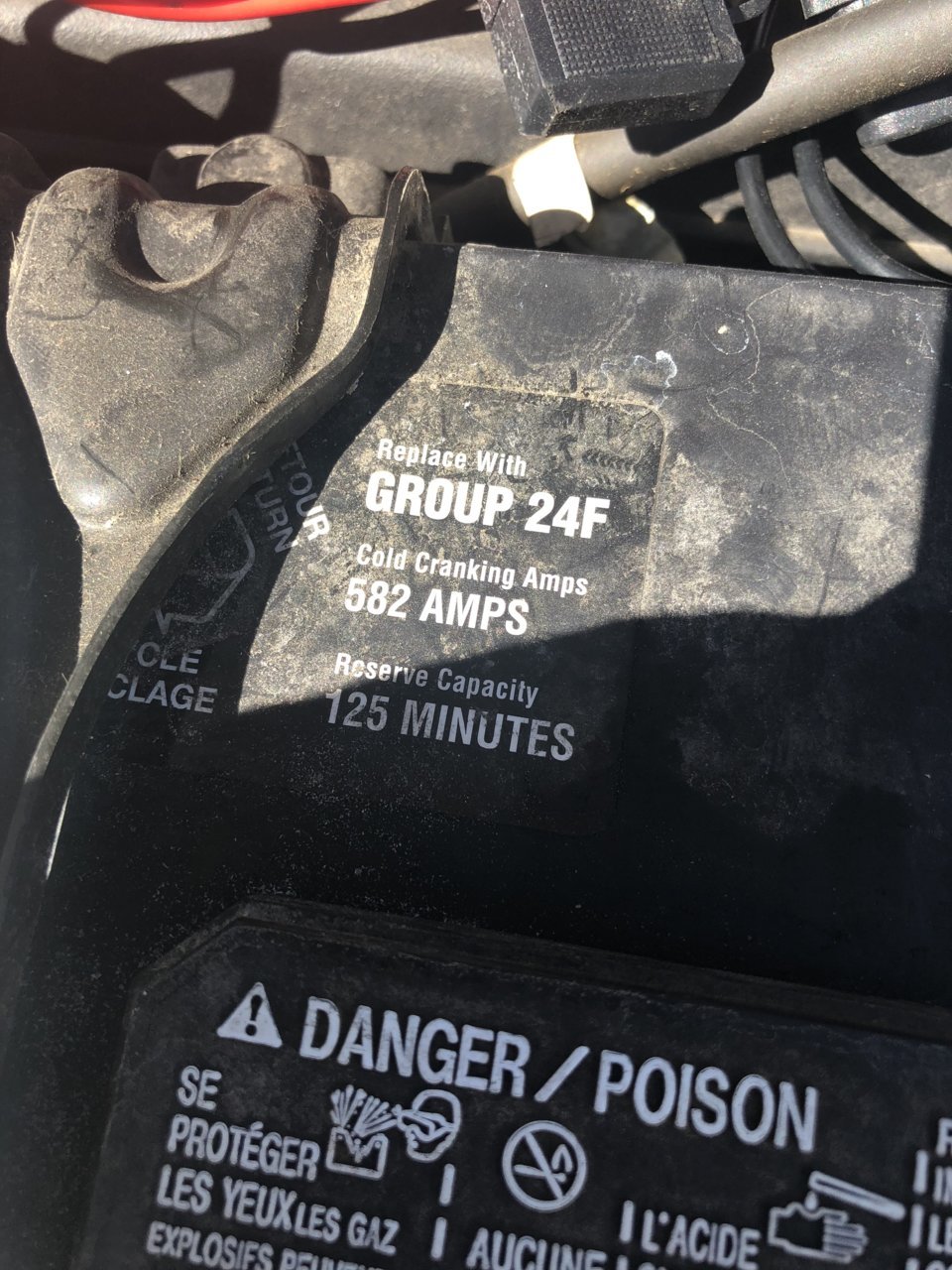

    I’m thinking upgrading my factory battery and taking along a jump pack and my 12v portable 101AmpHr. Battery pack I built for a back up is going to be the best bet as @EatSleepTacos mentioned.
    Now, can anyone point me in the direction of an upgraded deep cycle that could hold a cranking charge after about a 10hr constant recharge of maybe 5amps max? Worst case?
    Does that make sense? Haha.
    This is the factory batt.
