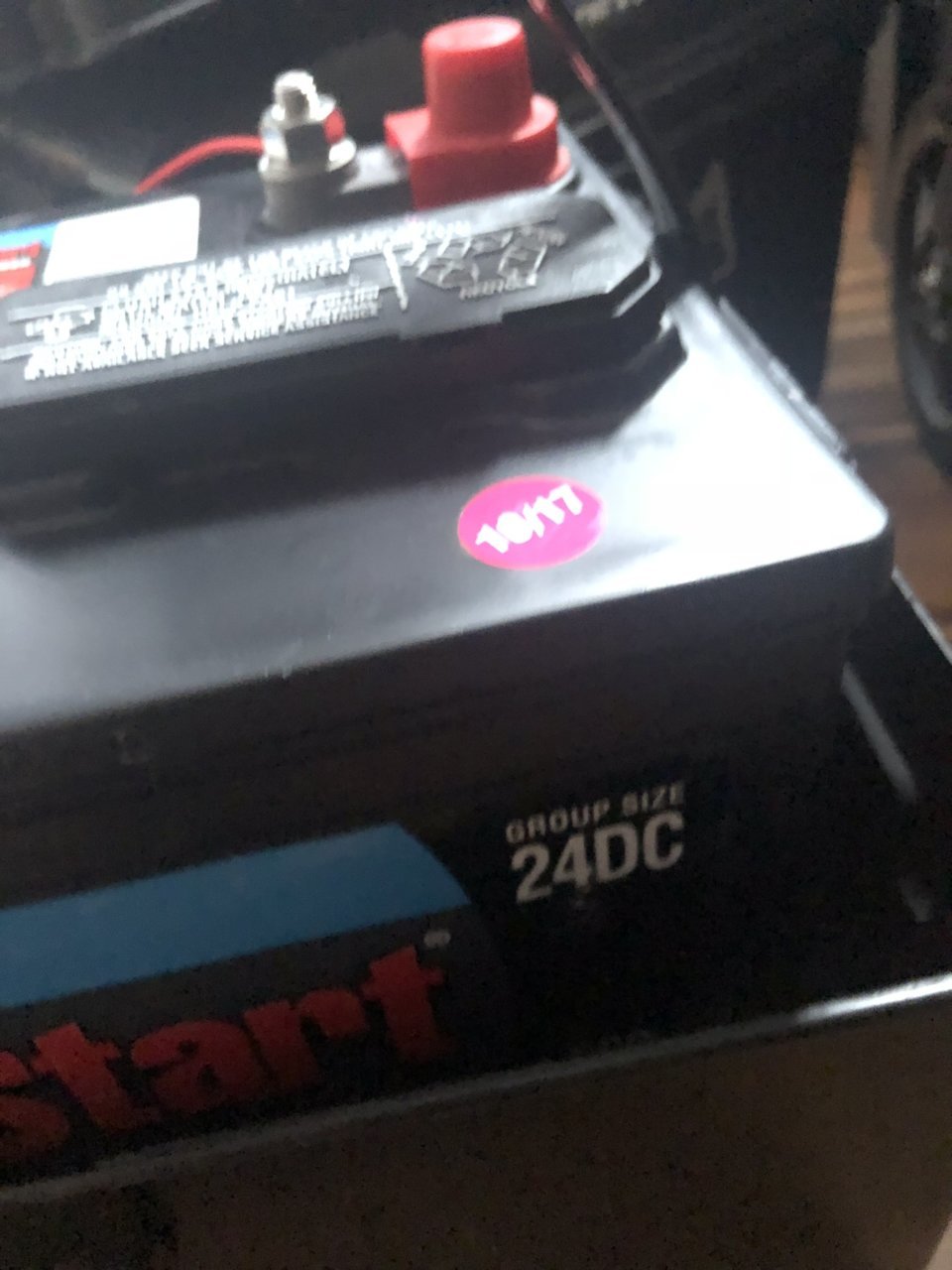

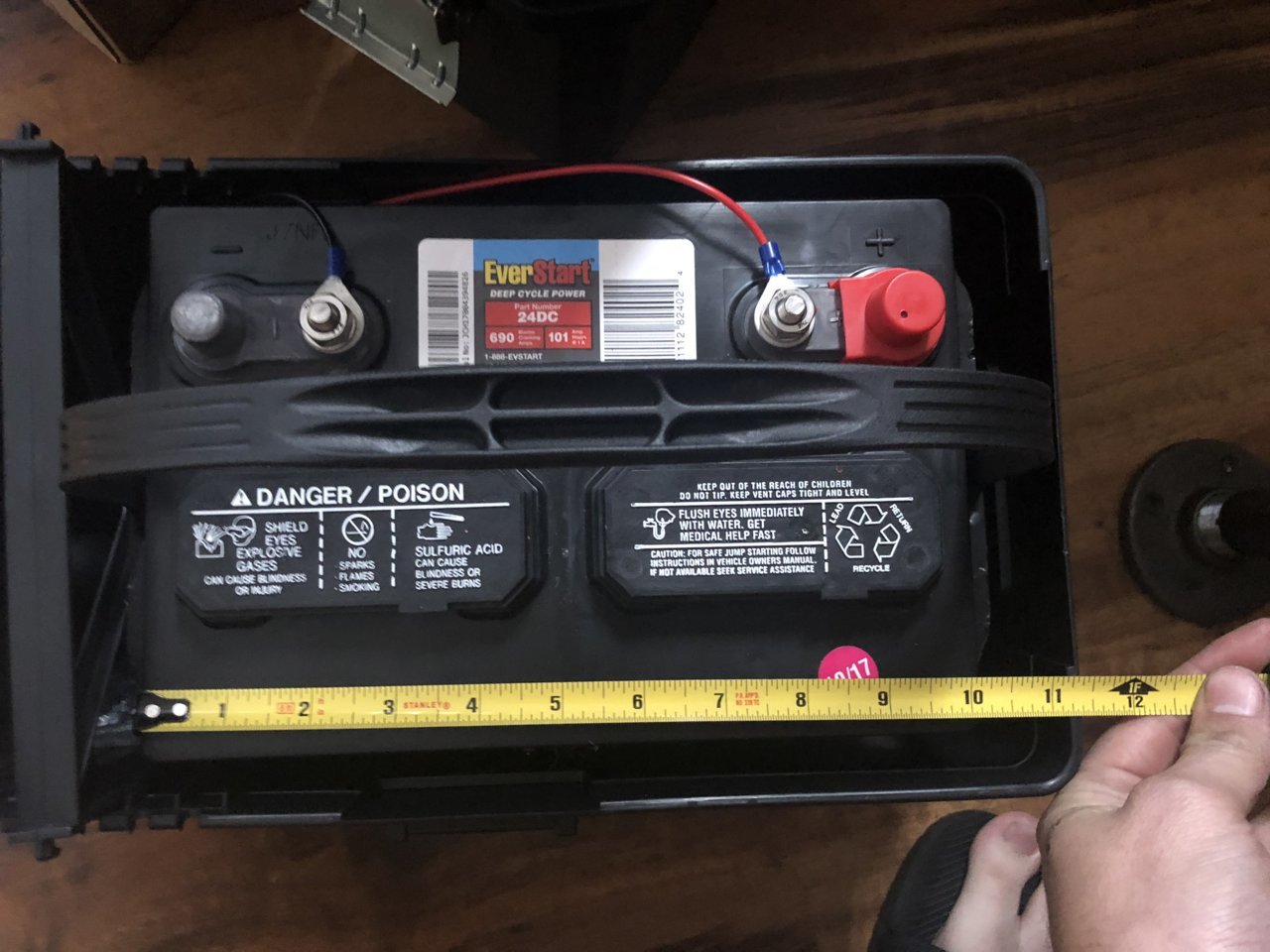

    @2ayne what brand & model Group 24 battery is rated at 101 aH? 24's are usually only 75 aH.

    Mine has the tow package. That’s what’s in my 2016 OR Access Cab.

    @2ayne As I suspected that 101 ah is misleading. Its stated as 101ah at 1 Hr and not the standard at 20 Hr. Utilization of the 1 Hr rate is a way for the company to over inflate the aH to make the battery appear better than it is to the unsupectiing.
    The way I understand the difference between a battery 100ah rate at a 1 hour rate, and a 100ah hour battery rated at a 20 hour rate, is (if I understand it right) is that a battery rated at the 20 hour rate will deliver lower amperage over a longer time. It is also possible that the 20 hour rated battery can't deliver 100 amps for 12 mins (80% of 60 mins) but will deliver 5 amp for 20 hours. The 1 hour rated battery might be able to deliver 100 amps for 12 mins, but not 5 amp for 20 hours.
    I suspect that battery is in the 50-65 aH range @ 20 Hr

    That’s some good info right there. Thank you @perkj! I originally just bought the battery to build in a box with usb chargers, 12v socket and an on/off switch to test things at home light LEDs and things before I installed them and basically just to play with.

    Northstar makes a 24f that will fit without modification that is dual purpose (starting and deep cycle) that will provide a ton of cranking power and comperable Ah capacity compared to the larger Optima 31. Odyssey makes a 34r dual purpose that fits and is rated at 68Ah, great battery but expensive. Your Everstart battery is fine as an accessory battery, it's rated at 65Ah @20hr and if it's in good shape should comfortably deliver about 400-500watts per full charge. Take a look at the wattage of the devices you want to run and multiply by hours of use. is it below 500 watts? Way more? You can also bring a volt meter along and make sure your starting battery stays above 12.1v at rest (50% state of charge) and you should have no problem starting. Too many options and sky's the limit on how much you can spend, just need enough
