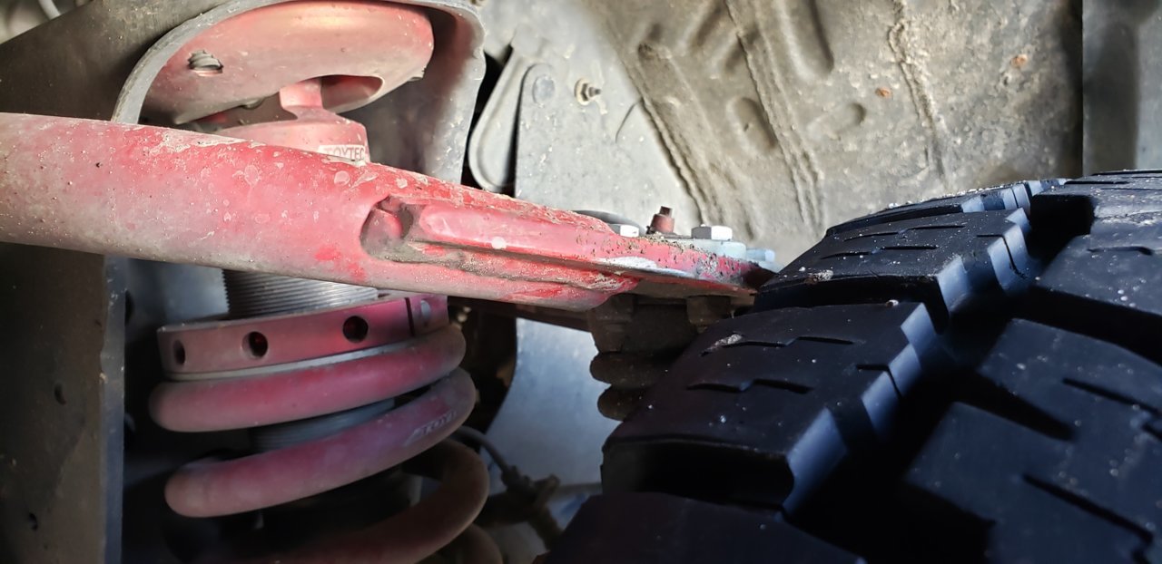

    If your alignment is good, I am willing to bet wheel offset is the issue. If those are stock wheels without a spacer, you're way too close to the UCA. 0 offset wheels will fix all or most of the rubbing.

    Thank you!!
