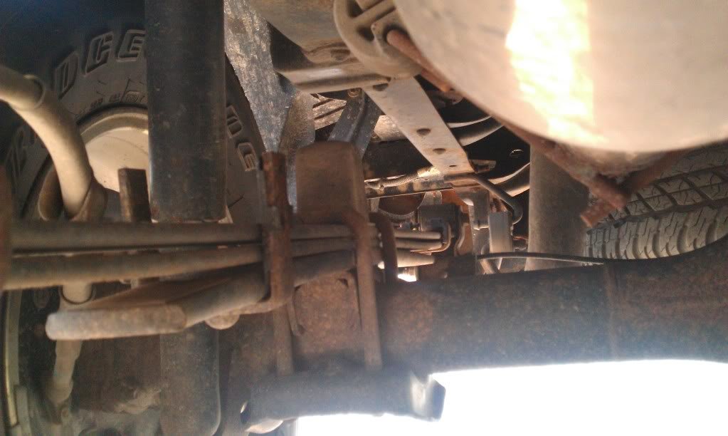

    With an empty bed, the springs appear to be flattened out, almost to the point where they seem to be almost bowing upward in the middle, opposite of how most leaf springs look on other trucks. I'm no suspension expert by any means, but it just doesn't look right, and I've never rode in any other Tacoma besides mine so I can't really compare the ride. I would rather wait for the lift, but I do haul my boat often during the summer time, and I just want to make sure that these current springs will hold up for the next year or so, and not cause damage to anything else in the mean time

    Those springs are sagging quite a bit. Mine are like that with about 200lbs in the bed and I want to get mine done. Along with a front lift of course. Are the TSB leaves prone to squeaking?

    Take it in with a load. It shouldn't be based on ride height, should be on load capability. Would help if you know how much weight you actually have in there to compare to the load rating. Make sure you point out the shiny spots where the bump stops are contacting the frame.

    There are definitely signs of the bump stops coming in contact with each other, let a lone the sad sagging springs. I have the platinum extended warranty and have been told by 2 seperate representatives at Toyota Financial Services that if, in fact, there is "mechanical failure", the suspension is covered and will be replaced under warranty. However, they told me that mechanical failure is based off of the ride height specs. My truck has 60,000 miles on it, so the dealer is being a pain in the ass about it. The truck is in the shop this morning, so I'm just waiting on a call to see what they say.
