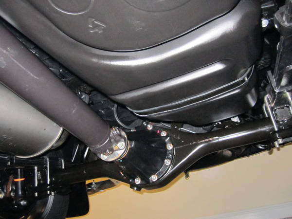

  3. Dec 20, 2013 at 3:30 PM
    #23
    Tuck91
    Tuck91 [OP] Well-Known Member
    Nov 28, 2013
    #117502
    183
    2014 Toyota Tacoma Regular Cab 4x4
    So I ended up applying some WD-40 Rust & Corrosion Inhibitor Protection. Picked up a can at Walmart for $13.50. Its a clear waxy like substance , smells pretty good two. States it protects for a total of one year from salt & water. Im guessing this is of similarity to the fluid film? It took me a total of 45 minutes to apply it underneath and lightly wipe off some excess spots.
    Ill try and post some pics tonight.

  6. Dec 20, 2013 at 8:19 PM
    #26
    Tuck91
    Nov 28, 2013
    #117502
    183
    Heres after I applied the Rust Inhibitor Protection. Like I said earlier, its a waxy film like substance.
  7. Dec 20, 2013 at 8:32 PM
    #27
    OZ-T
    OZ-T I hate my neighbour
    Dec 15, 2009
    #27584
    50,578
    Peter North
    British Columbia
    Has that truck ever moved ?
  8. Dec 20, 2013 at 8:39 PM
    #28
    Tuck91
    Nov 28, 2013
    #117502
    183
    Inches of what exactly? Sry.
    Yeah. It has 350 miles. Been driven in light rain only once. This is not my dd so I am hoping to keep it thus way. Also want to see how long the inhibitor holds up.
