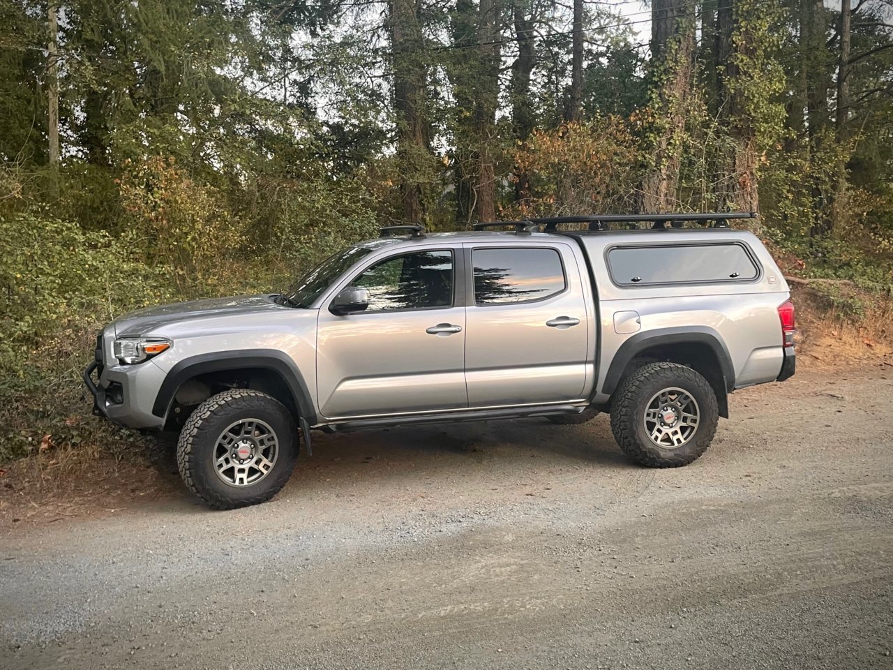

    I have no rubbing at all with 275/70/17. The key point is to have the right wheels with the right offset. The 4Runner SEMA wheels are narrow, so they have the effect of keeping the tire narrow was well. 275/70/17 are an approved tire on a 7” wide rim so it’s all good.
    For whatever reason there is slight variation in Tacoma frames and alignment specs. If you do rub, it will be minimal and easily ignored, with the 7” wide wheels.
    Good information to be found here:
    https://www.tacomaworld.com/threads/official-3rd-gen-275-70r17-tire-thread.394460/
    My truck on 275’s and 4Runner wheels. Note I still have my factory mudflaps.
