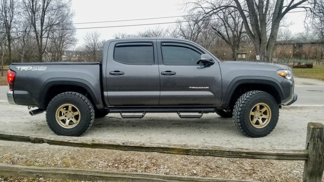

  8. Jan 15, 2019 at 11:49 AM
    #28
    x2akimbo
    x2akimbo Well-Known Member
    Jul 18, 2018
    #259822
    127
    Chicago
    '18 MGM Tacoma TRD OR MT
    This is without anything else but 5100s in the front at the 3rd notch and stock coils. No AAL.
    dre5491[QUOTED] likes this.
