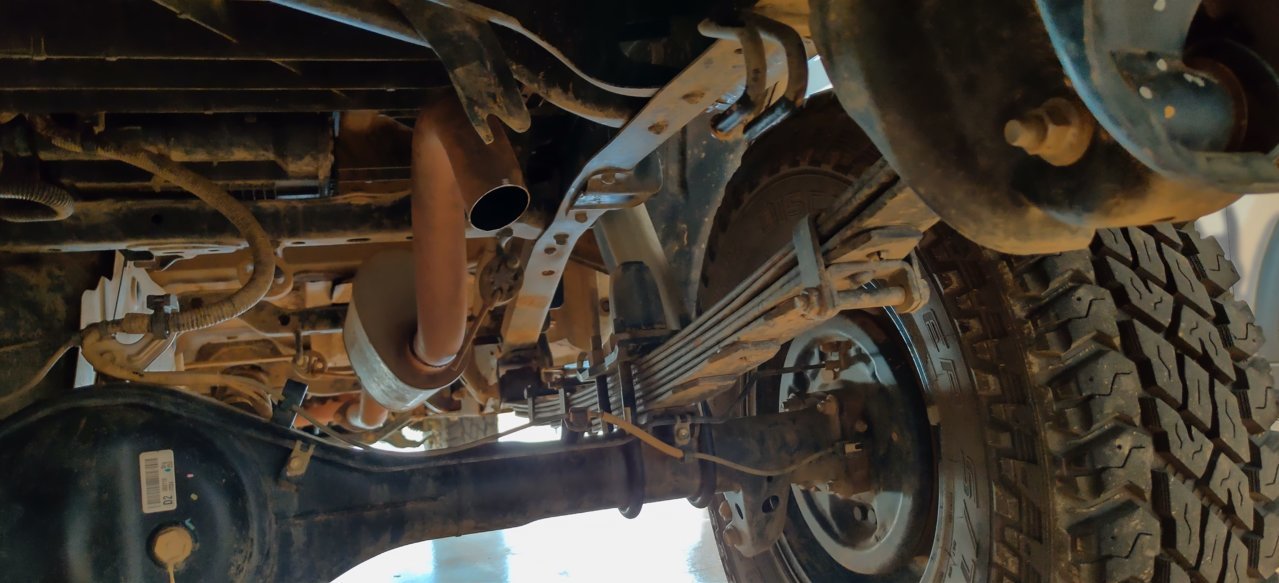

    ive been thinking about dumping the exhaust in front of the rear wheel and then making one of these that i can bolt on

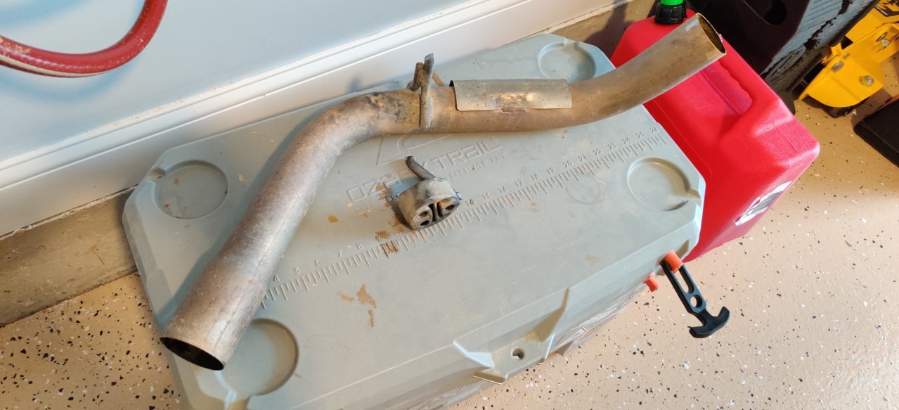

    Do it, no downsides.
    I have a magnaflow welded in and it sounds less raspy after chopping the exhaust. It centralizes the sound which is nice and I get more of the intake as well.
    Sawzall for 30 sec then lube the rubber hanger and yank that bish off
