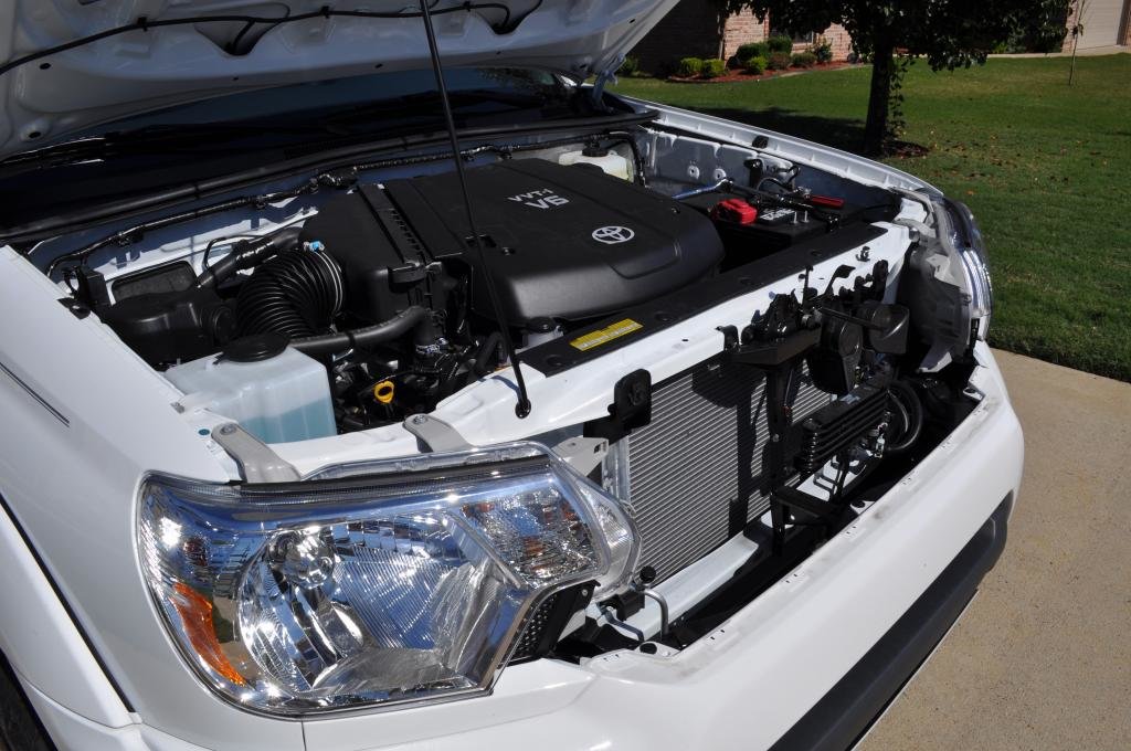

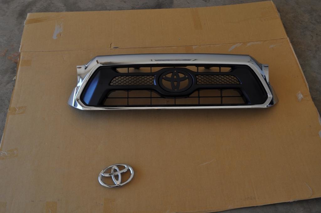

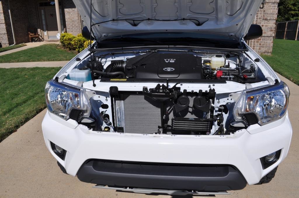

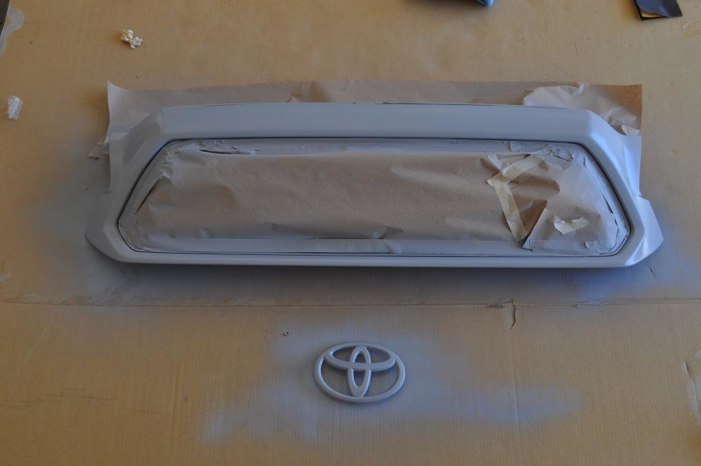

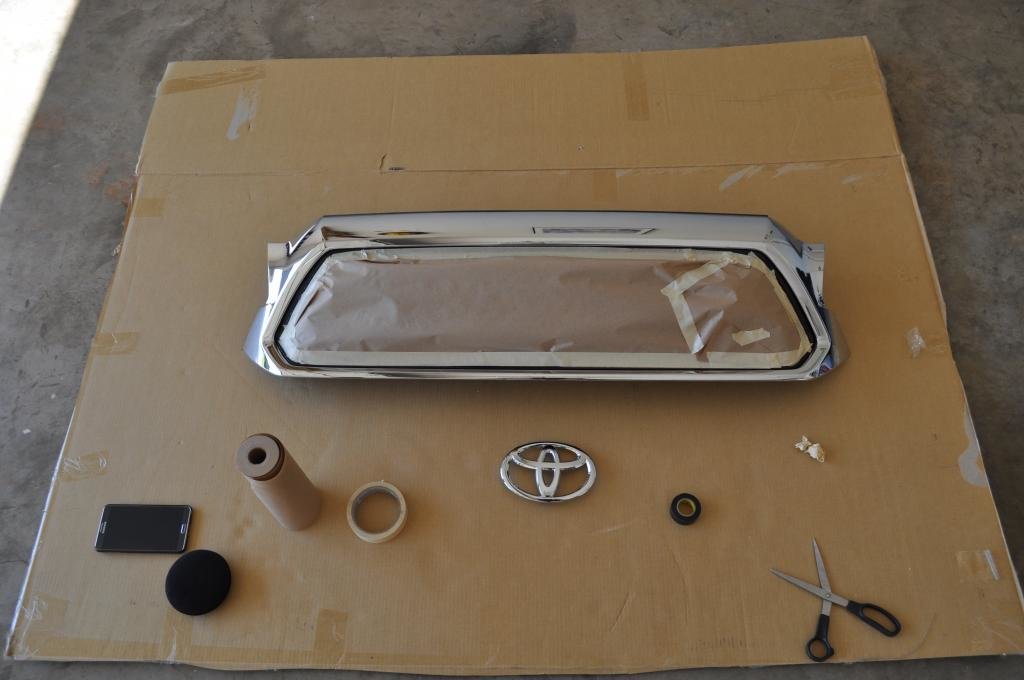

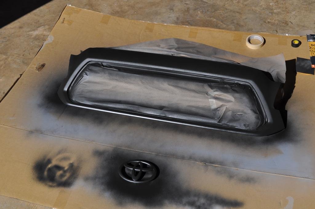

    Here is what I did with mine. Assuming you want it to be permanent then this works out nicely.
    Removed Grill from truck
    Taped off the grill but in the end I painted the entire grill. Sanded the chrome then the entire grill in the end.
    Self Etching Primer sanded
    4 Coats of Matte Black Stripe paint like used on classic cars. Painted the entire grill in the end.
    Finished product
    I did Plasti-Dip my emblems though

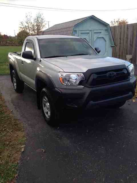

    Go for it. Also consider doing the lower valence at the same time. Here's mine:

    Looks good with the valance done as well. I just got a black satoshi and I was gonna change the color to SSM but I kinda like how it matches my dipped valance

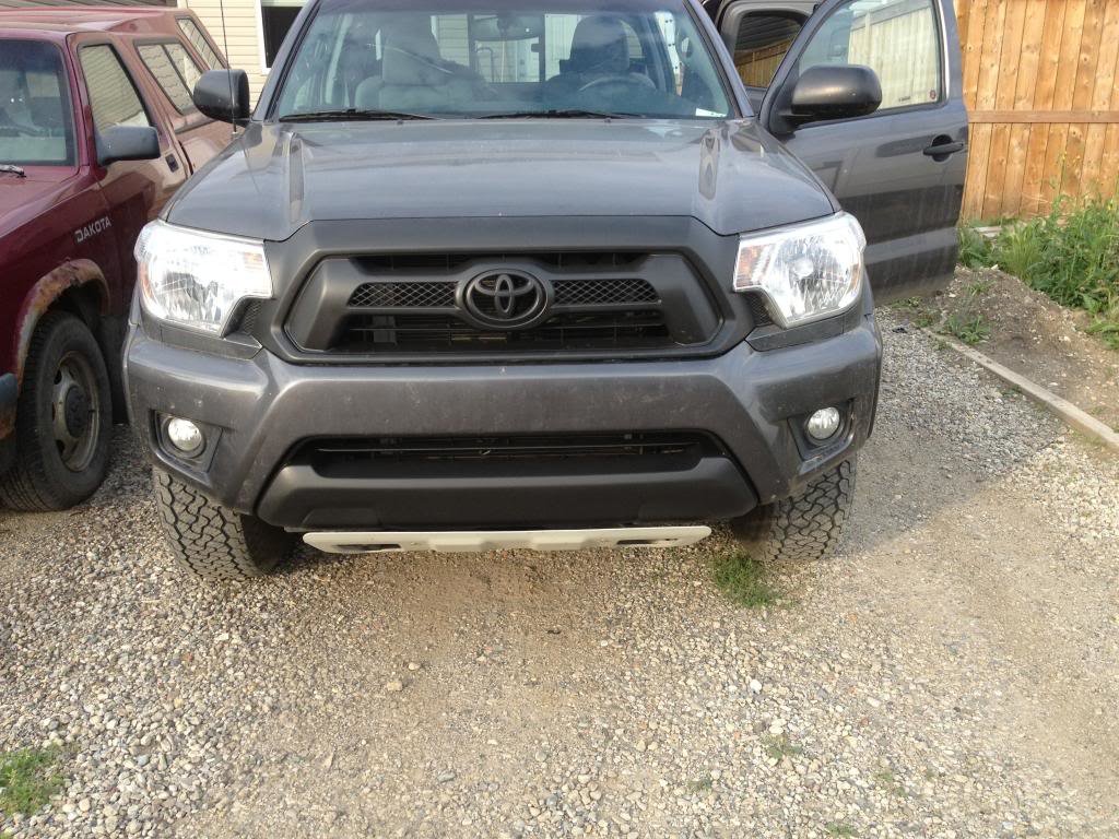

    Plasti dipped.
    GrillampValanceBlack-Installed_zps3893c5_142cb560c7e69d513301fa1acf1e1ad17e71ba33.jpg

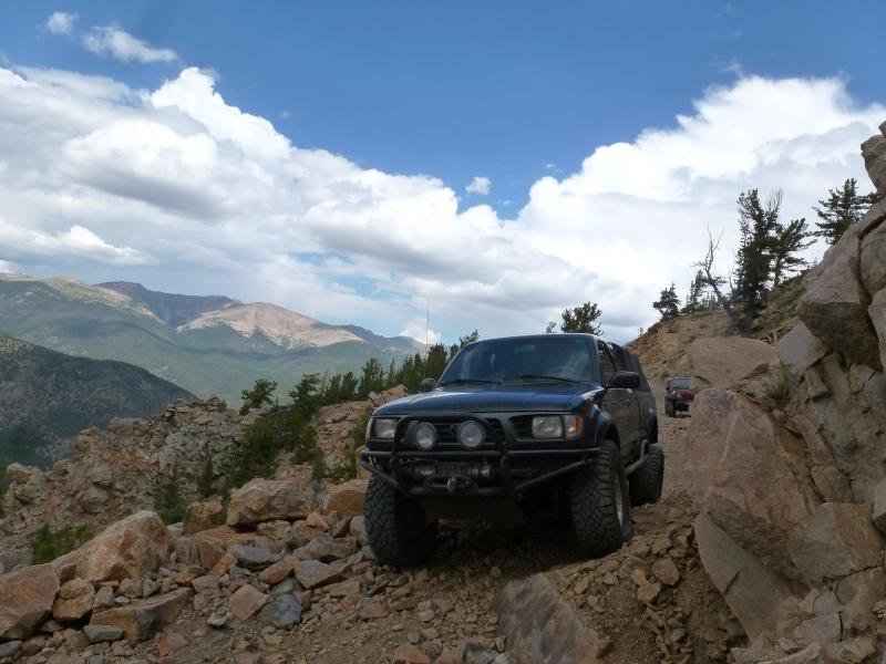

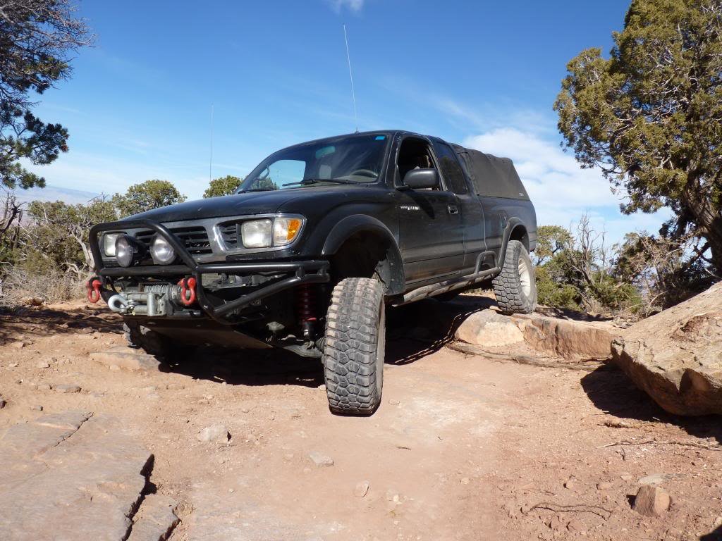

    I know, I'm a first gen but I plasti dipped my grill in anthracite and it has held up great.
    Went from this:
    To this:

    I put 10 coats on my emblems and waited about 30 mins between coats. After the last coat I pulled the Plasti-Dip off the paint at about 10 mins while it was still soft so it wouldn't pull the Dip off the emblems. 4 coats isn't nearly enough to last. If you plan on leaving it look at my post above for a more permanent solution.
