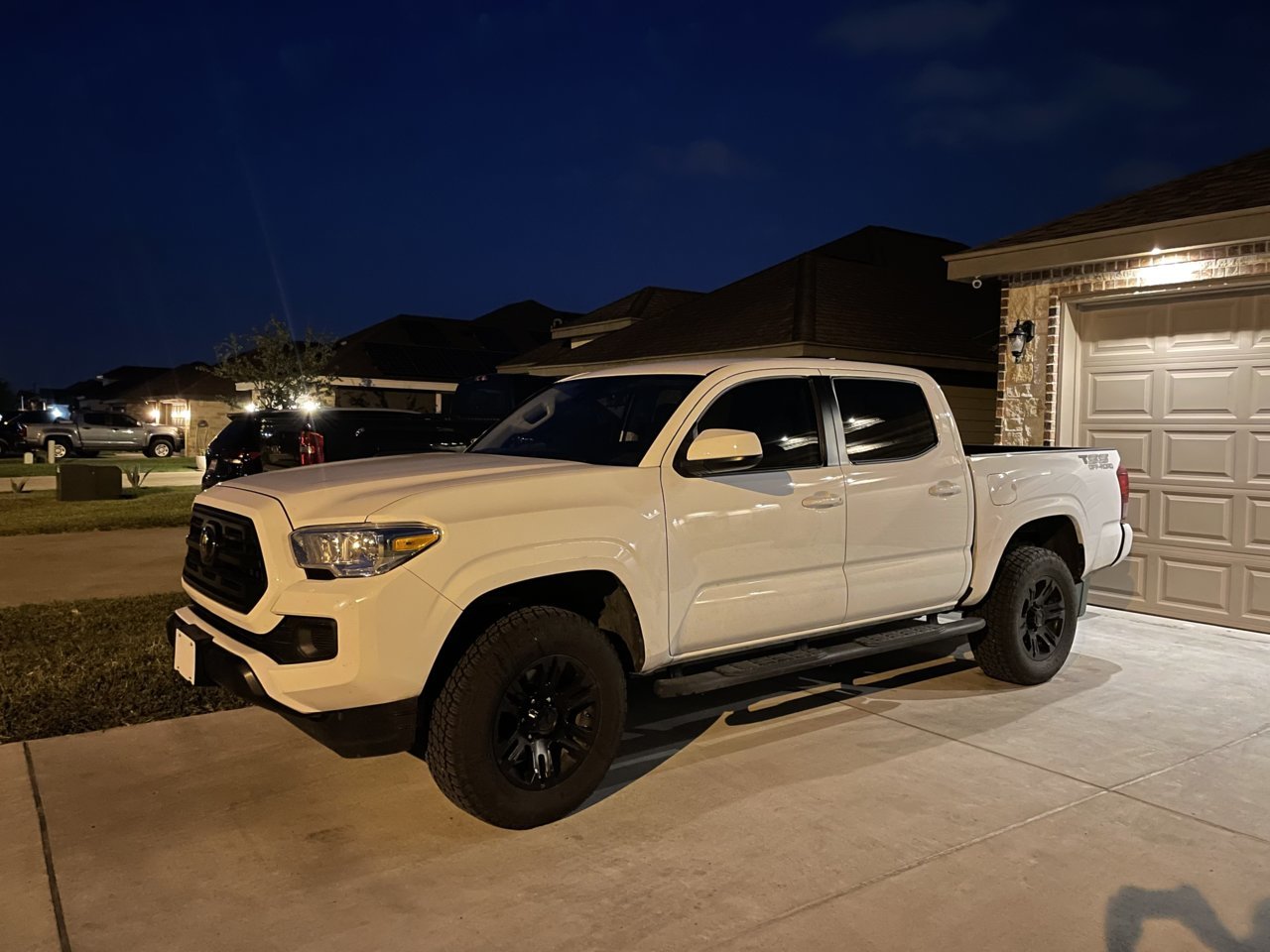

    Just picked up a 2019 TSS 2WD 4 cylinder Tacoma.
    I use it for work always on the highway and some back roads in ranch areas every once and a while. I plan to keep it on 30” wheels and not add much weight to it probably keep it pretty stock.
    From what I understand the 4 cylinders come with a 4.30 ratio rear diff. I was wondering if I would see any noticeable performance improvements re gearing to a 4.88?
    I have a local shop that can do the job for $800.
    Anyone have experience with the same situation I’m in or any opinions?
