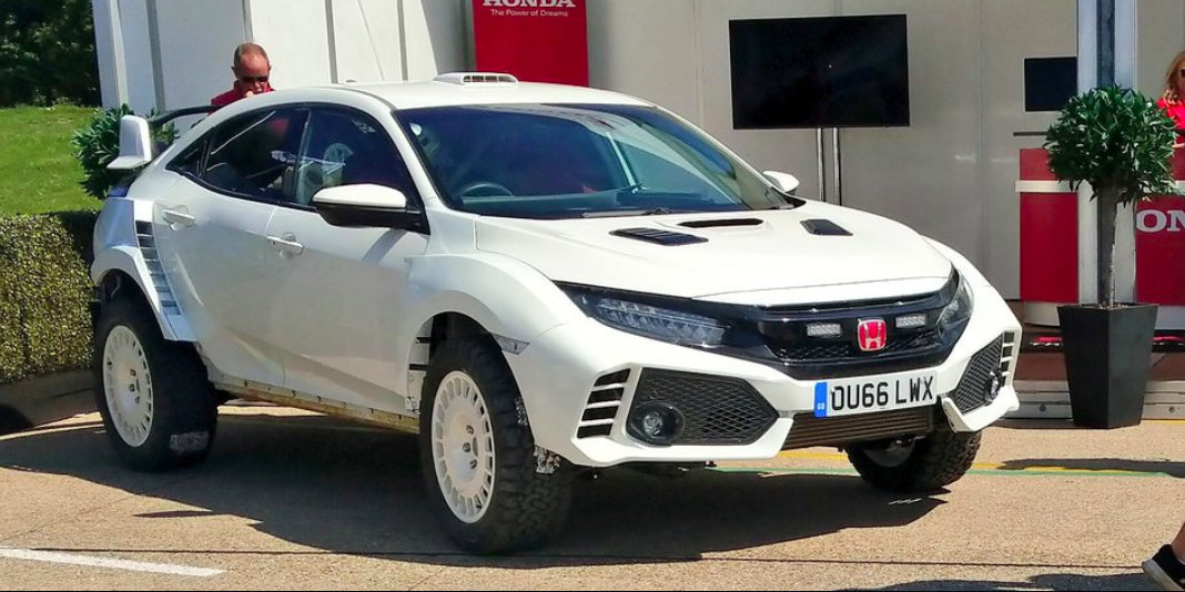

    yeah I was just use to that zippy little Honda now with this truck it’s no that I’m not happy because honestly I still have my civic but it hasn’t been used since I got the truck other than once and I did enjoy the quickness but hated how low it was now that I was use to being so high up. It also does give my business a good look. Being in Texas you kinda grow up loving trucks bbqs guns and low taxes lol so it kinda just makes sense for me lol

    yo
    SwollenGoat[QUOTED] likes this.
