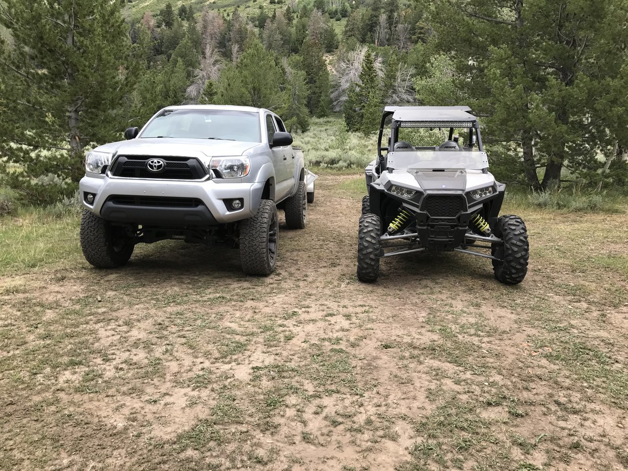

    I’m on stock gearing turning 35s with a 6 inch lift kit and I also have a side x side I tow on a 6x10 trailer. Only difference is mine is an automatic.
