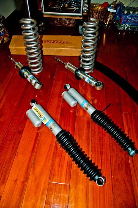

    Just get this.
    5100's
    5150's
    Toytec AAL
    Eibach springs

    and how much is that set up? and is anything else needed? like diff drop? sway bar relocators, bushings?

    I payed $754 shipped from Toytec I got everything Diff drop and Bushings
    I do have a 1st gen so I'm sure the price is different with the 2nd gen's

    From what Ive read YES the Eibach springs are longer so there is less of a pre-load on the shock.
