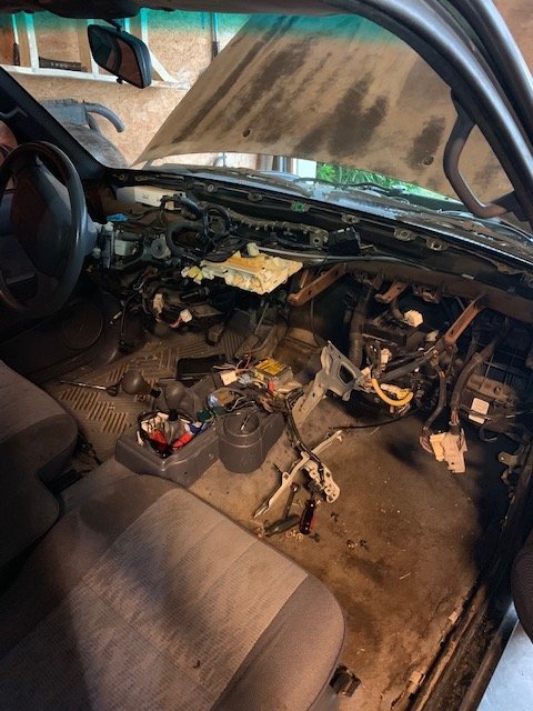

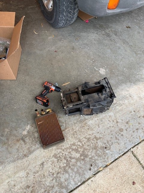

    DO NOT REPLACE FOR NO REASON! I just replaced the heater core in my 98 Tacoma today and it was a real MFer! I had the engine replaced by some shade tree mechanics back in 2015. While trying to get the hoses loose, they cracked the heater core where the tubing enters the core. I have had it bypassed for several years, but I have recently been reviving the old truck and decided to change it. It took me every bit of 8 hours of diligent work. You will have no reason to be that far into your dash unless your core is leaking or stopped up. Toyota started with the heater core and built the rest of the truck around it!tacoma.jpg tacoma 1.jpg

    Does replacing the Evaporator require a complete dash removal like we see in the picture or can it be done by removing and working behind the glove box?

    I don’t know for sure, but I would guess you have to pull the entire dash. The heater core is inside the assembly box pictured in my original reply. That box is behind the radio. The evaporator is behind the glove box, but it is connected in line with the heater core box and all of the ventilation. It might be possible to get to it without removing the entire dash, but it’s still going to be a job!
