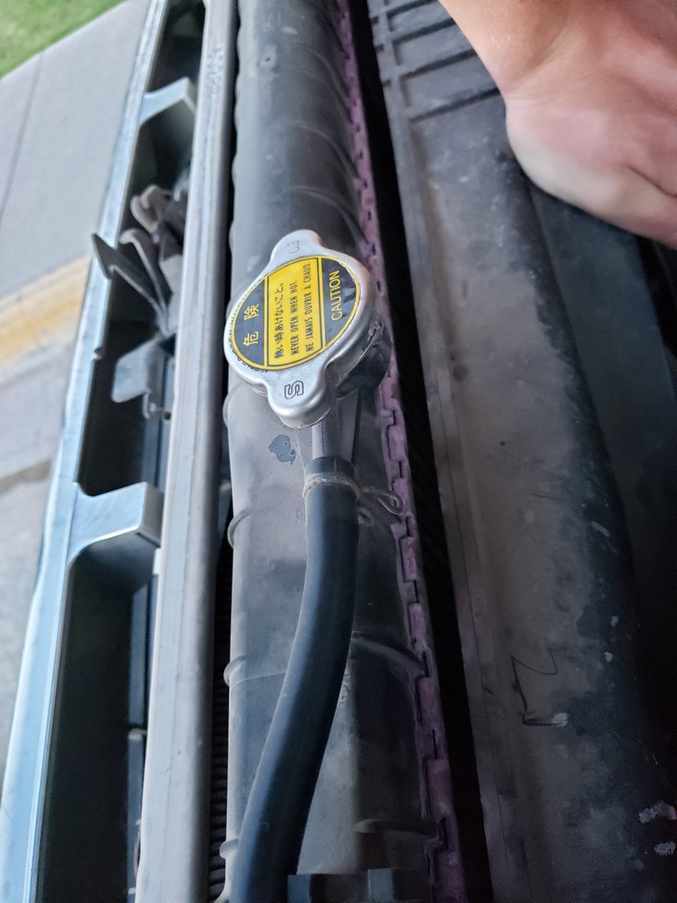

    Hey all, I'm assuming I have a crack in my radiator but wanted to get some opinions from here. It doesnt leak constantly and I'm not overheating. There is a small amount of coolant in my overflow tank still and I only notice it every now and then (mostly after it has ran and it's been parked for a short time. Any info would be helpful. Thanks a bunch !

    You can get insurance on them huh? Havent seem that offered but I'm just looking to order online somewhere. Also, do I need the exact size or will any work ? I think there are 3 different sizes but apparently they all fit my truck it says

    Check your cap first, make sure it's got a good seal and the coolant overflow hose. otherwise, Its the seal between the top tank and the core, it's going to fail eventually on you. maybe not now, but always at the most inconvenient time, right?
    Also, your cooling system is supposedly a sealed system. if coolant is getting out, air could be getting in. only small amounts now, but what about down the road? the seal could gradually allow more coolant out or air in, causing larger air pockets to get in or evem cavitate and overheat. or on some random hot ass day, completly fail on you.

    Where is it leaking from? There are lots of places coolant can leak from. Just throwing parts at it isn't the most efficient way of finding fixing a problem.

    Or you could pressure test the cap and the cooling system. You can pick up a cooling system pressure tester for approx. $60 new, or half that used (E-Bay). Obviously a coolant leak is not good. If the system leaks it is not able to pressurize. When you pressurize coolant you raise the boiling point. This is a good thing. Test (or have tested) your system before purchasing parts to fix it.

    So I’m confused. You say there is a “small amount of coolant in the overflow still”. Are you thinking you should have more or none? There is suppose to be some to the low line when cold and top line or past when hot. I would replace the cap ($15) after doing a check on the hoses and heater core. Are you getting fluid on the interior floor? While possible there is a higher probability of a leaking hose or fitting. Good luck.

    There are no leaks in the system anywhere . I got a pressure test done. Just leaking at the top of the radiator and no other signs of coolant anywhere else

    if it passed a pressure test, that's great. clean off that coolant, check/replace the cap and hose and see if the coolant reappears after driving it for a while at operating temp. who knows, it could be old from a top off or a little leak from the cap.

    No leaks in hoses, etc just the actual radiator itself

    It could be that pressure tests don't exactly reproduce conditions while actually running.
    heat it up to 170-220 degrees, everything expands, and it may start leaking only then, while running.
    or like i said before it could be old from the last top off.:notsure:

    have you had it in the shop recently? My truck was at the shop a few weeks ago and when i drove it home and parked it there was all kinds of steam coming from the engine compartment. I've never had any issues with this before so I was a bit surprised to see coolant all over the top of the radiator just like in your picture. I called the shop and asked them if they had topped it off and they did and must have spilled some in the process.
    I cleaned it off and it hasn't come back.
