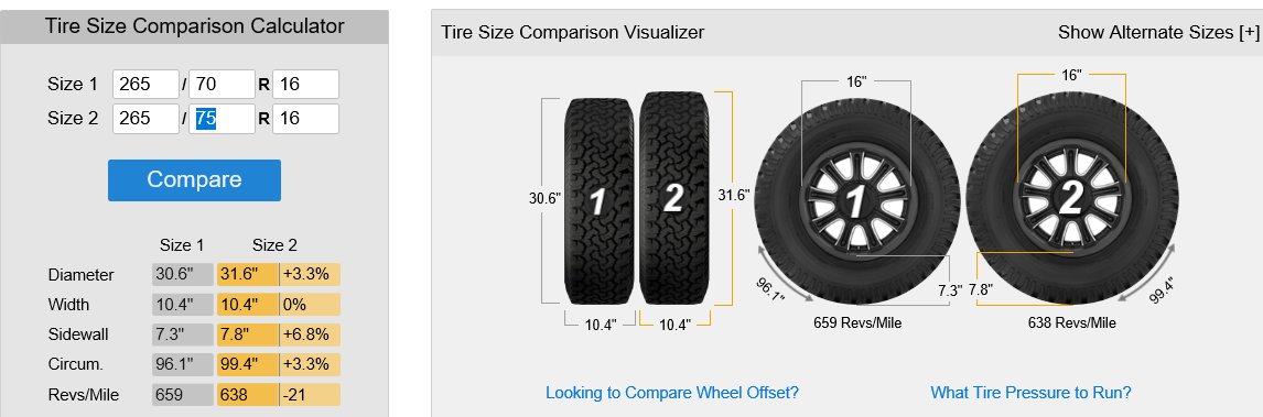

    just go back to a stock size 265/70/16 Michelin defender

    265 is a 31 inch. I thought stock size was 30.5?

    265/75 is 31

    The first number is you’re width in mm.. the second is your aspect ratio. So you’re sidewall on a 265/75/16 is 75% of you’re tread width.
