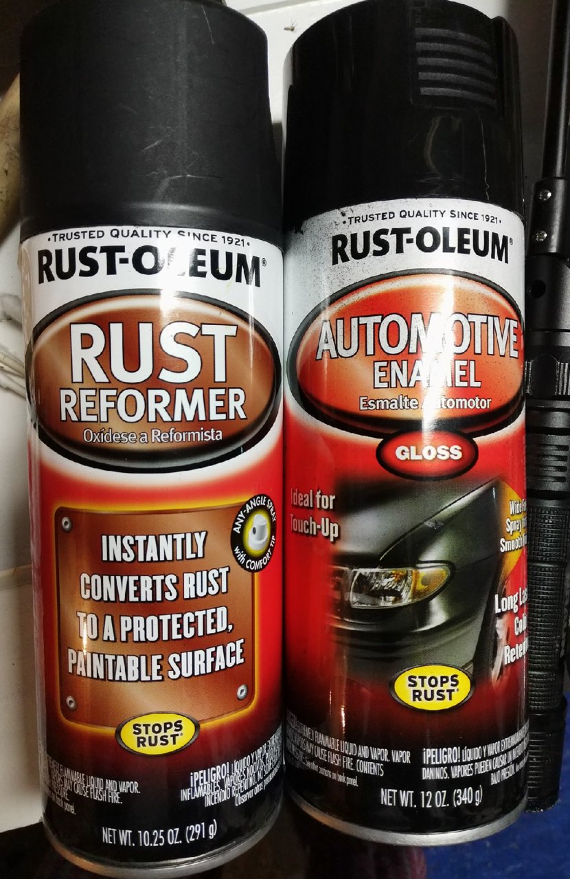

    When I rebuilt my axle almost a year ago, i sanded rust off, light sanded the rest, then put a coat of Rust Reformer, let dry for 24hrs, then Enamle, let dry for 24hrs.
    Year later, still going strong! (Some discoloration from bleeding brake fluid onto it , but for sure no rust or chips)
