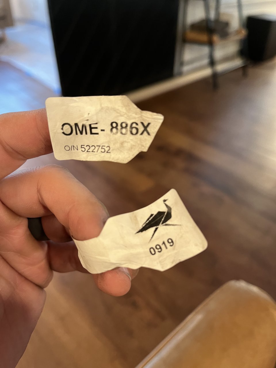

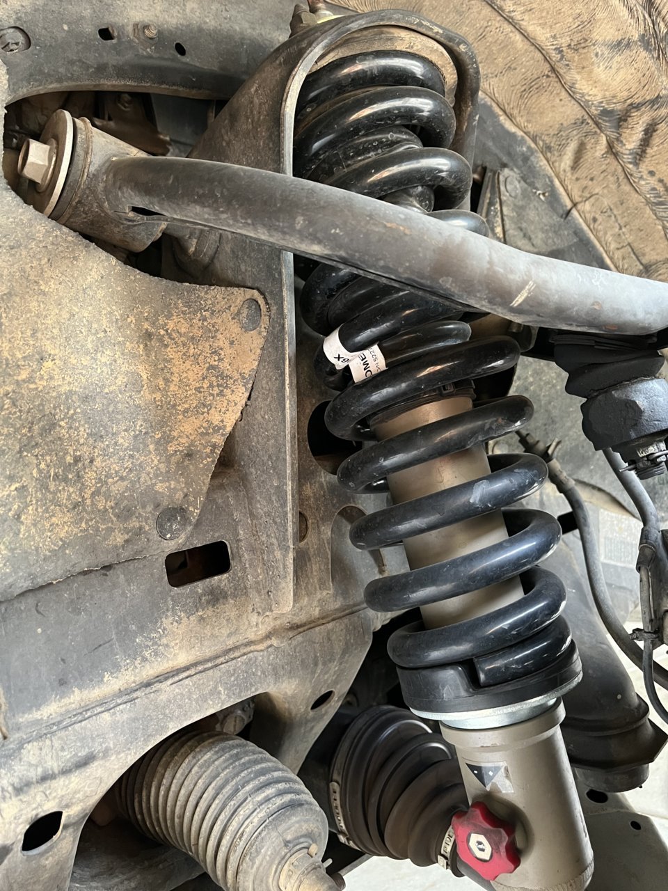

    takaiguchi
    takaiguchi [OP] Member
    Mar 24, 2022
    #393385
    6
    C45C4443-4358-4929-A64C-95F794E466FB.jpg F88012E4-0926-4E61-A07C-178885B48B62.jpg F88012E4-0926-4E61-A07C-178885B48B62.jpg C45C4443-4358-4929-A64C-95F794E466FB.jpg OK. Here’s a picture of my front suspension. They look like old man emu 886X Springs but I have no idea what the shock is.
