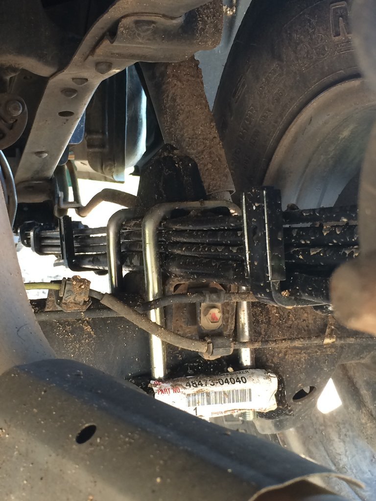

    I have a gen 2 but I believe the new tacos are still using the 3+1 leaf pack. I went from having the 2+1 pack with some positive arch on the springs. Then after I got the spring recall done and they switched it for the 3+1's, I noticed they were frowning from the day i got it back from the recall. Here is a pic of the new springs the day i got it back(this pic is the truck fully unloaded and prior to my shell)..
    Edited to add, i now have firestone ride rites and it eliminated the sagging
    RIDERED67[OP] and Unchained 5150 like this.

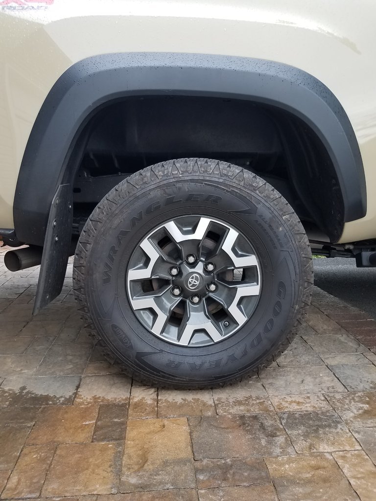

    #17
    RIDERED67
    RIDERED67 [OP] Well-Known Member
    Oct 22, 2016
    #200382
    2,327
    2017 TRD OFFROAD QUICKSAND, DCLB, TECH
