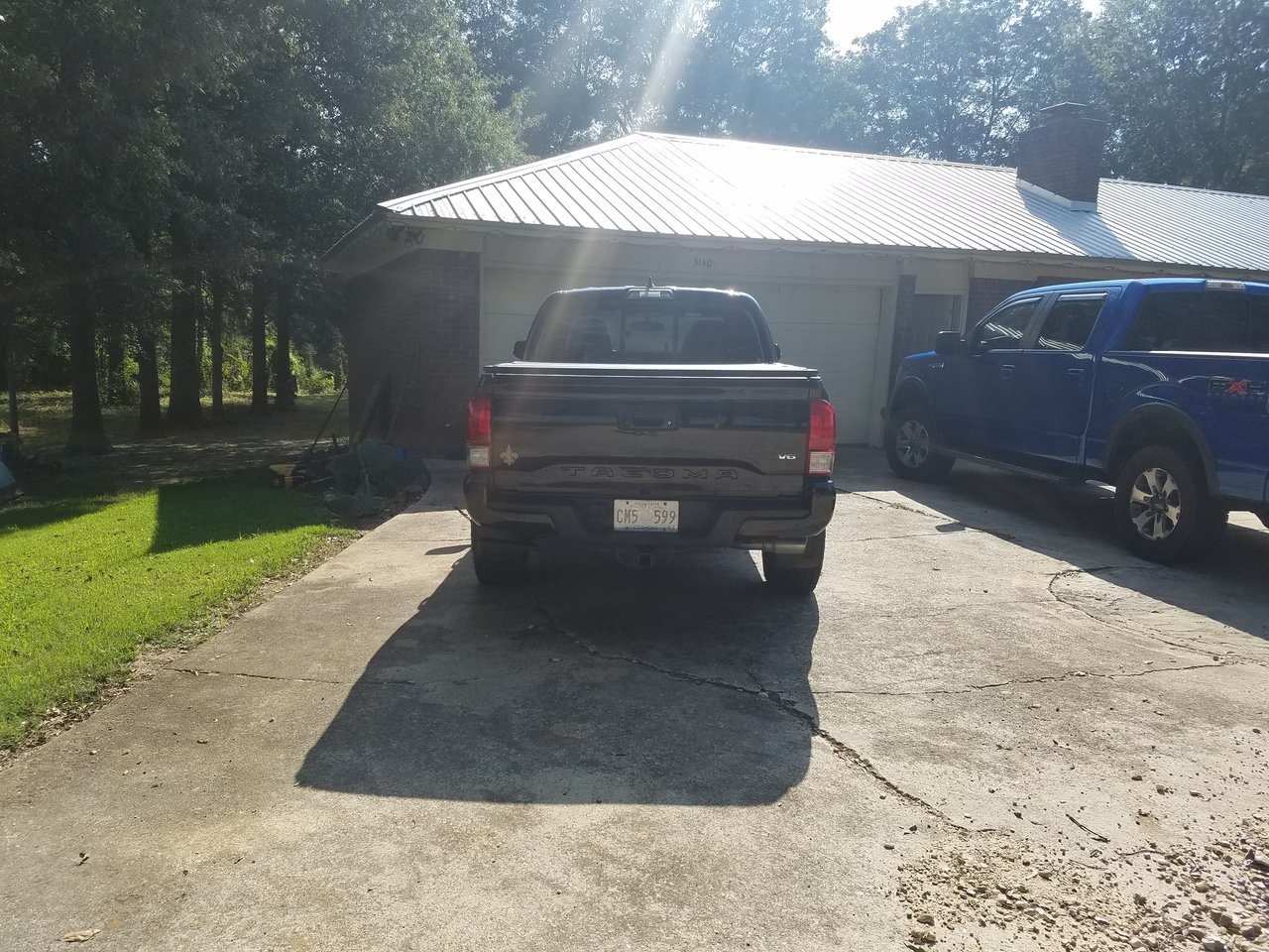

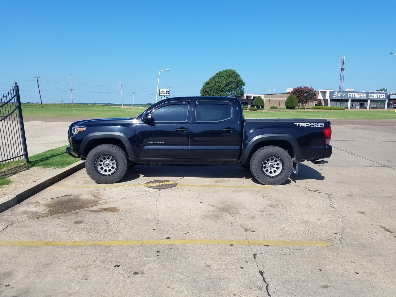

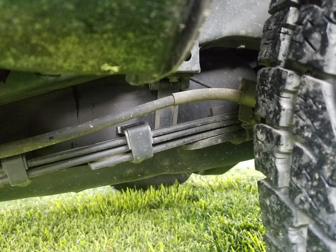

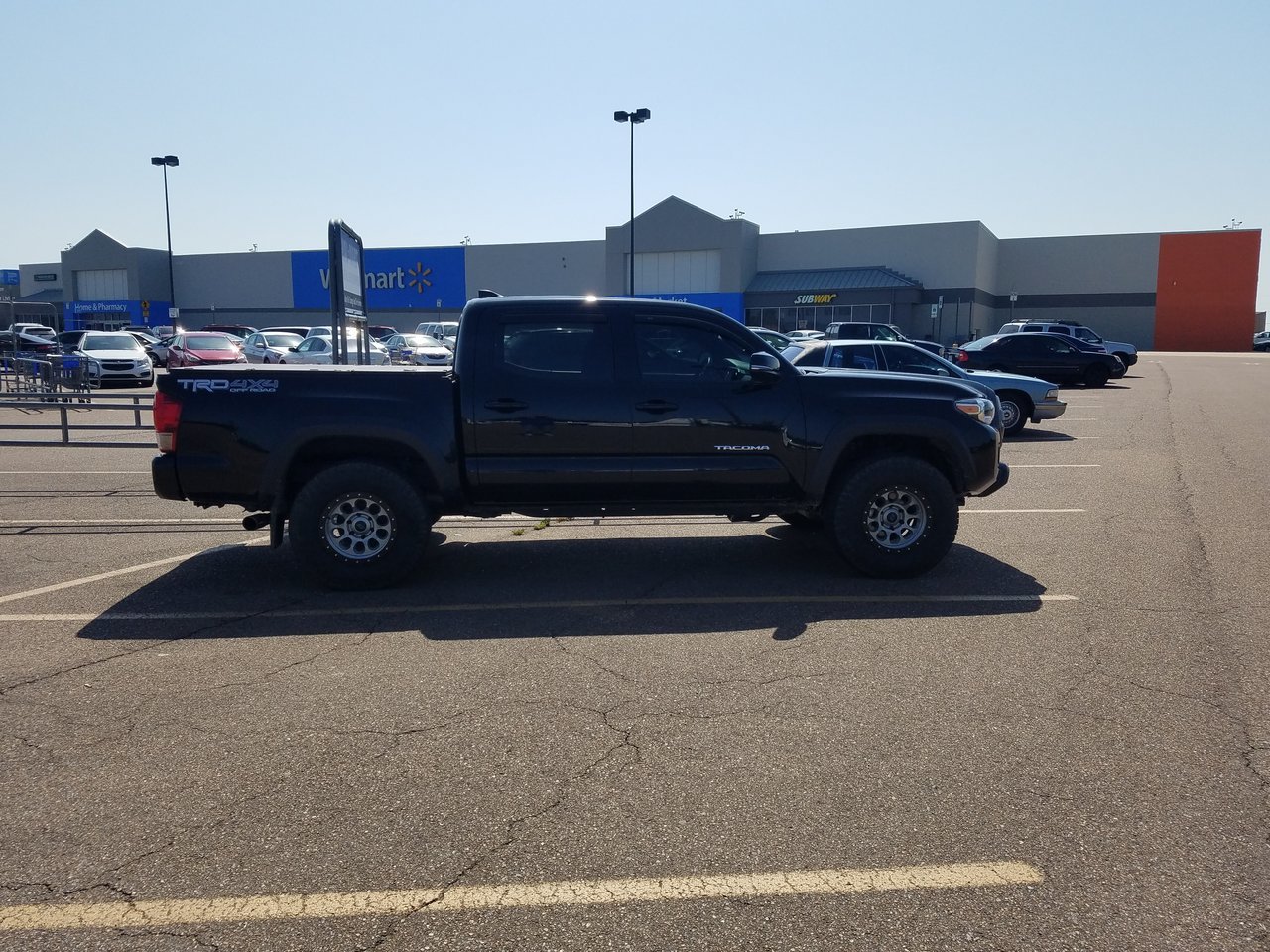

    I am having the same problem with my truck. It is getting worse by the day. I went by my dealership and the SA agrees with me that it is not normal. He is getting me some new springs under warranty. I am not to confident that the replacments they put on will be any better. Suspension is stock with no major loads ever put on it in 17k miles.
    Truck has absolutely no rake left. If anything I have Cali lean going on with the taco lean I already had. I would be on the bumpstops with 350lbs in the bed. Ridiculous.

    EW! this is unloaded or do you have 300-400lbs of sandbags hiding in the bed...? sidebar, are those 285s on stock suspension

    They were soft on the older trucks, too. Although I don't remember my stock '91 springs ever being in recurve like my Taco.
    The stock '08 springs did a negative arch but I got it used at 42K miles. The recall springs they put on were better but I replaced them with OME after a couple of thousand.
    Does Toyota still offer TSB springs for people who complain about this?

    Yes unloaded. Never really had any major weight in the truck. Moved a couch once. About 75lbs of recovery gear and tools lives back there.
    No man they are just 265s.

    not normal... toyota has replaced my leaf packs and shocks x2 both sides due to flat or inverted springs...

    your truck is under waranty just let the dealer put on new leafs, if they fail they have to replace them again under warranty until your warranty expires which is 1 year from installation -or- 3 years 36000 miles from purchase unless you have the extended warranty.
    PS it is it failing more on one side than the other? If it is not a weight in bed issue an rather a failed leaf then this would be the case, however leaf springs are usually made in large batches and if the leafs are failing like you say most likely there are others with the same problem and the metal used to create the leafs is bad and a recall would have to happen for all trucks using the leafs of the same manufacturing batch. I am interested to see where and how this goes because of the whole 2nd generation 2+1 --> 3+1 leaf spring event.
