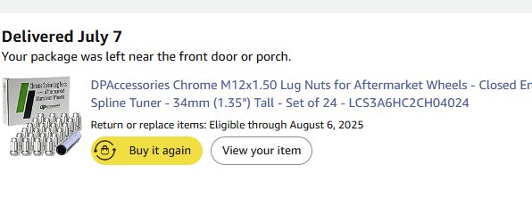

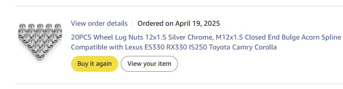

    i got american racing wheels, getting installed w lift next week
    i checked my wheels and holes are narrow, i had to buy spline nuts like these
    i bought these too early and didnt realise they wouldnt fit...in fact i have full unopened bag of them if they are what you need, message me
