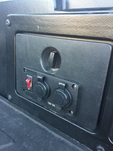

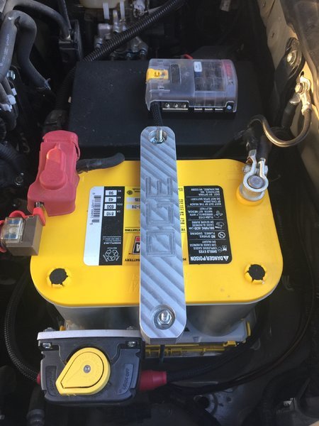

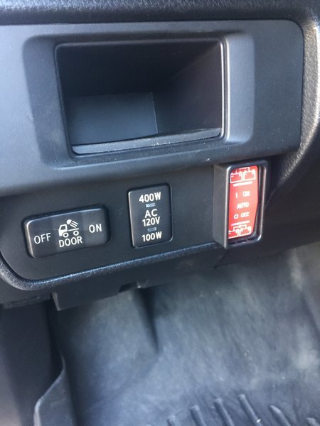

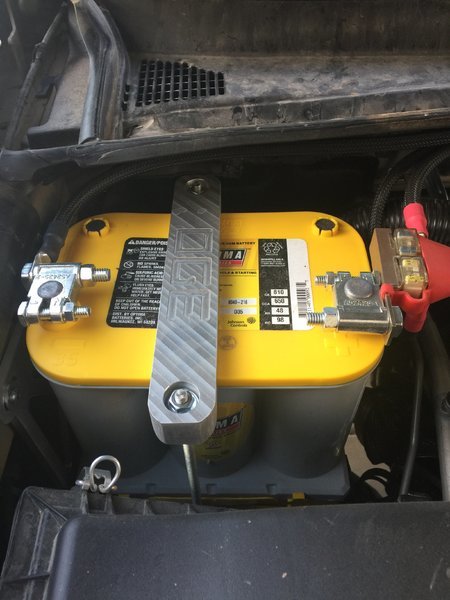

    4 quick pics. Primary battery, secondary, interior switch, power outlet in bed.
    I'll swap out the short door to the metal locking one once it arrives. Plus I had him add the Blue Sea 5025 six circuit fuse box, Dual MRBF (the double fuse on the auxiliary battery), 2 Machined aluminum OGE battery tie downs, andcustom 4 AWG cables for fuse box install.

    I need figure out where to put that red switch.

    How did you mount the 2nd battery? is there a custom mounting plate you installed near the firewall?

    @koditten Yes, the Blue Sea ML-ACR is a magnetic latching, dual voltage sensing, completely automatic, battery isolator/ relay. It does all the battery linking/ unlinking for you... but it also has manual override features for self jumpstarting and high amp load scenarios. These relays come standard and pre-wired in every full system I sell.
    @JoeCOVA You can order full systems and certain parts through my website www.************** I also offer custom setups upon request and I do installations at my place in Erie, CO
    @Me. Projekt Id love to help you out with your build whenever youre ready!
    @tacitos The second battery is mounted via our custom made auxiliary battery trays, available right here:
    https://www.**************/collections/battery-trays/products/battery-tray-for-toyota-tacoma
    We have quite a few on the shelf right now. Normally they are a 1-2 week wait.
