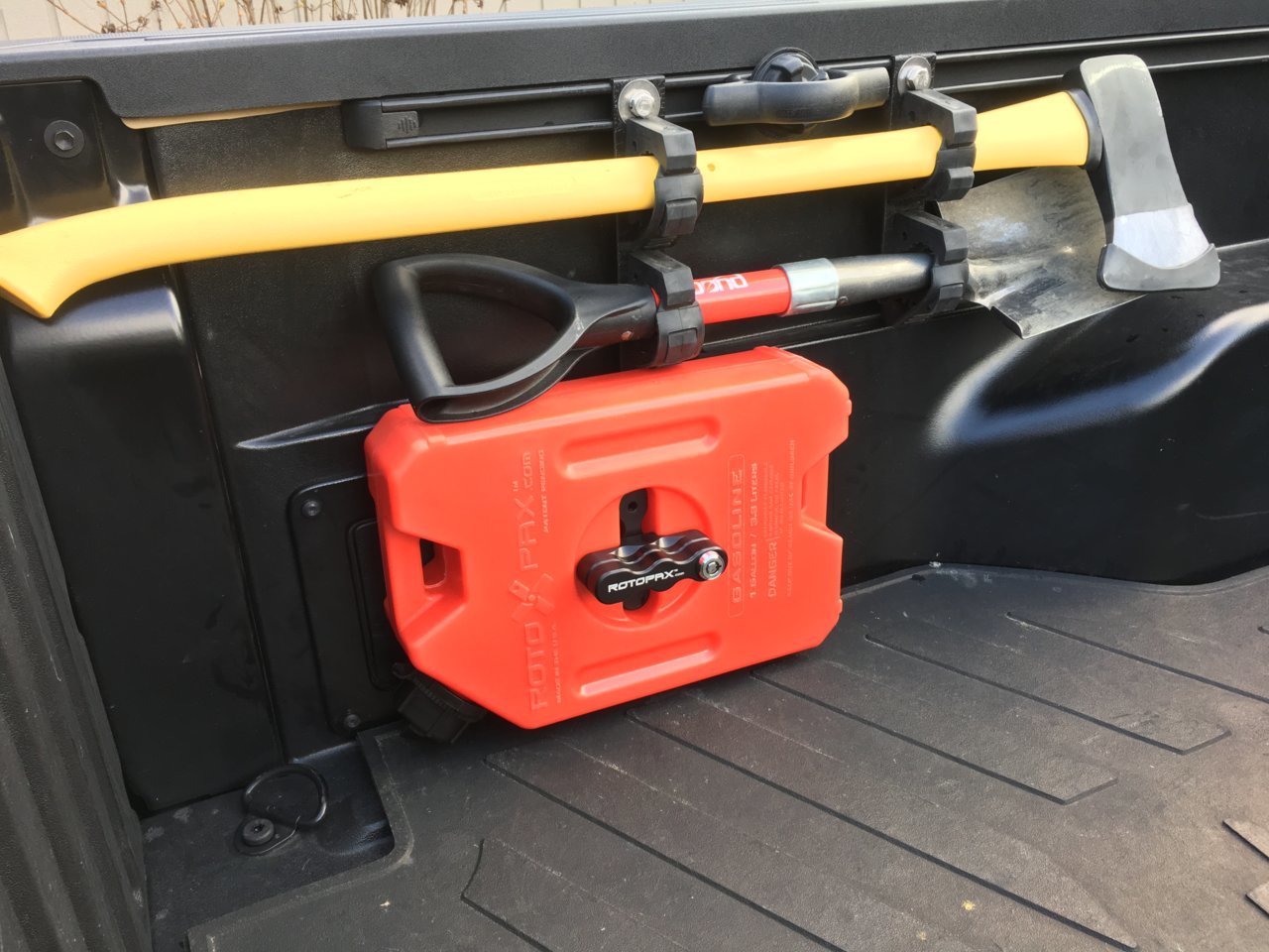

  6. Mar 26, 2018 at 10:11 PM
    Captqc
    Captqc Well-Known Member
    Mar 5, 2017
    #212458
    5,178
    Tigard, OR
    2017 Tacoma 4x4 TRD AC Off Road
    Like this?
    cesar_taco and michael roberts like this.
  7. Mar 26, 2018 at 10:12 PM
    brentw59
    brentw59 [OP] Well-Known Member
    Aug 11, 2009
    #20999
    246
    Brent
    Clovis CA
    2017 Tacoma 4x4 DCSB Manual Inferno
    Basic Shit. Floor Mats, Seat Covers
    Yes exactly like that. Did you make it? Buy it?

  9. Mar 26, 2018 at 10:18 PM
    Captqc
    Mar 5, 2017
    #212458
    5,178
    Tigard, OR
    The clamps are Quickfist, you can find them on Amazon. I made the mounts out of some steel strap material I had lying around my garage. I also bought the T nuts off Amazon to mount them to the bed rails.

  10. Mar 26, 2018 at 10:23 PM
    orangeracer
    orangeracer Well-Known Member
    Jun 18, 2016
    #189889
    645
    18' DCSB TRD OR 4x4 w/6spd MT
    Which rotopax Mount is that?

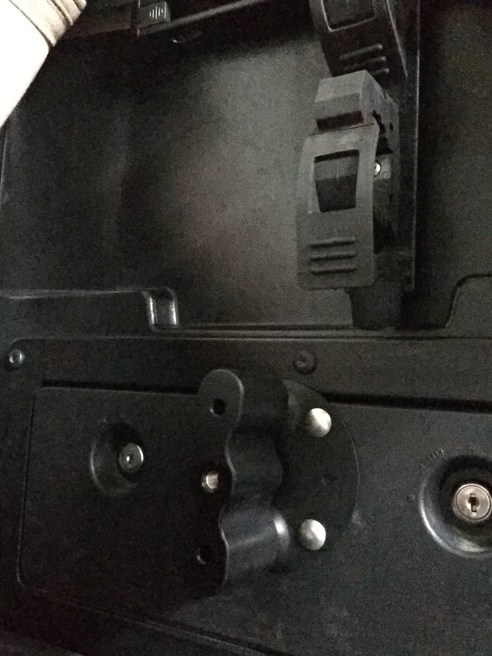

  11. Mar 26, 2018 at 10:28 PM
    cesar_taco
    cesar_taco Well-Known Member
    Aug 15, 2017
    #226888
    95
    Cesar
    2017 DCSB Off-Road Taco
    Ditto.
    OP, I reused some bedside bolts to thread through the quickfist rubber holes perfectly. But for the T Nuts (factory bed rail mounts) you'll need to use a drill bit to widen the rubber holes for the bolts to fit throigh (make sure your bolts are long enough for the quickfist clamp you use).

  13. Mar 26, 2018 at 10:32 PM
    Captqc
    Mar 5, 2017
    #212458
    5,178
    Tigard, OR
    I bought it second hand but I think it’s just their standard mount.
    orangeracer[QUOTED] likes this.
