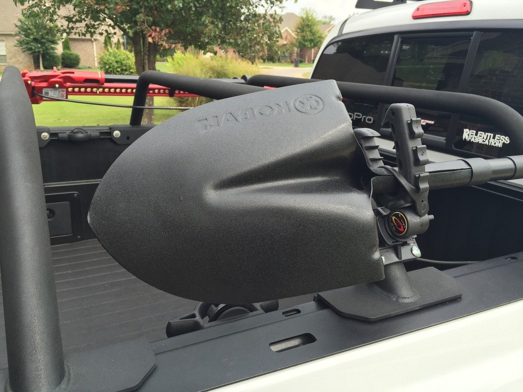

    Shouldn't rust since that Kobalt shovel is fiberglass and hot dip galvanized. :) Looks good though.

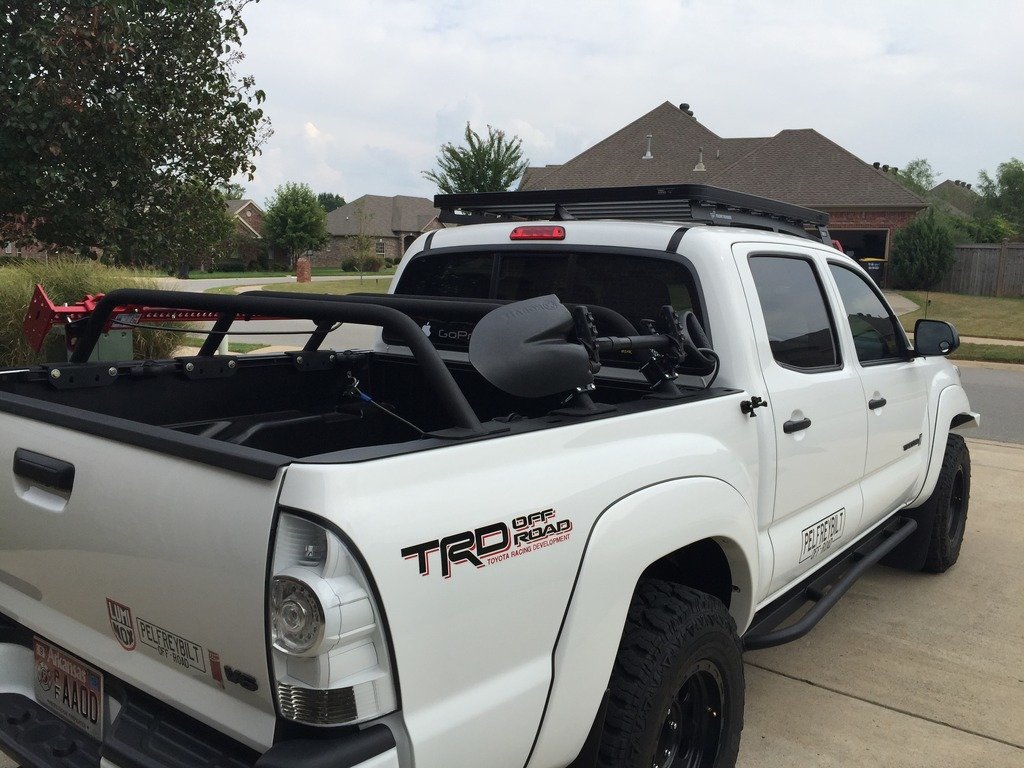

    It was already rusting in a couple of spots and I haven't even used it yet. The Speedliner is the same thing as Rhino Liner but with the option of spraying out of a HVLP gun so I can control the texture.

    It's a brand called Speedliner. Back when I was painting a buddy and I bought into the company to start painting truck beds. Ended up not doing it so I still had a lot left over. You can use a hopper gun to spray it or (what I like) a HVLP so I can control the texture. Once you mix it up you have about a hour to spray before it sets up on you. Stuff is extremely strong and "shouldn't" scratch with use. I sprayed my Sliders and Relentless Fab bed bars with it also. And no they don't make a rattle can version. The rattle can stuff you get at Autozone wouldn't hold up.

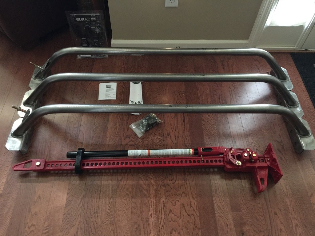

    How they come before painting

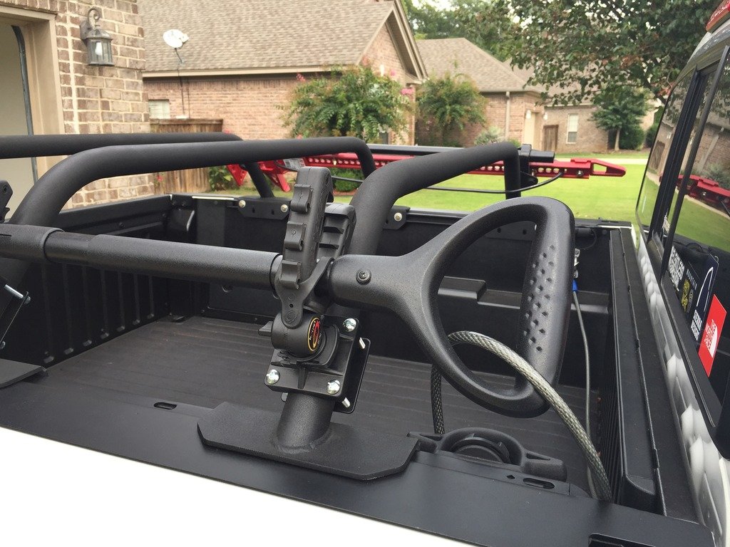

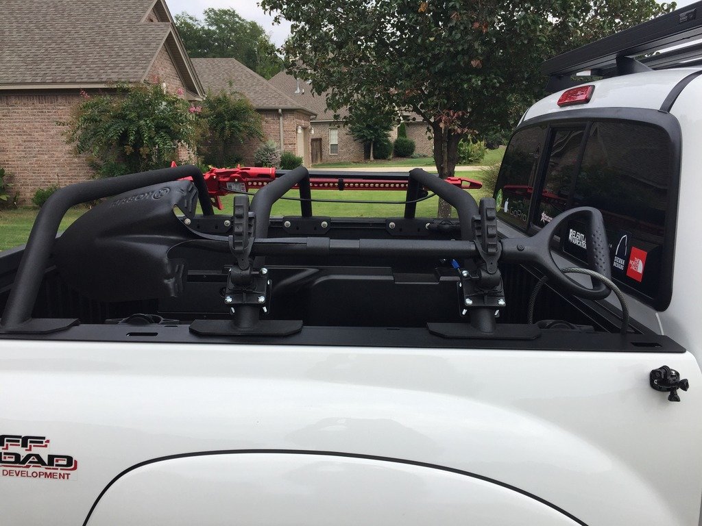

    Little better view of the setup.
    I "shouldn't" have to worry about about scratching or rusting. This shit is as strong as Rhino Liner
