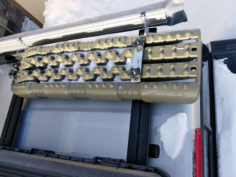

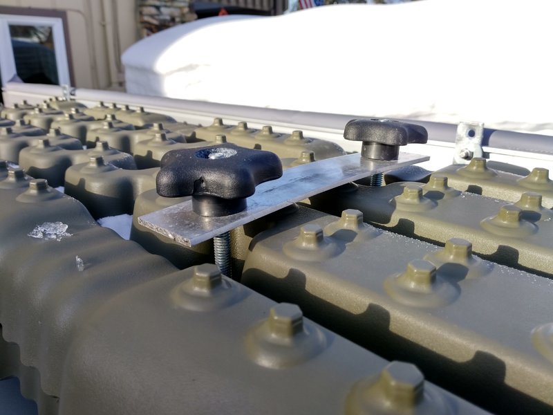

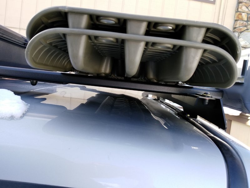

    Long bolts in T slots on the roof rack, nuts with plastic handles and aluminum bar cut to length and drilled that acts as a clamp on top. It's fairly slow to get them on/off but they are very secure up there.

    Right angle aluminum with the maxtrax mounts:IMG_6774.jpg
    You could use the same design (provided you have a roof rack) with long bolts, wide washers and some wing nuts.

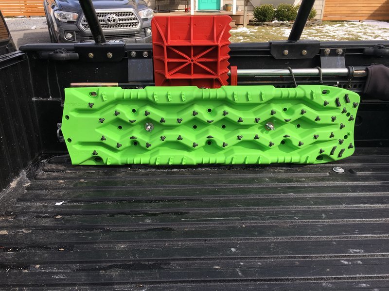

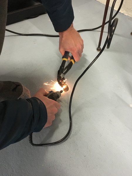

    4 1/2" washers (2 dremelled to fit over carriage bolts) 2 regular stainless steel washers for support on inner side of bed
    2 3x1/2" carriage bolts
    2 wing nuts
    2 1/2" lock nuts
    $17-
    I guess it's the cheapest way to hang. The bolts are super sturdy.
    Win

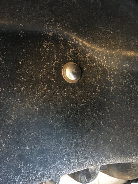

    I drilled through the composite Tacoma bed. Really wanted to utilize the bed rail also as most guys are doing. I figured worst case if I had to I could always fiberglass over the holes in the future if plans were to change. Didn't worry too much about dust proofing the bed because I don't plan on running a cap plus with the drain holes in the bed already figured what is two more in there.
    Picture from inside wheel well

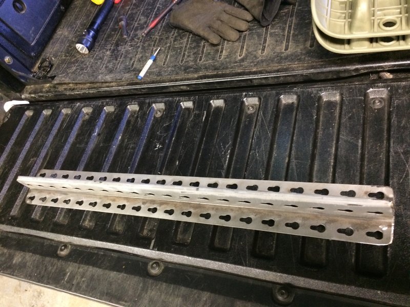

    I started off with a T-bar from industrial shelving. Used 2 T-nuts to mount it to the bed rail and placed the tie downs at each end as slide stops and tucked one end of the boards as shown in photo. As shown in a pic, the board rides in the middle slot, and rests on the wheel well. It will be held in place with 2/3 bungee cords but 1 will do for now until I get more of the length I need. image.jpgimage.jpgimage.jpgimage.jpgimage.jpg
