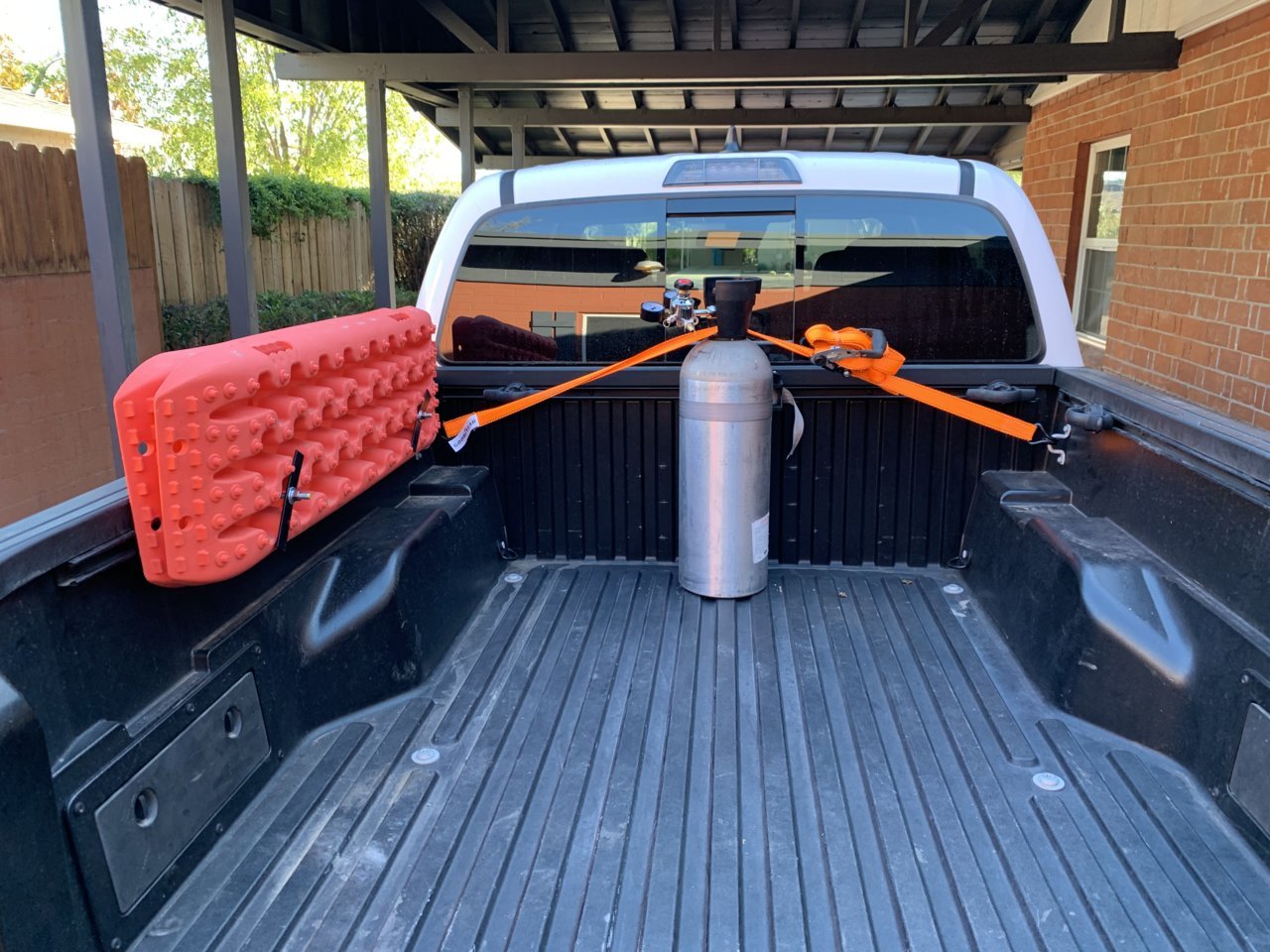

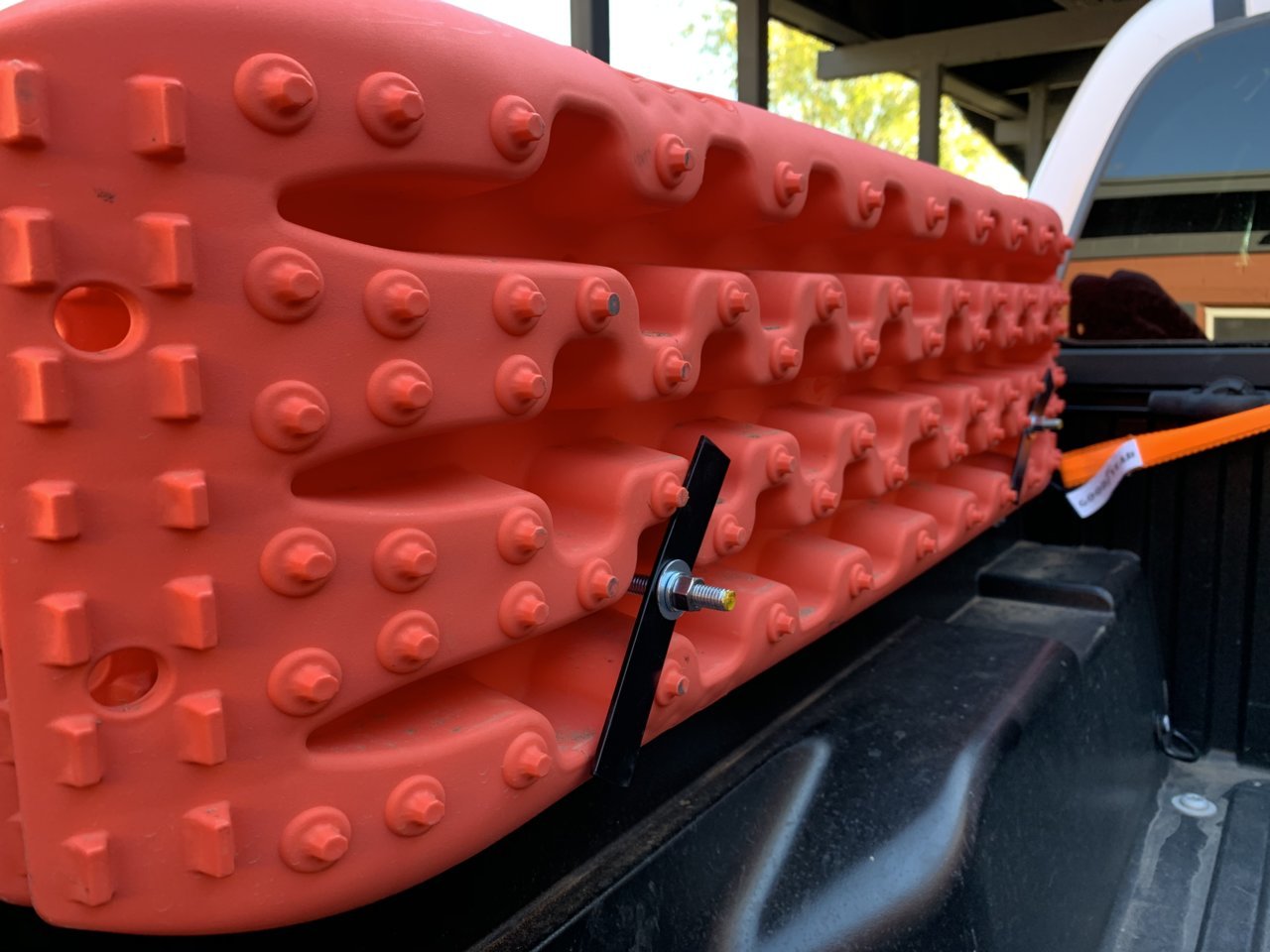

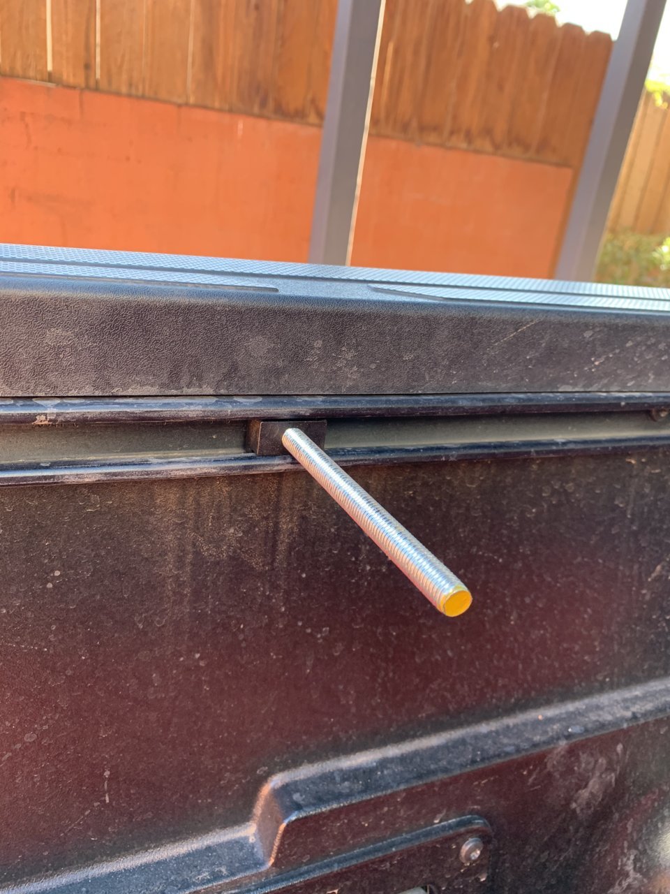

    T slot nuts, 3/8" threaded rod cut down to 6", 3/8" nut, 3/8" washer, 3/8" locking washer. Easy to take on and off with a cordless impact.

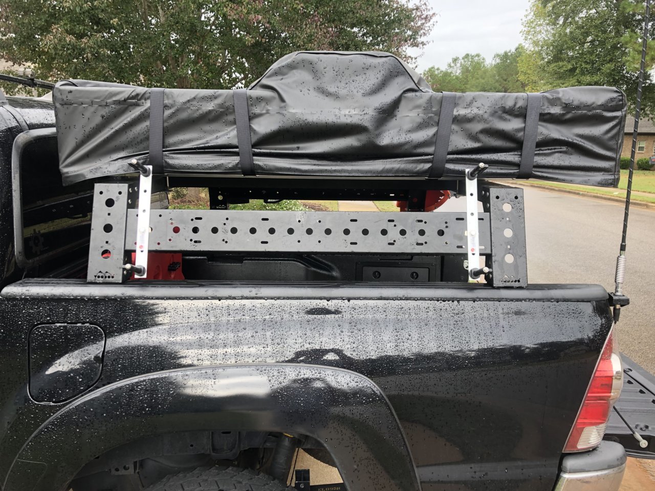

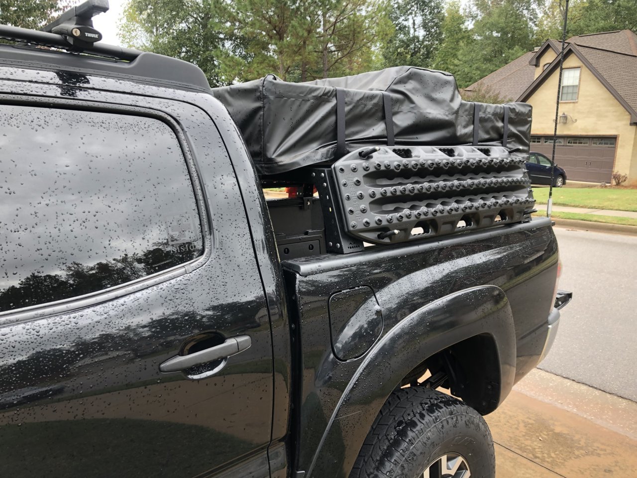

    Couple of brackets from Lowe’s and Maxtrax pins. The holes where spaced out perfectly.
