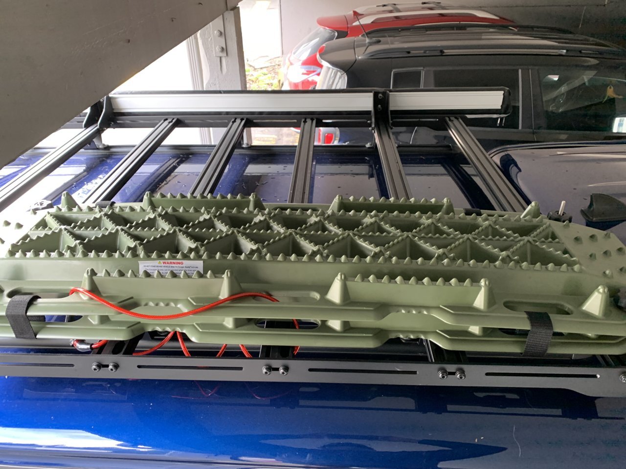

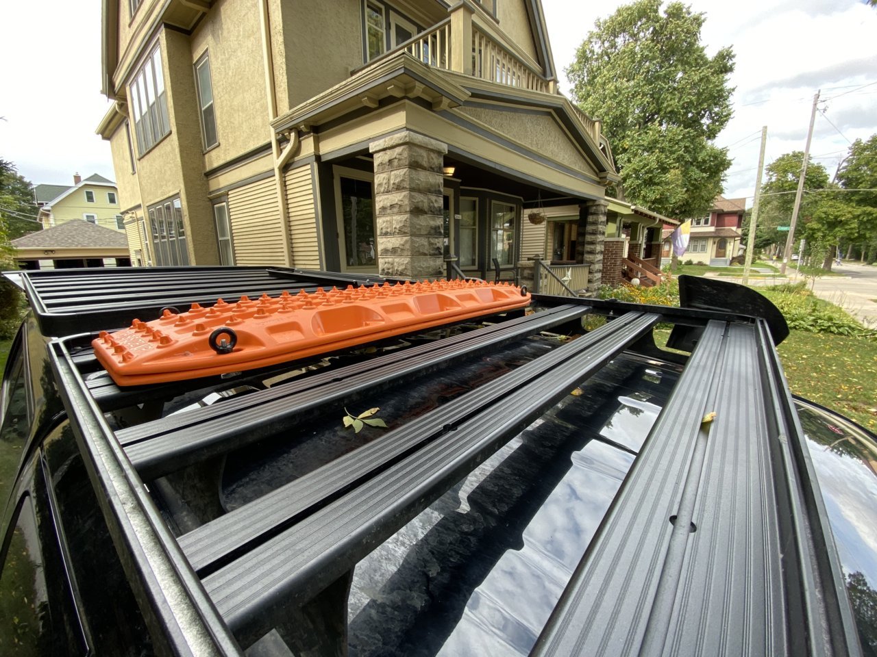

    Maxtrax mounts, couple sections of aluminum angle, a drill, some paint, couple of carriage bolts and shuffling the Prinsu crossbars around to get the spacing right.

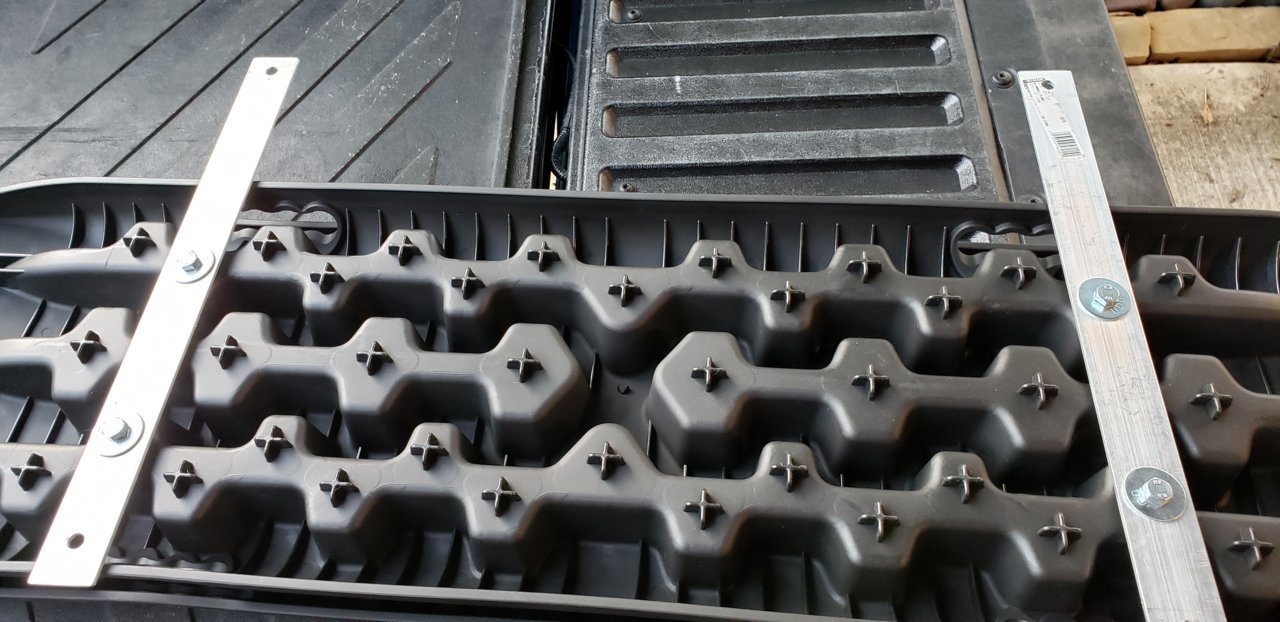

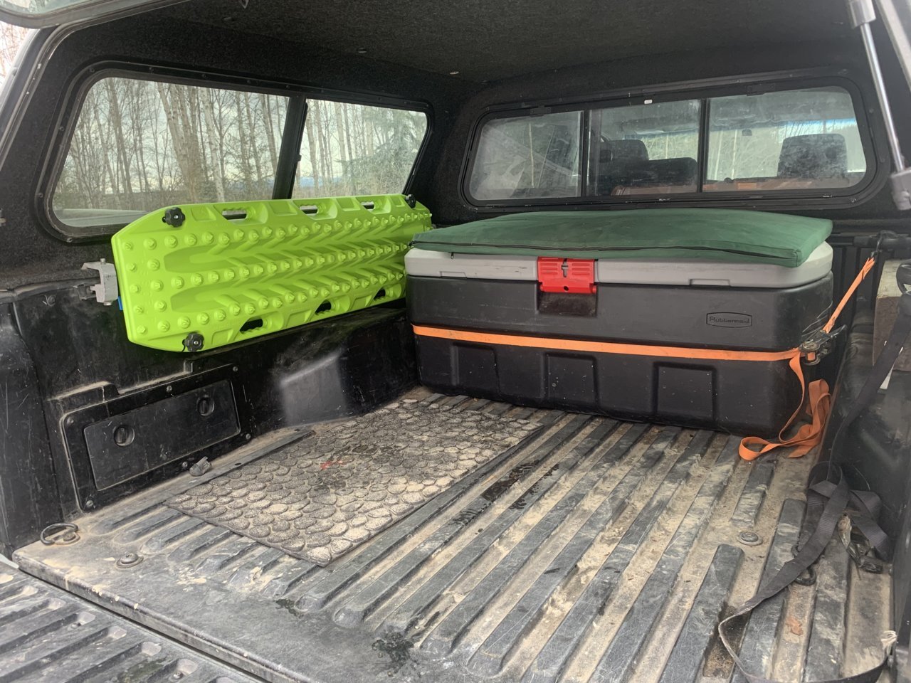

    I was able to use some ideas from this thread to cut metal brackets, used some old t nuts for the bed rails and mounted the boards today.
    071307C0-AE79-4FF7-A3FD-6734C2A7DA4A.jpg 2B8650C0-AA5F-4332-865F-973407665ADF.jpg

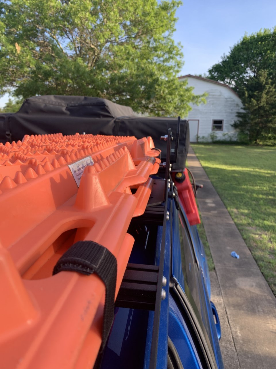

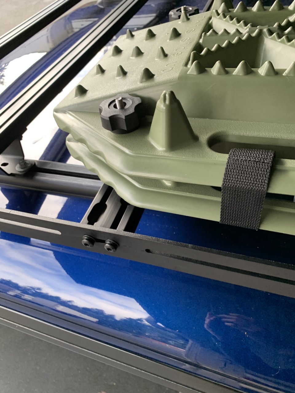

    KB Voodoo board mounts with some DIY 3/8x16 threaded rod and nylok nuts. Put heat shrink on the threaded section between the nut and where the knurled knob spins down to.
    Slapped it on my Uptop Overland rack, but mounted it to the bottom of the load bars so it would sit lower.

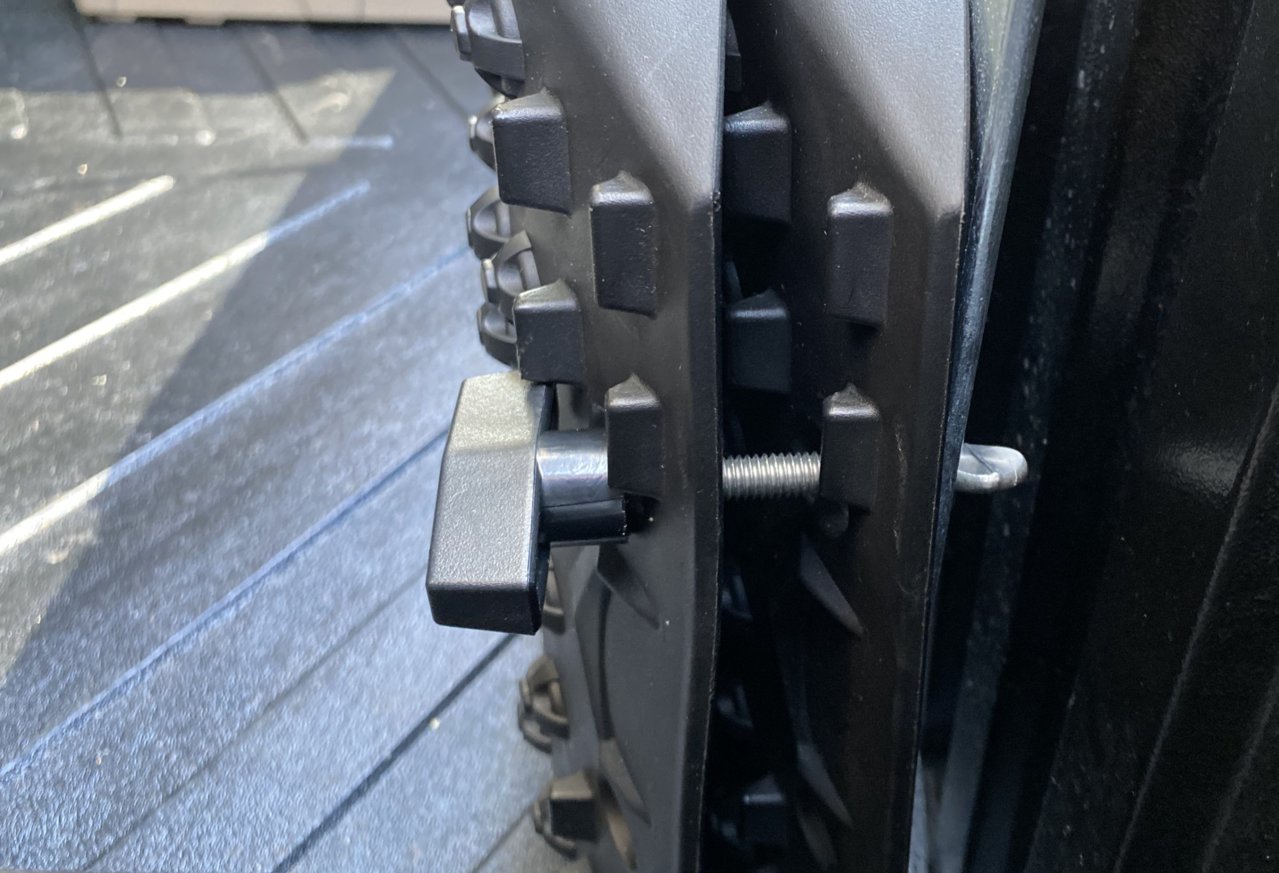

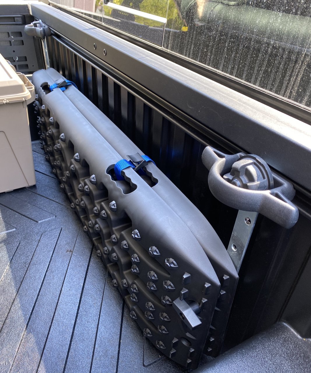

    Used the OEM tie down cleats to hold a mending brace. Then bought some knobs from Amazon. Works great, adjustable, no vibrations, easy to remove when needed.

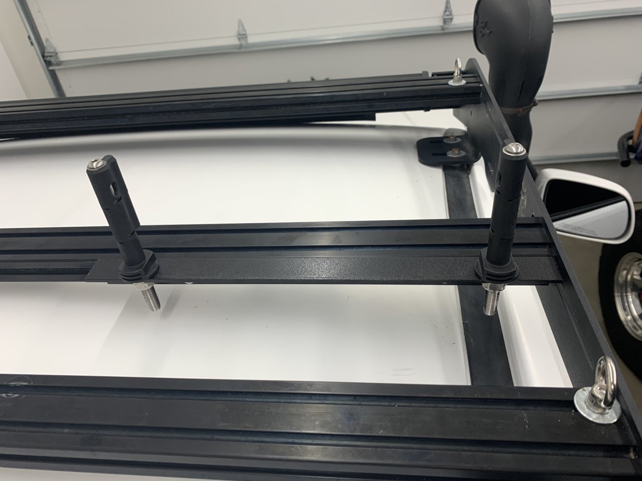

    1/4” aluminum stock, drilled with step bits and M8 bolts that slot into front runner roof racks.

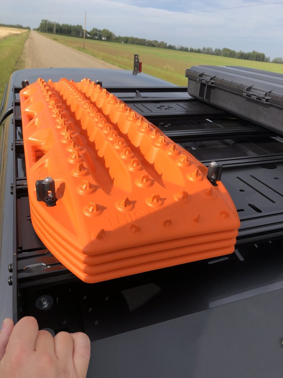

    Picked up “Blemished” Rago mounts, great deal and great customer service. Simple and clean.

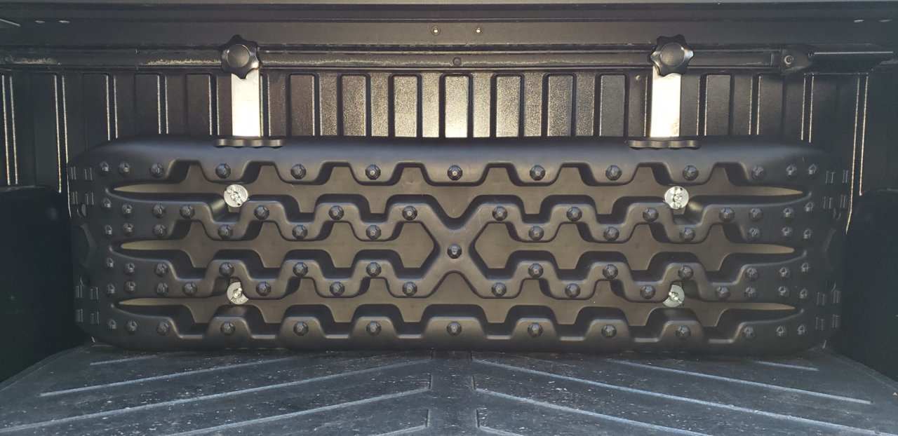

    Mounted under my Bakflip tonneau cover. 20200605_181647.jpg 20200605_194838.jpg 20200605_195154.jpg

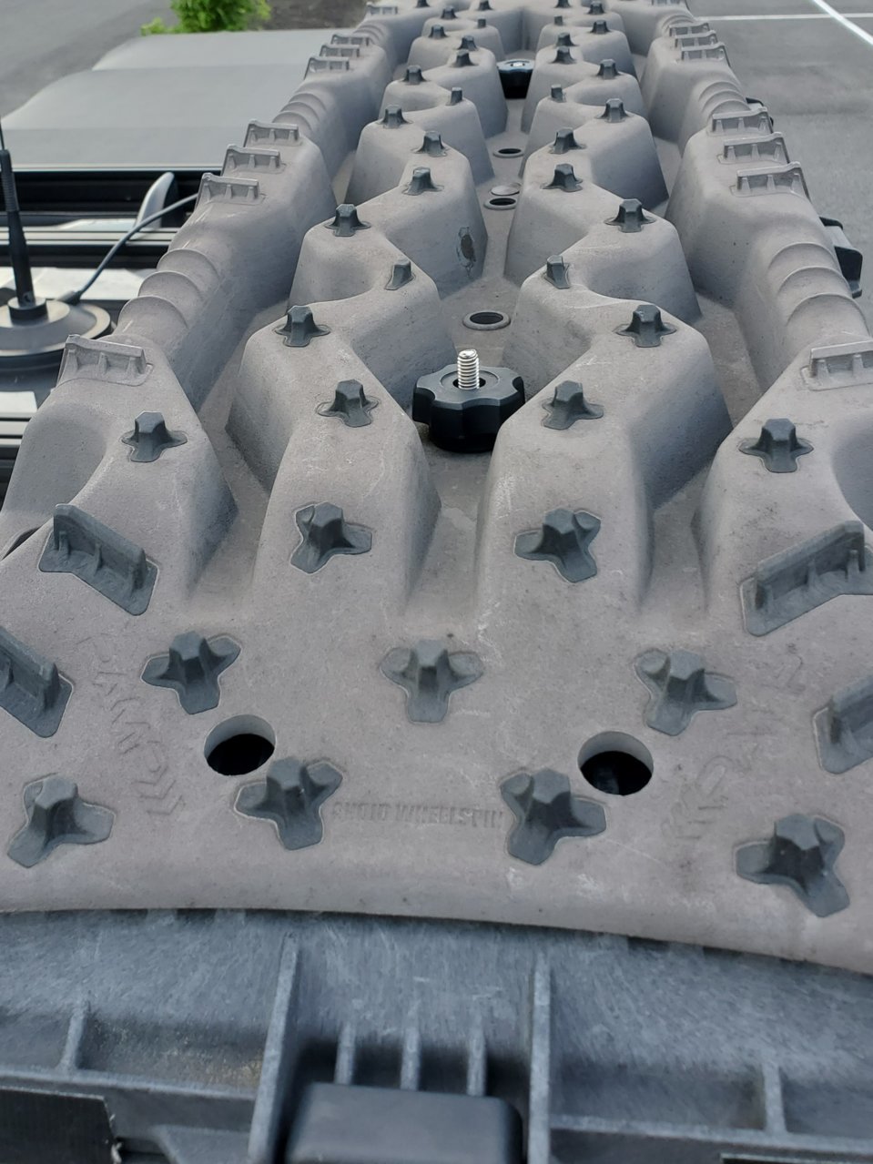

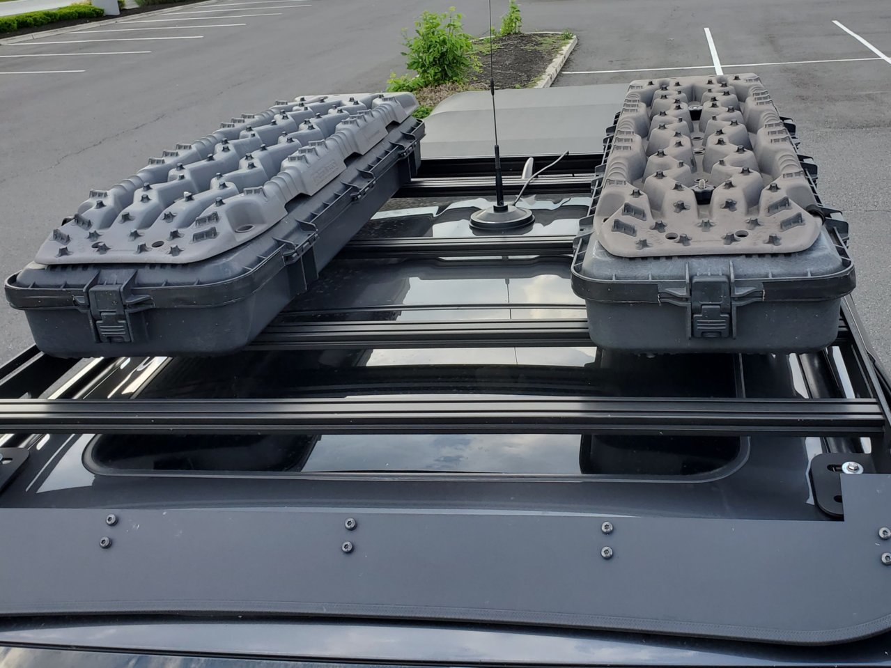

    KDMaxP10, plastidip
    This is my recent set up. I bolted the Treds to my Plano boxes using 5/16" stainless bolts and knobs. I think those are a bit to heavy for Plano's hinges to stack both on top of one case.
