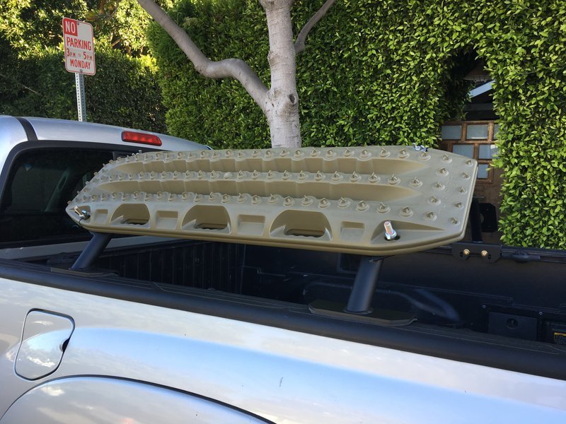

    Top of my truck bed:

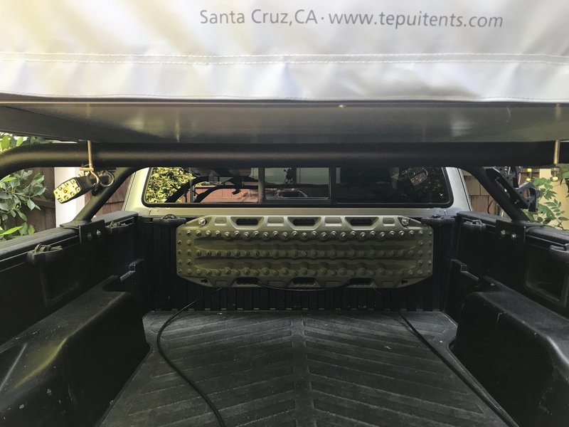

    Before my RTT came.

    Would you be able to tell me the hardware that you used to mount the traction boards to the front rail? Interested in doing the same. Thanks!

    Sucks the Maxsa boards are about 2" too long to fit on a short bed that way. I had hoped to do this but they don't fit

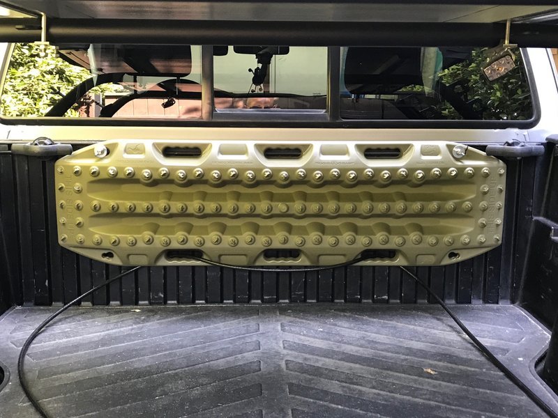

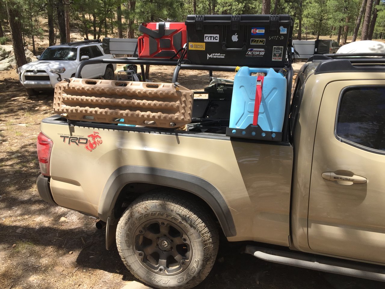

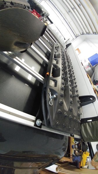

    Mounted using the MaxTrax pin set on a custom rack.

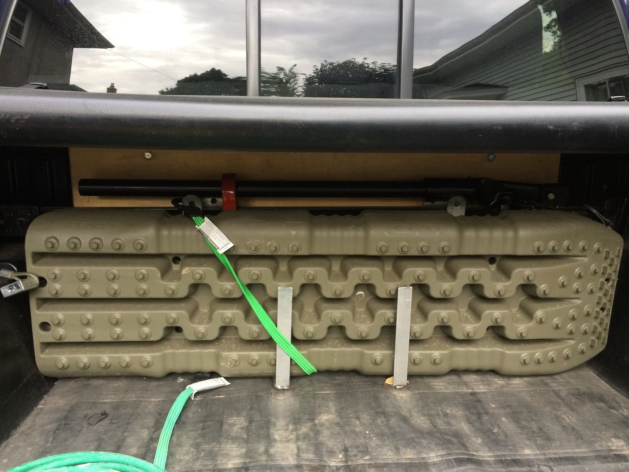

    I made a plywood panel that I mounted to the front of the bed, I mount a Hi-lift on brackets, a shovel on Quick fists, and my Treds on some aluminum brackets I welded up.

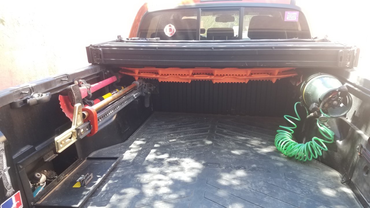

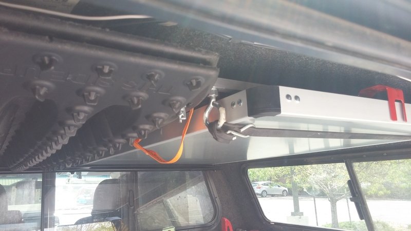

    Maxsa boards mounted underneath a trifold tonneau cover.
    Offset slightly to the drivers side to clear the co2 tank.

    Can you give me some detail on the jerry can tray? I've been trying to figure a way to do your exact setup and can't put the mount together in my head.

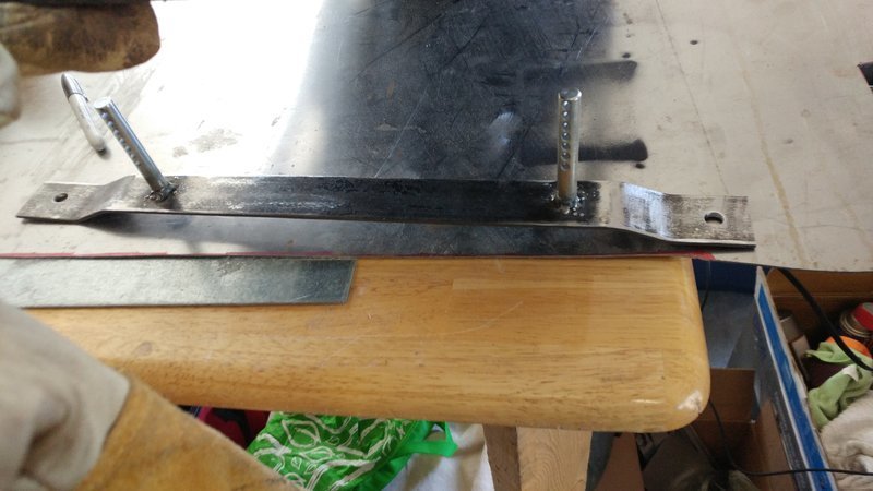

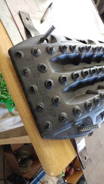

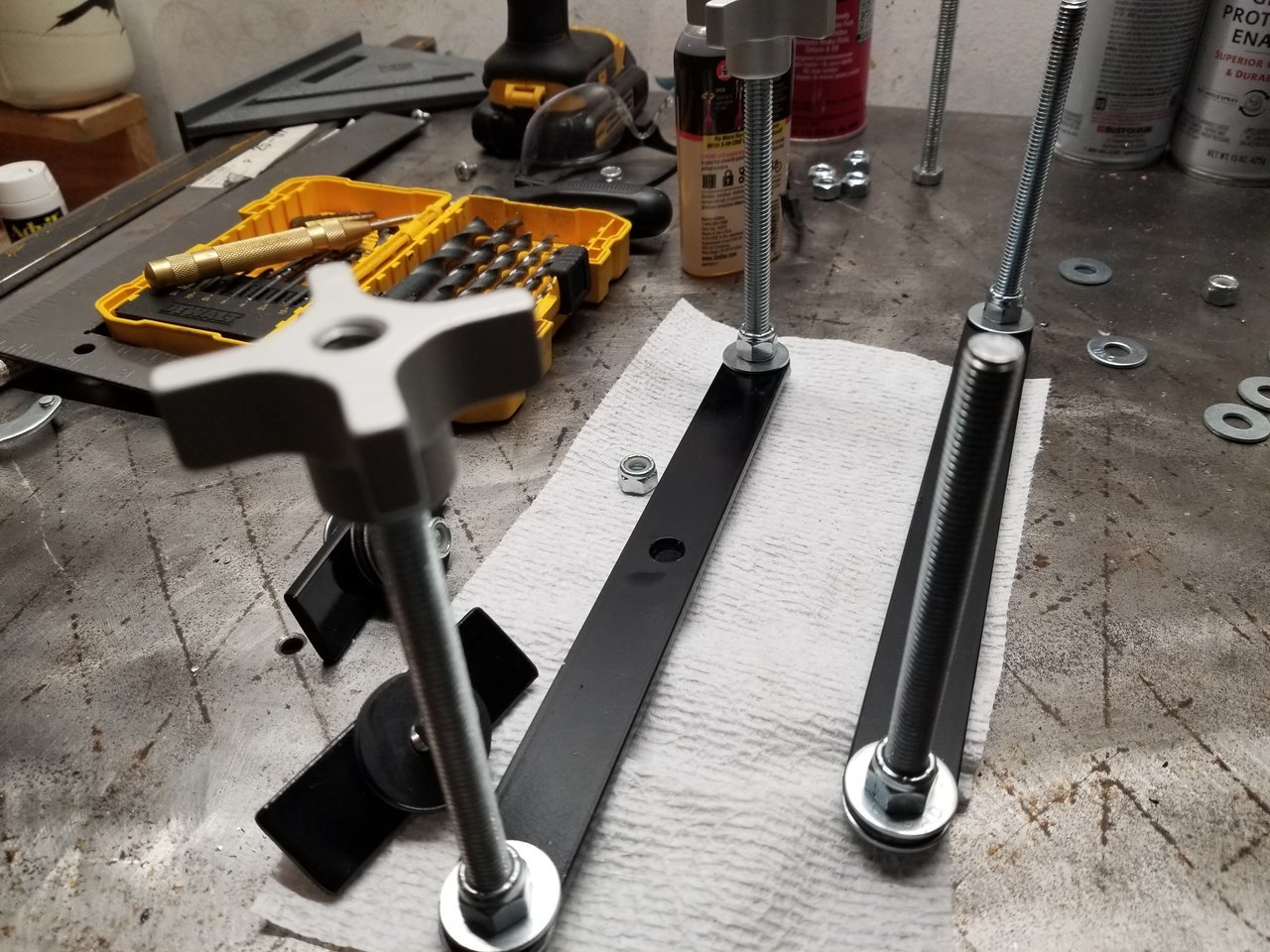

    Made some brackets last night
    A bike lock for security.

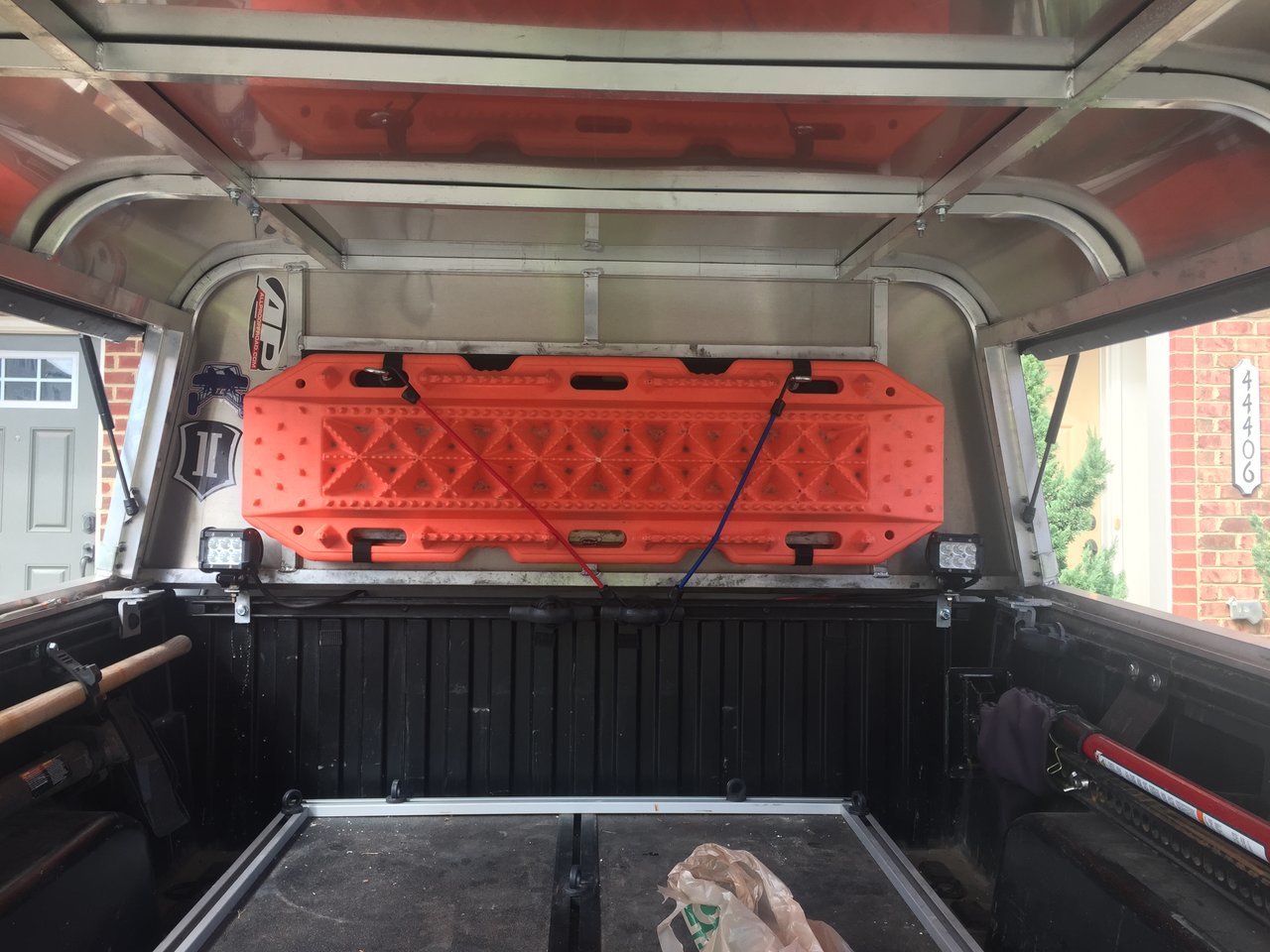

    This is how I had it in my contractor cap. A KB Voodoo cross rail, with 3.5” eyelet bolts. And a bungee to hold them on.

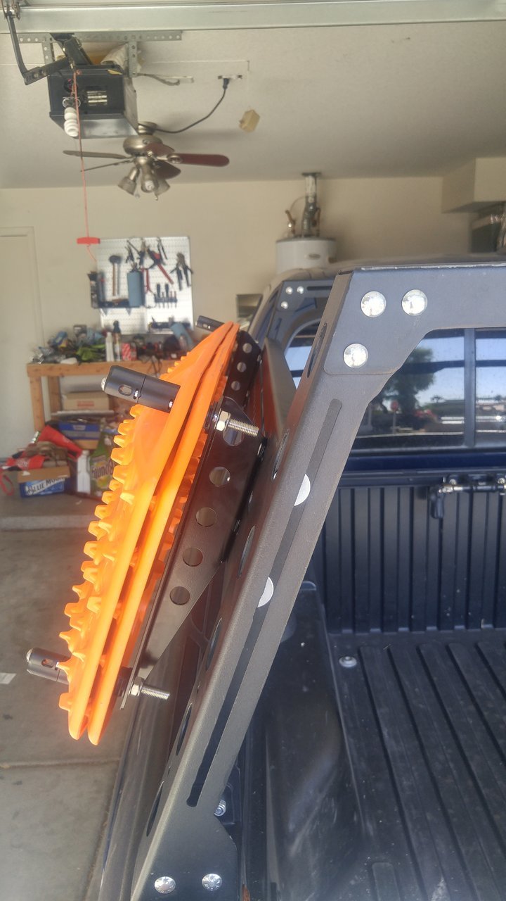

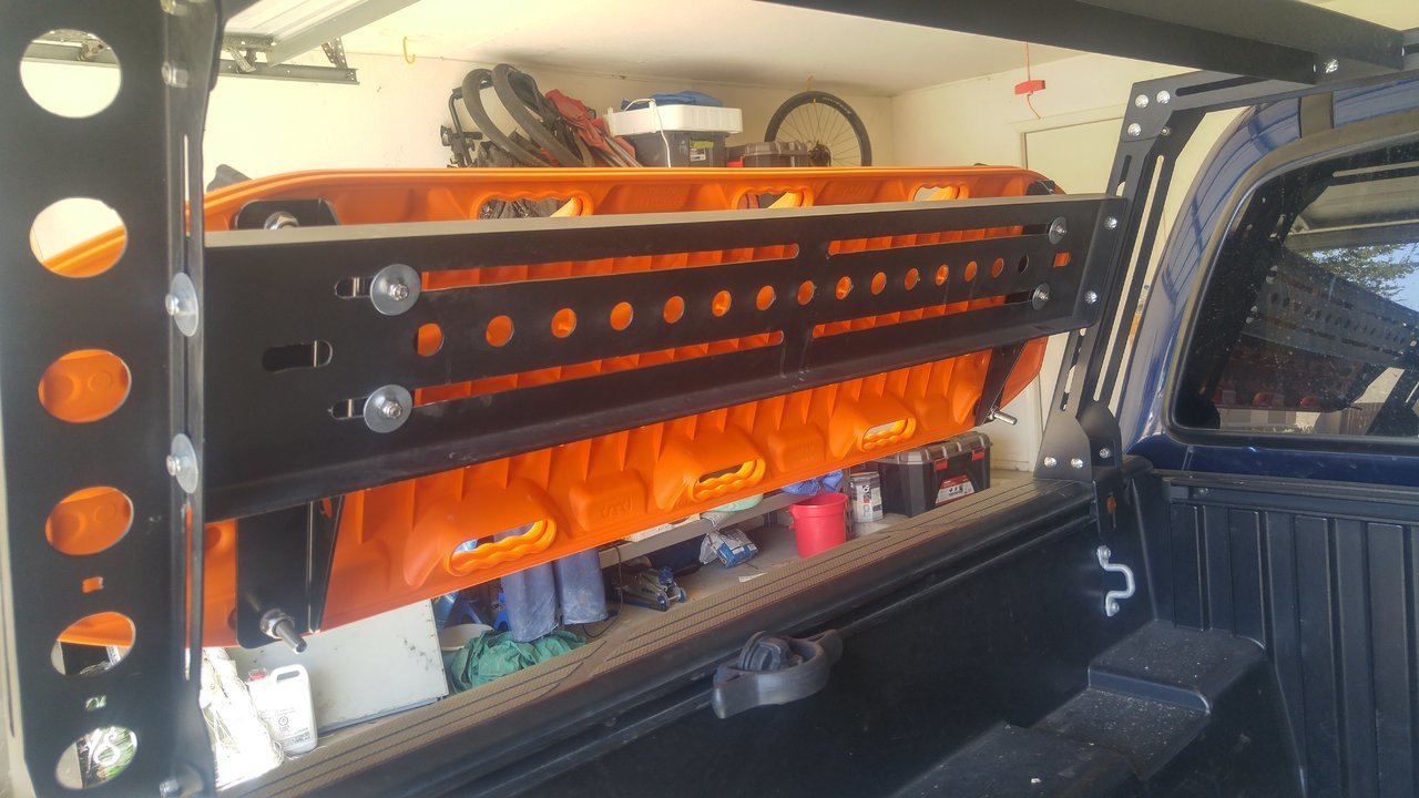

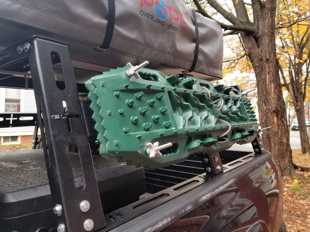

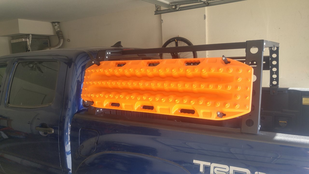

    Nice set up! Quick question.. What size locks are you using? Is there a specific brand you've had good luck with or your basic hardware store lock?
    Just got mine installed today finally..

    What brackets are you using?

    They look like the brackets kbvoodoo sells. I'm running them and they work well except on the shortbed mid rack I had to drill the holes and cut off some of the thread on the maxtrax mounting pins so they didn't scratch my bedside.

    They are indeed the kb voodoo brackets. I finally got him to design some after begging for months. They work great and I thought they were designed mainly for the low rack so I'm not sure why there would be fitting issues.
