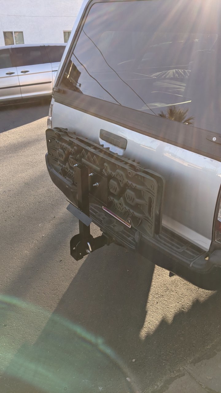

    I made a custom hitch rack out of a hinged hitch adapter and a hitch step.

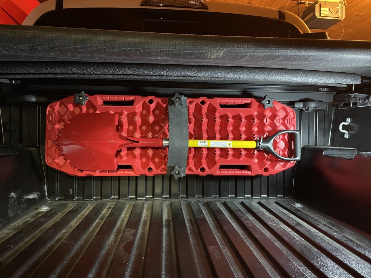

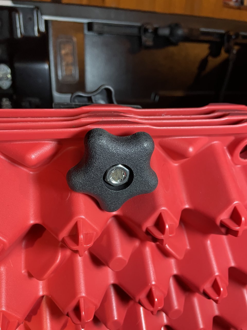

    Thanks to some ideas from this thread got my traction boards mounted. Also found a way to mount my shovel to them freeing up my side bed rail. Remove center top loosen bottom knobs and rotate poly (cut from old mud flap) to remove shovel or remove top outer knobs to remove traction boards and shovel together. :thumbsup:

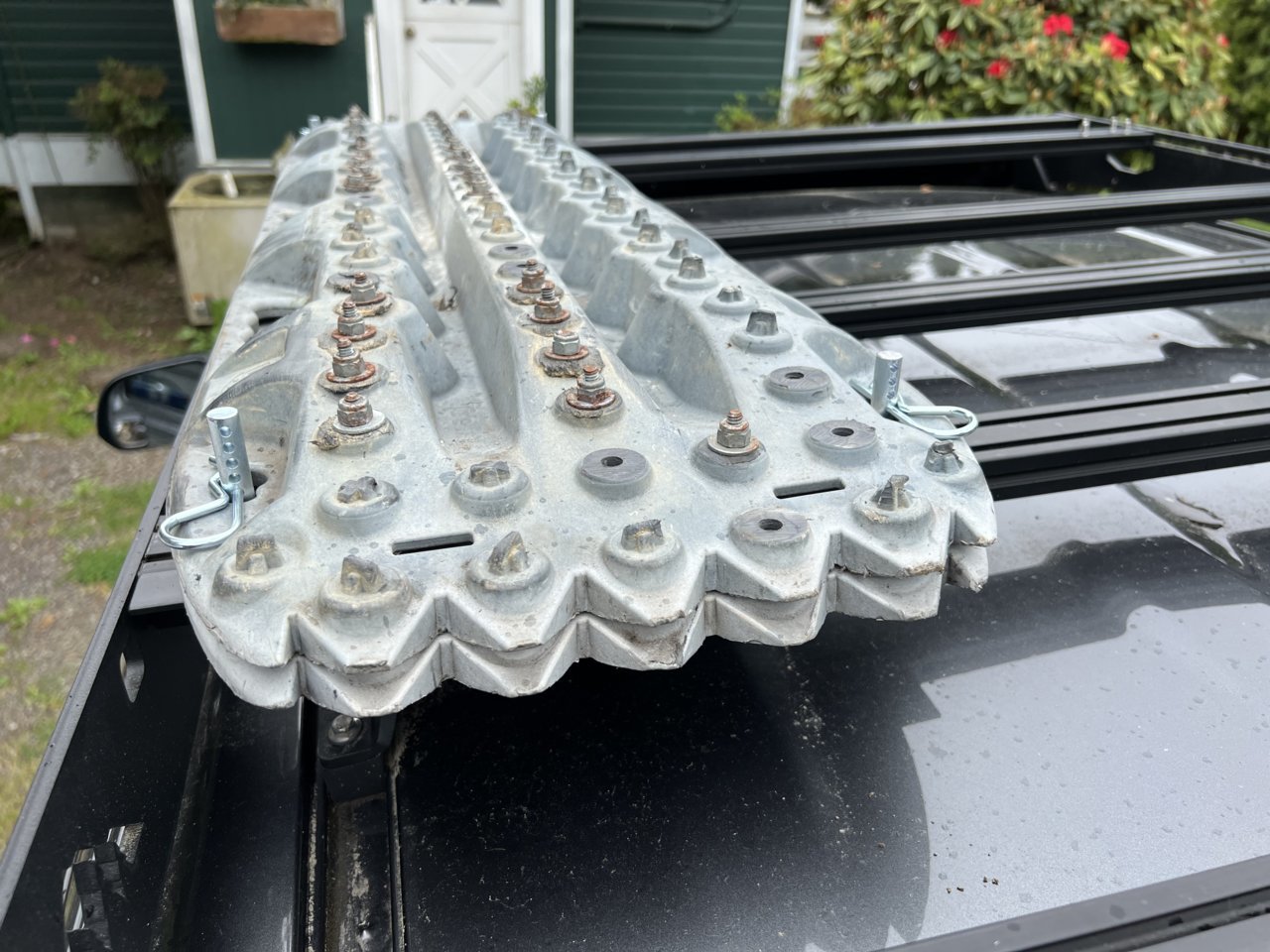

    Wanted an easy way to mount my traction boards on my Sherpa rack and also be able to take off the boards & pins when not needed. Started with 1”x 1”x 1/8” aluminum angle metal cut to the width of the traction boards & painted. The 1x1 is bolted to the side t slot w/3 1/4” drop ins or could use carriage bolts. 7/16” x 3” cleavis pins up thru the bottem of the 1x1 with a 3/8x 1/2” rubber bushing on the topside. The bushing is tight enough to keep the pin from falling thru while setting the boards on. Then simply install the hitch pin on the top. Generally I don’t have the boards on the rack for day to day driving so wasn’t worried about a locking set up. Figure if I can just wrap a cable lock around it if needed. 1AB8869D-3526-479C-80A6-8A7EFD743565.jpg

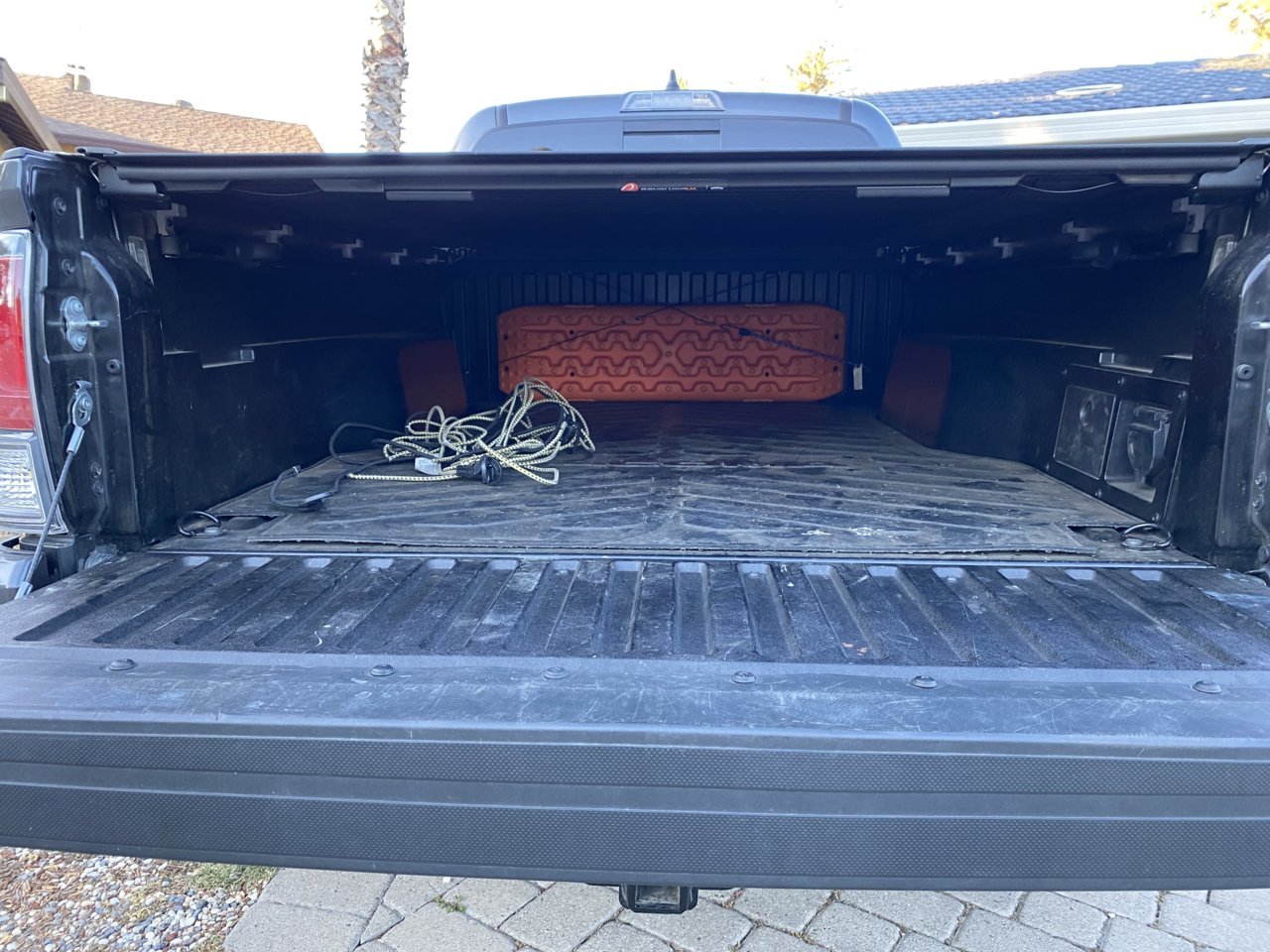

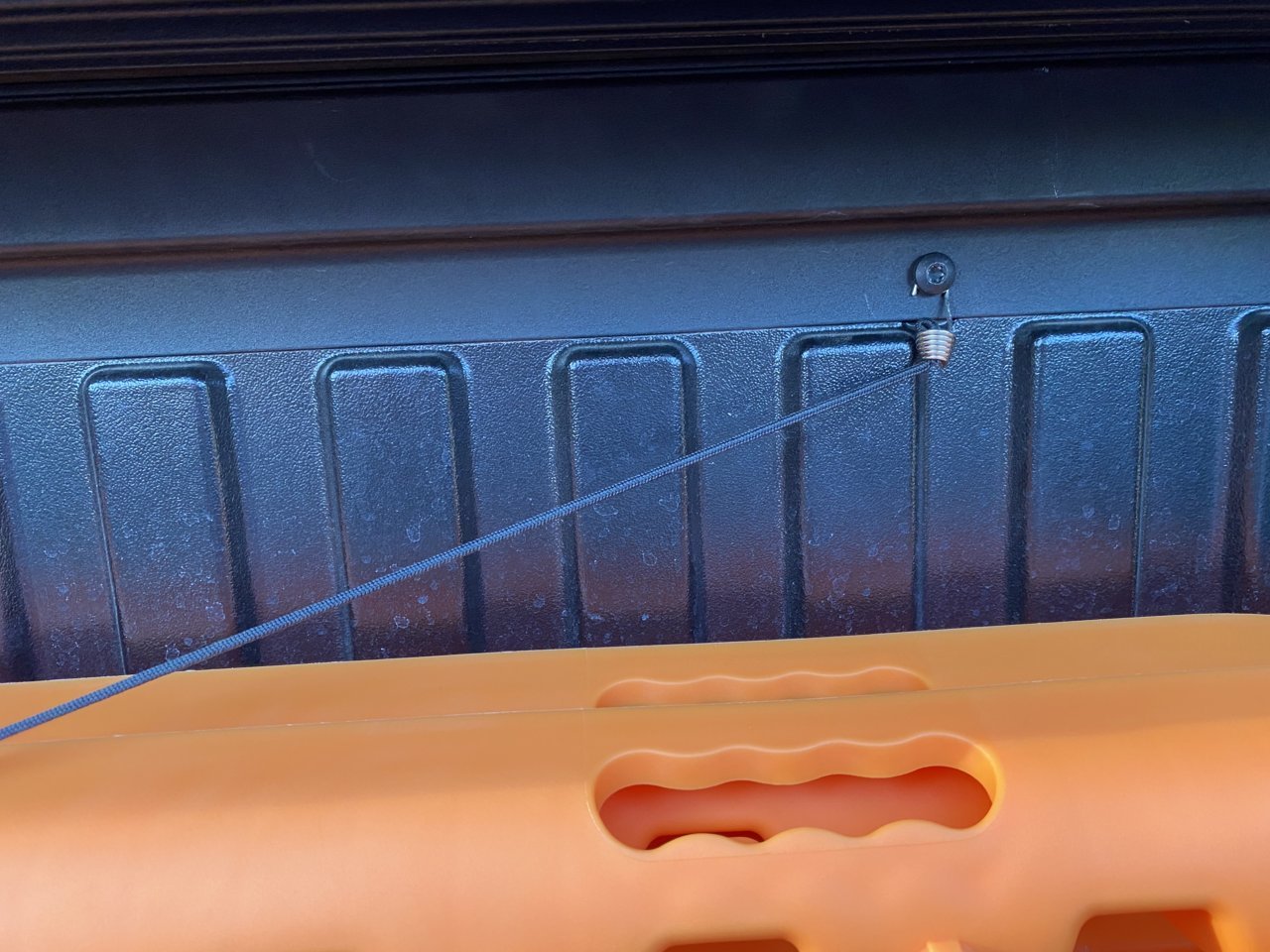

    Picked up some x-bull traction boards and rigged up with random bungees and some thick foam sticky pads on the bulkhead to prevent rattling. I’ll figure something more permanent later, but this works surprisingly well. Can’t beat the $0 solution. :)

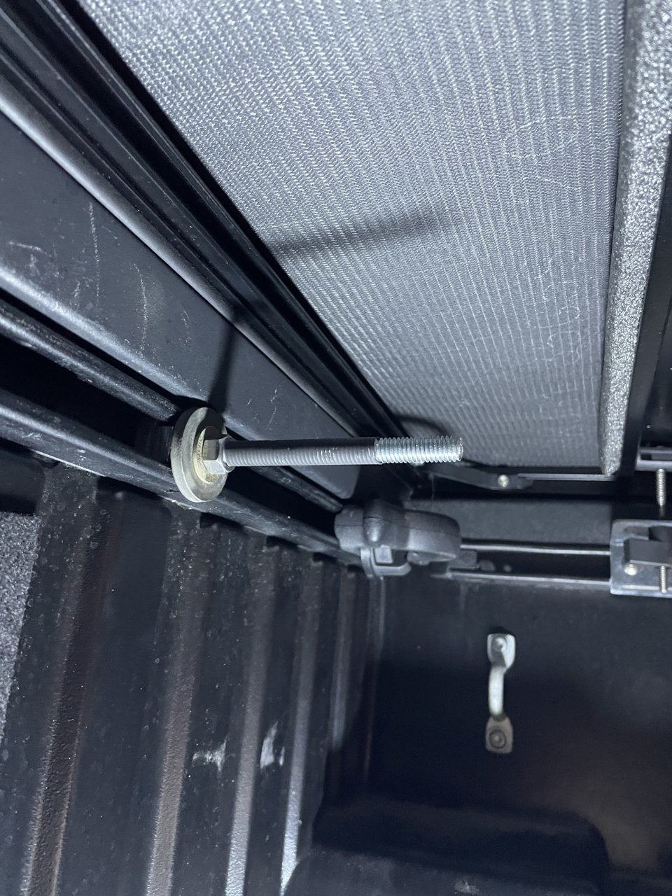

    Made this one from Ace hardware parts yesterday. Pretty much just a 3/8” threaded rod, nut and plastic nut cover. Requires a header rail.

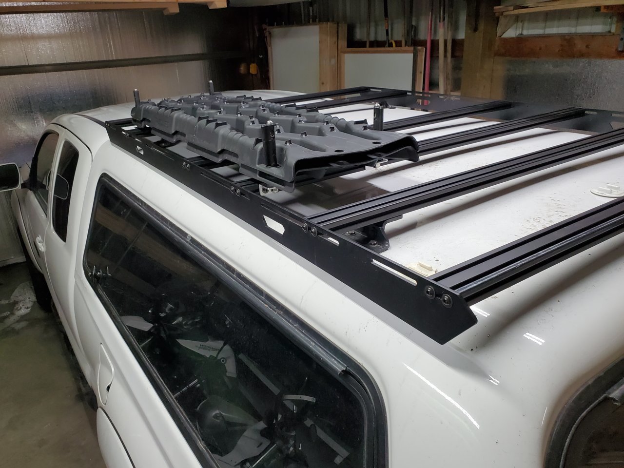

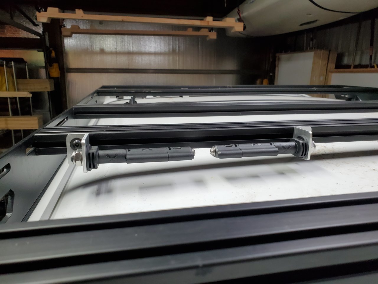

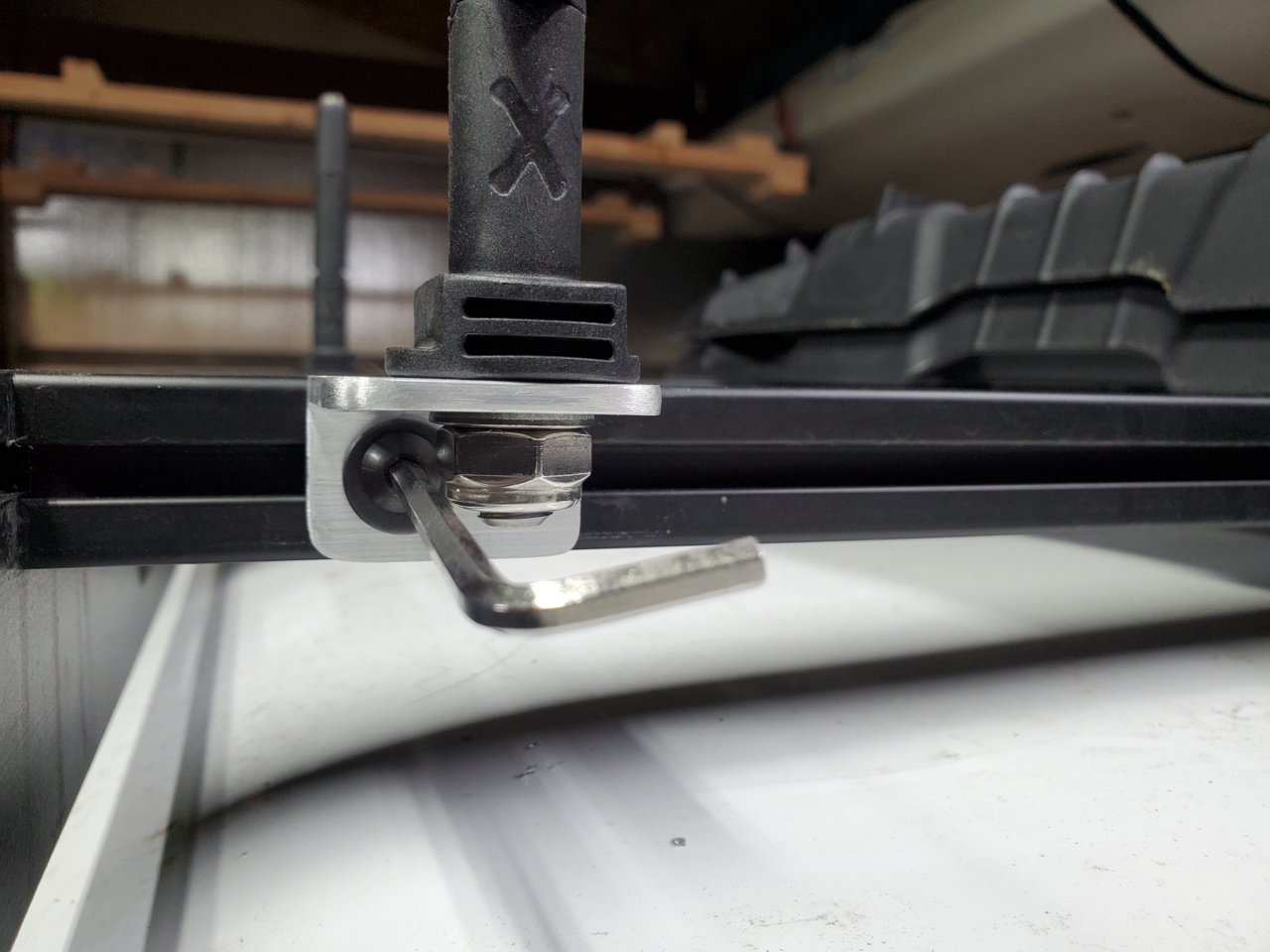

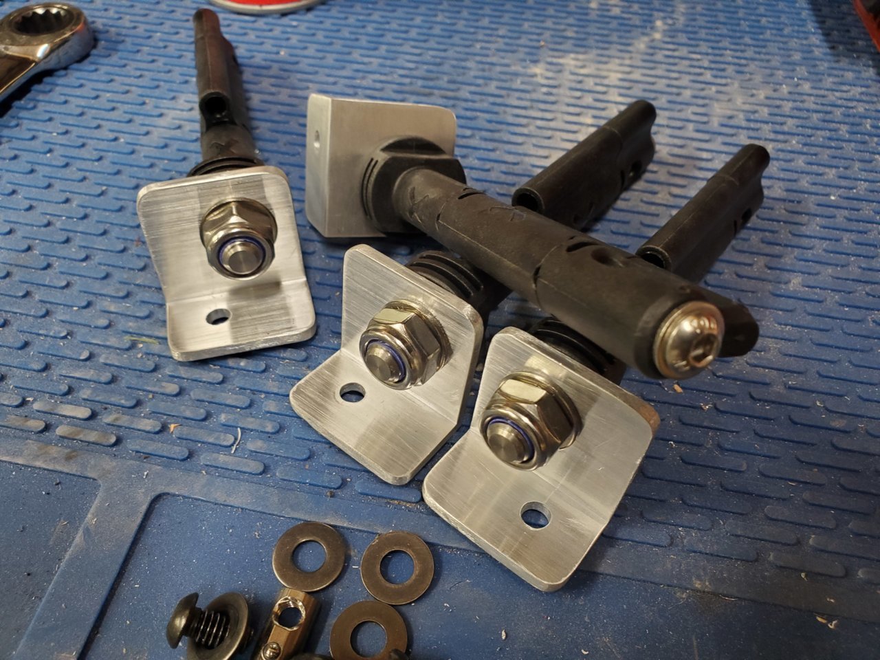

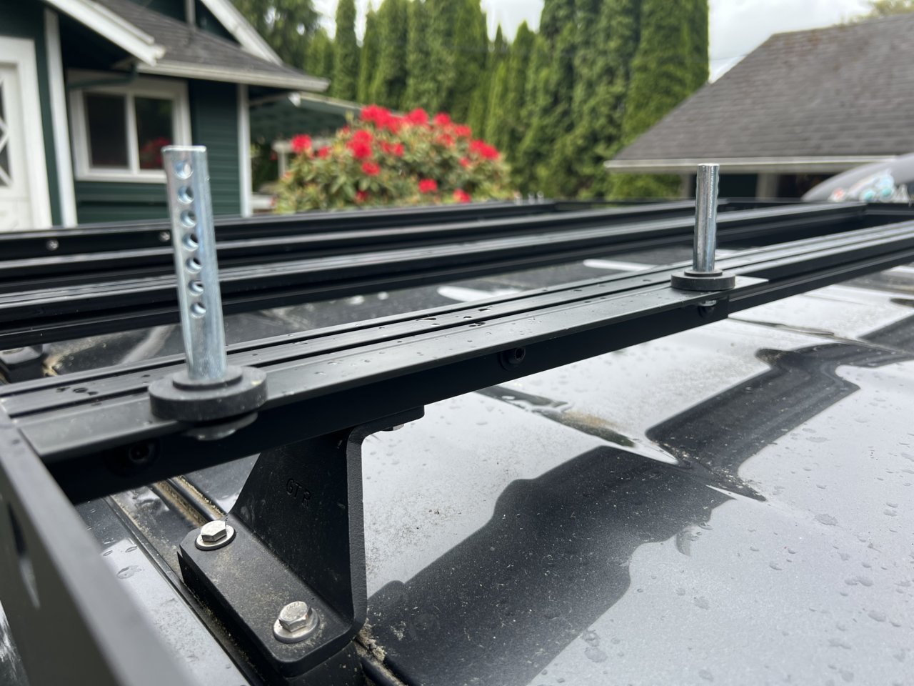

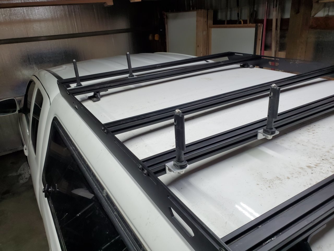

    Mounted my new ARB Tred Pro traction boards to my DIY aluminum extrusion roof rack using Maxtrax Xtreme mounting pins, and some 1 1/2" Aluminum Angle (1/8" thick).
    There has been some speculation on the internet as to whether the Maxtrax mounting pins will fit on the ARB Tred Pros, and I'm here to confirm that they fit 100%, with no modifications at all. The Maxtrax MKII pins WILL NOT FIT. The Xtreme version is thicker, and the Tred Pros are the same thickness, with identical mounting holes.
    Each mounting post is secured using a single bolt to the aluminum extrusion, so I can easily pivot it out of the way when I'm not carrying the traction boards (these things are kind of expensive to be leaving out in the open 24/7...)
    The mounting hardware is offset from each other to accommodate an allen wrench to remove/secure it.

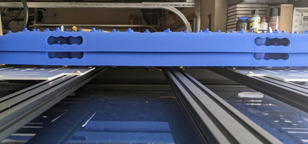

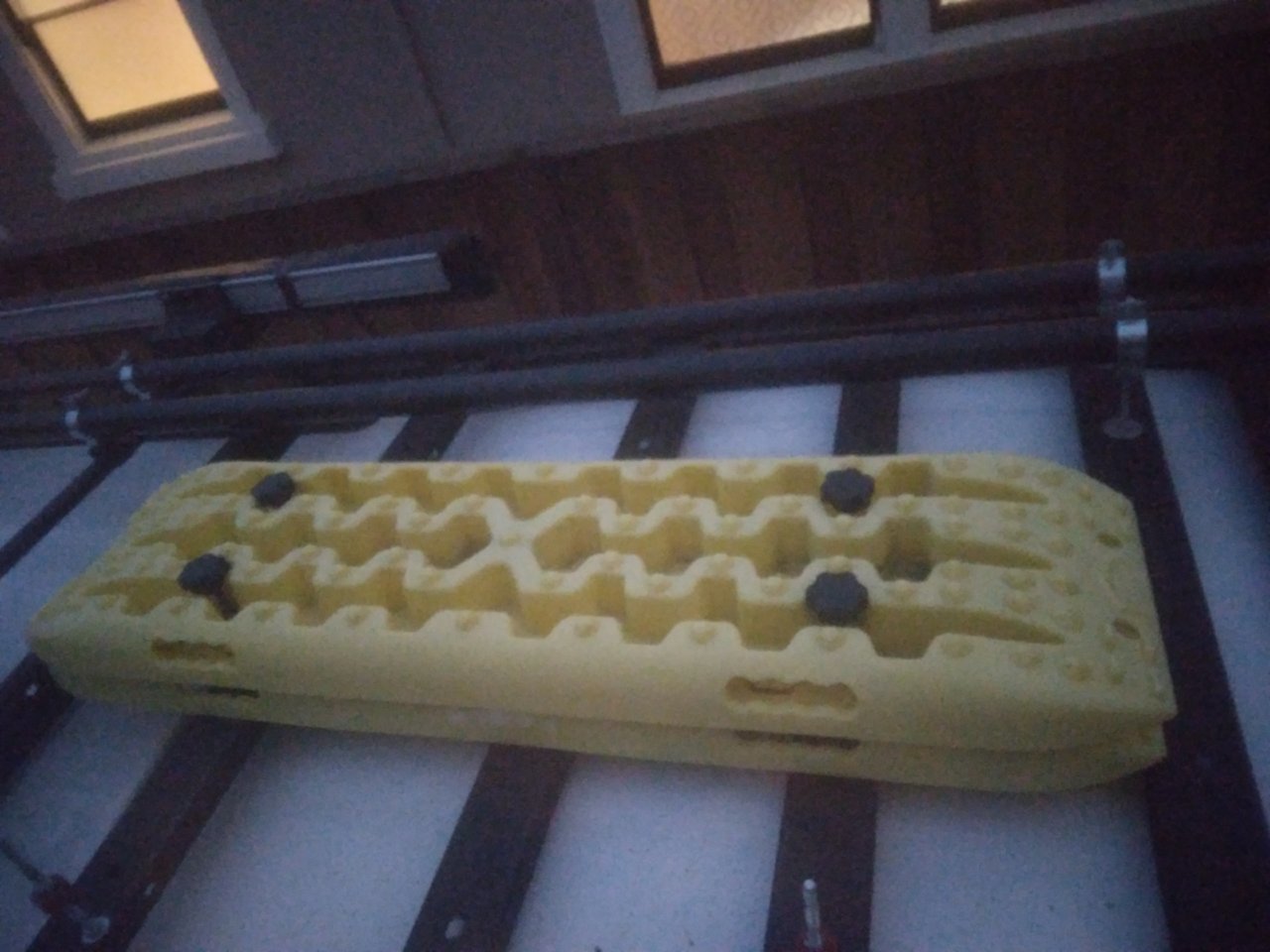

    TRACTION BOARD ADDITION
    I got a set of X Bull Traction Boards Gen-3 a few weeks ago, and they turned out to be the perfect size to fit in my extra space on the roof rack. The mounting hardware was OK, but I did a few mods to make it work for me. At $44.90 and free shipping, I couldn't pass it up.
    The supplied hardware included four M10 x 165mm (6 1/2") all thread rods that are NOT stainless steel. Some black knobs , washers, and nuts. Also, a black hold down piece. It was close to what I needed, but I replaced the 4 all thread rods with (4) M10 x 180mm (7") stainless steel threaded rods, to work with my configuration. I also added some 1"x2" aluminum spacers.
    I also picked up some nylon 1" yellow strap to attach to them so I can find them if buried.
    The extra space on the roof was a perfect fit for the boards.
    I used the aluminum spacers because the knobs cannot be screwed down within the board itself.
    A perfect fit, one of the easiest mods I've done.
