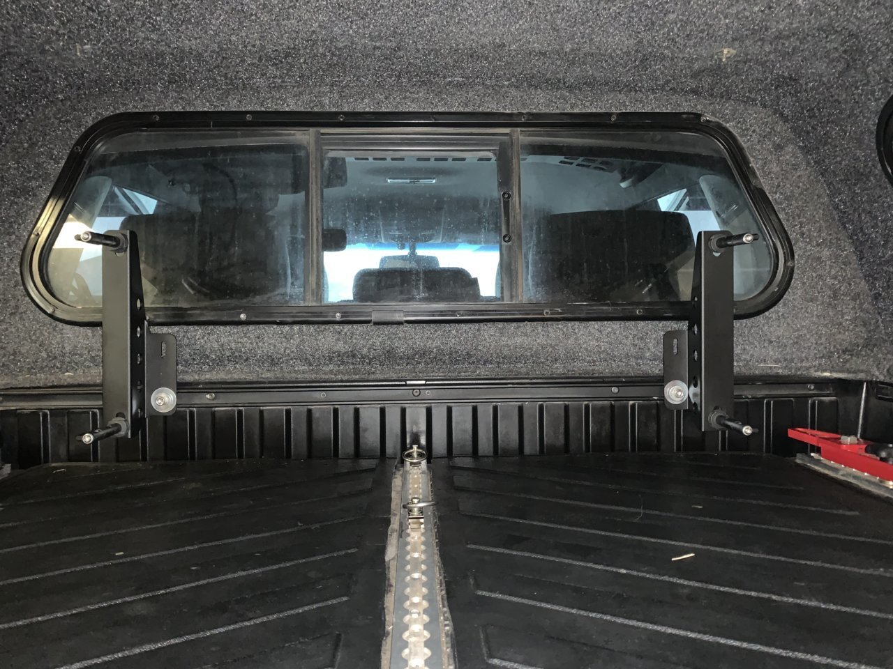

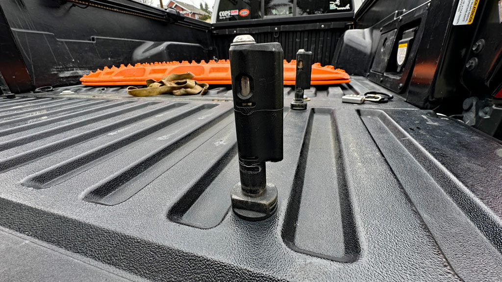

    I wonder if these mounts would work:
    1. on the passenger side of the bed (my spare is behind the window until swingout arrives) without hitting snugtop
    2. with knockoff $60 Amazon traction boards (X-bull, etc.)

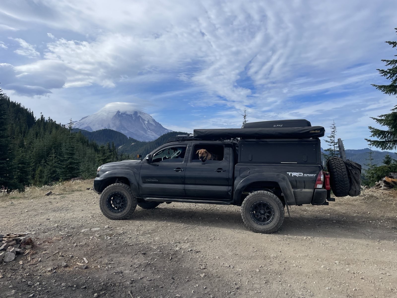

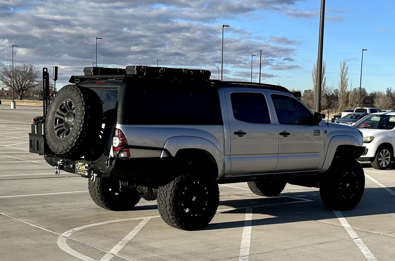

    They might I don’t know why not. Maybe selling these soon and moving mine up top on my rack

    truck looks sick makes me want to put hooks like that
    surprised they don’t rattle or get stolen

    I wrap the mounting bolt/pin with a wrap or two of electrical tape which tightens up the play at the mounting points enough it takes the rattle out. havent had any issues with people stealing any of mine (front or rear) "knock on wood" as of yet.

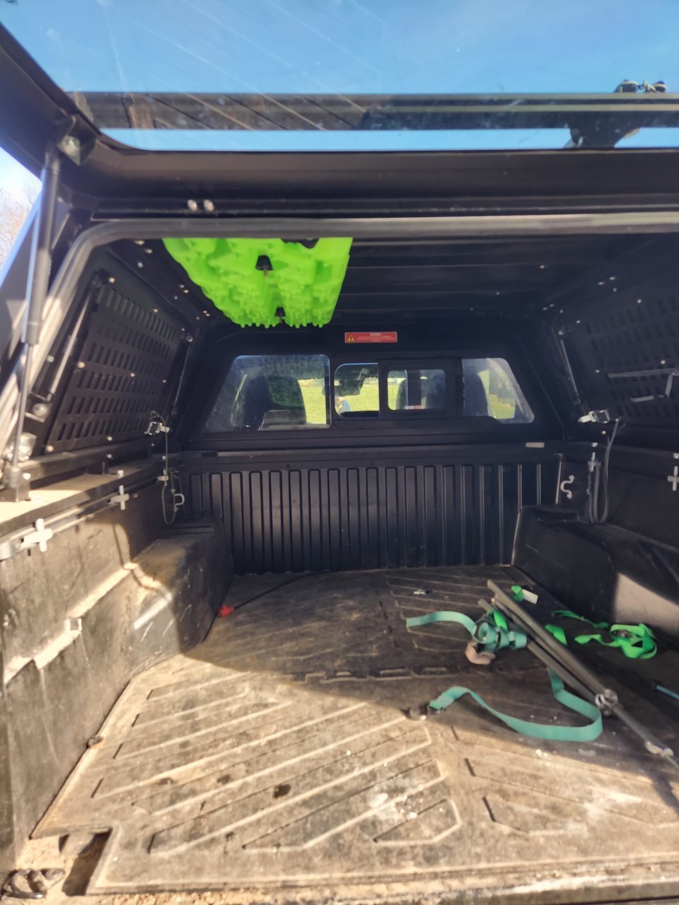

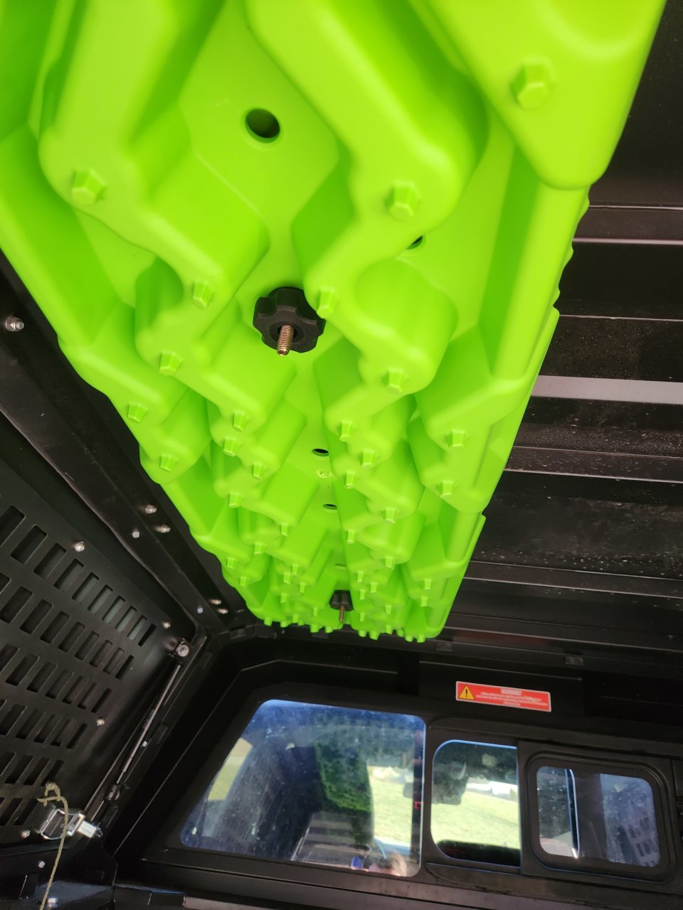

    I have a smart cap with pre threaded holes so I bought two100mm long 8mm threaded rod and two plastic threaded knobs. Fits great and doesn't take up bed space

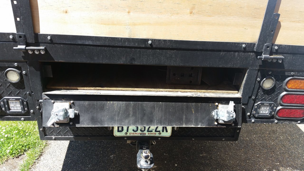

    Toss them in a cabinet, lock the door, and call it good. never have to find a place to store them when I'm not out exploring, don't take up bed space, and never forget them at home.
    They have a dedicated space in my flatbed.
    Was still waiting for them at the time of the pic, but 2 pair of Maxtrax, a 4 foot Hi-Lift, D handle shovel, and an axe all fit in here, and I think there is room for either 2 more pair of Maxtrax, or a Rotopax style gas can.

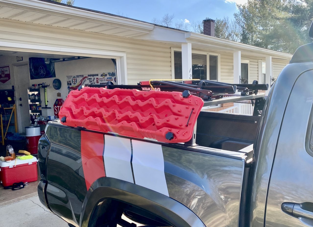

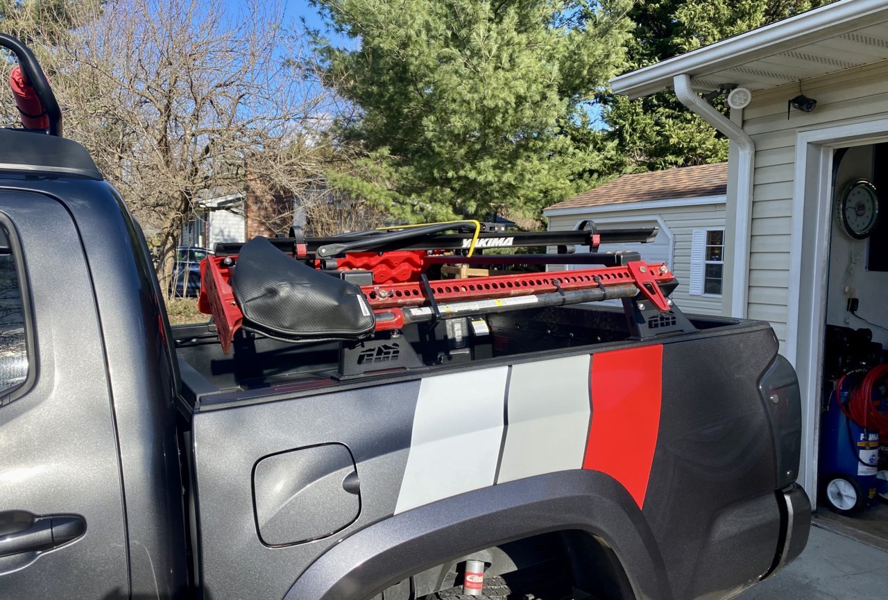

    CBI bed bars with CBI board mounts… HiLift on opposite side.

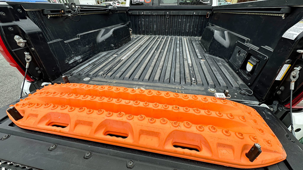

    I'm using the OEM mounts on the tailgate for super fast/easy removal. The leashes get stuffed between the boards and the tailgate, a lock is applied to one mount.
    Wow, did the math -- that plastic is 10 years old!

    I'm liking this... Can we get a picture of it without the boards attached? Wonding how/what you mounted the pins to.

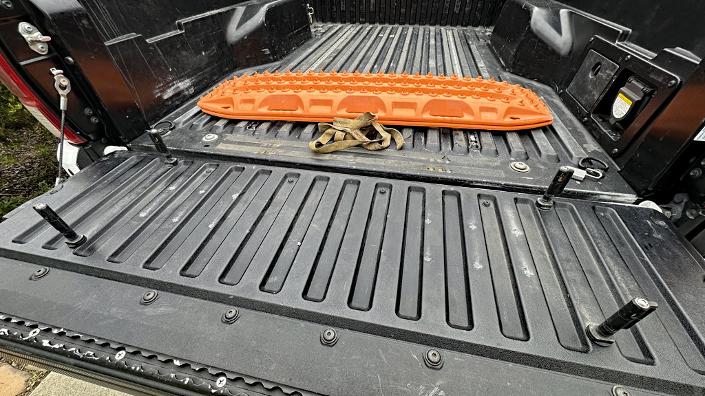

    Are the pins sturdy enough to hold them when wheeling? Guess I didn't give the plastic enough credit. Any reinforcement on the back side?

    Just your basic washers. Yes, they are plenty beefy for off-road use.

    Guess I could have worded it better... I should have said are the pins mounted solidly enough to hold the boards while wheeling, but sounds like they are. Thanks for the info and pics!
