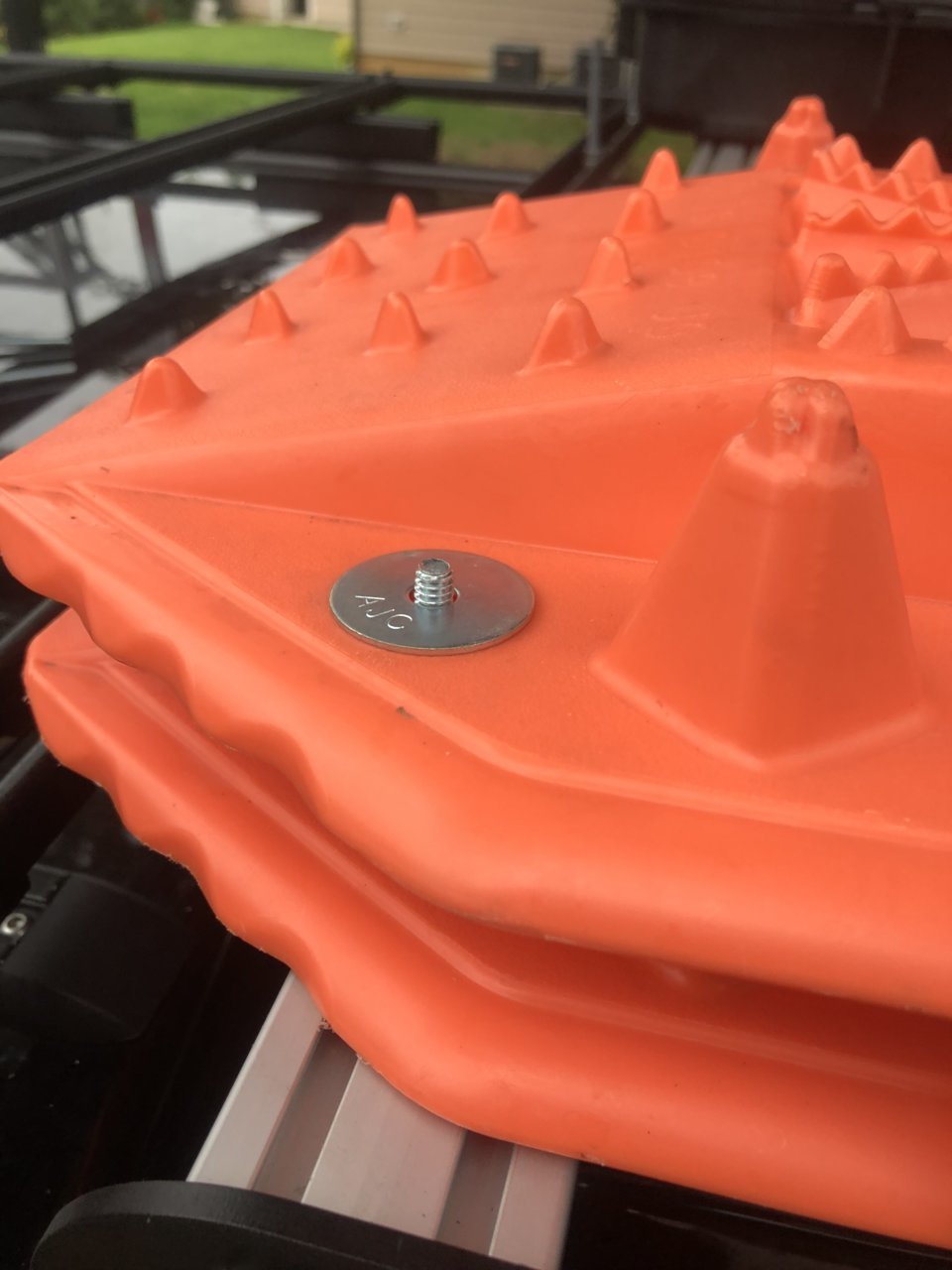

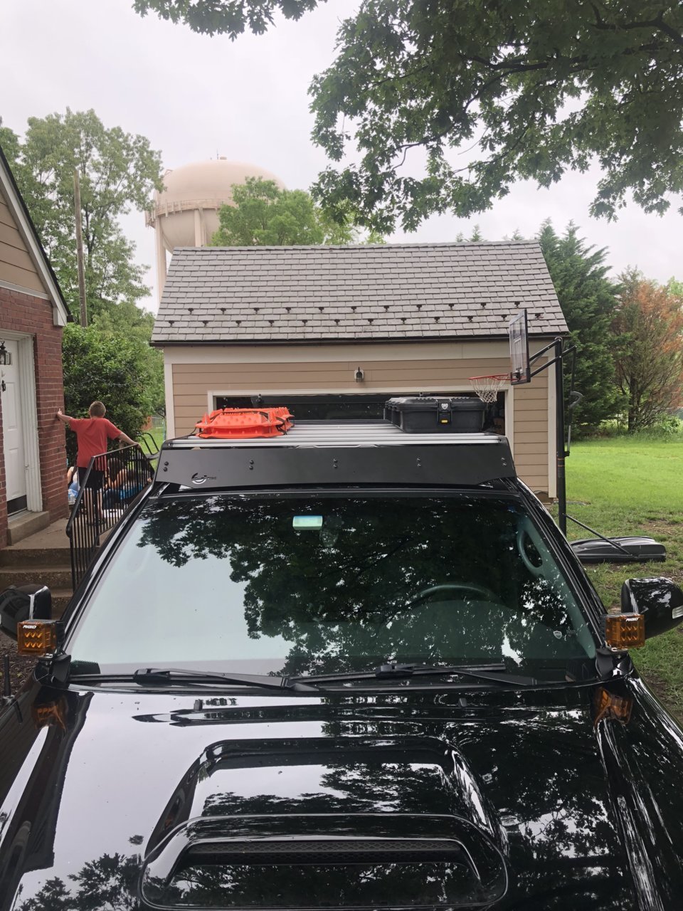

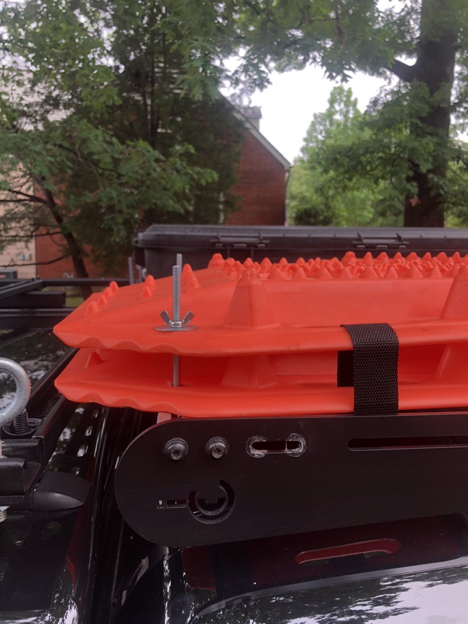

    Carriage bolts washer and wing nut for now.

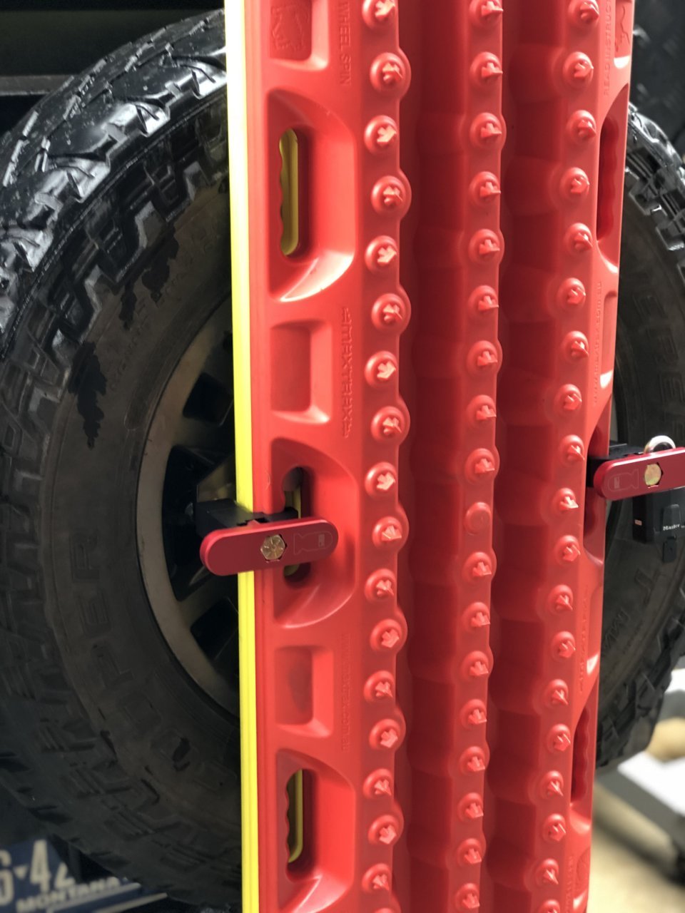

    This is how mine are mounted. Lockable, and as a bonus it keeps your spare secure from hooligans carrying around an impact gun.

    What mounts are those? Looks good man.

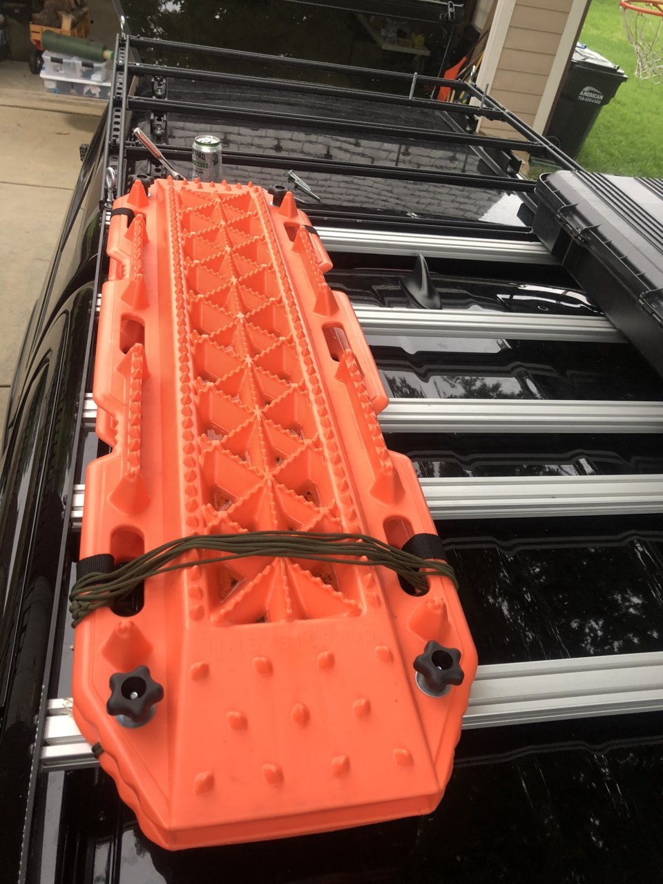

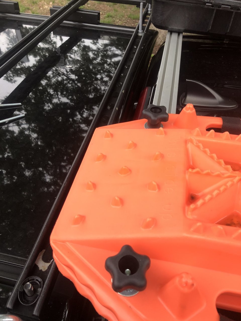

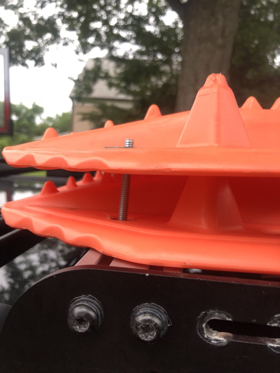

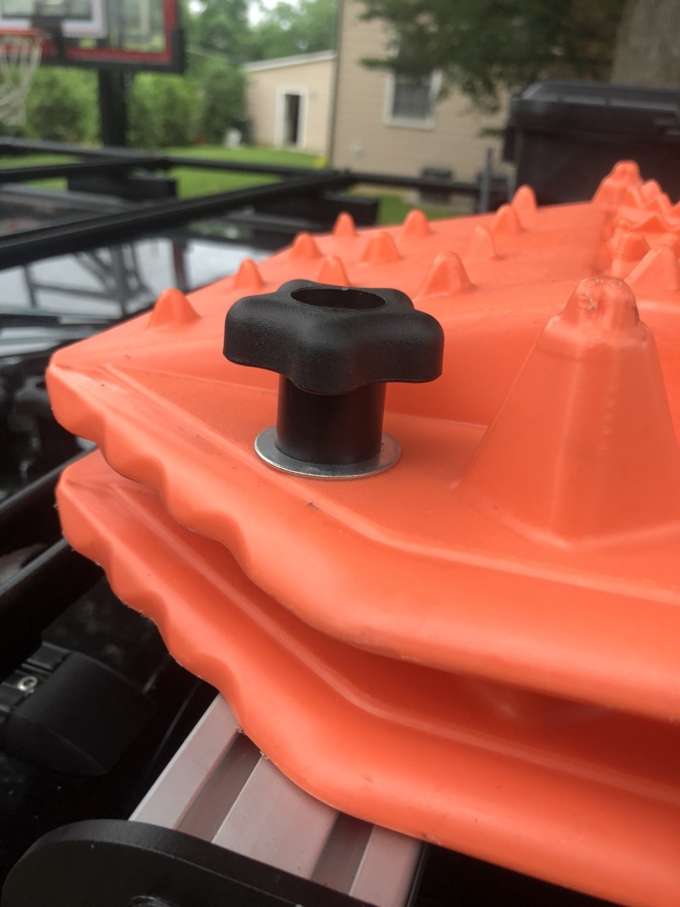

    Ok decided to redo mine. Prinsu rack with 1/4-20 2-1/2 in carriage bolts washer and Black Star knobs with plus nut on top of thread to make it nice and tight.

    I make em. Thanks for the kind words!
