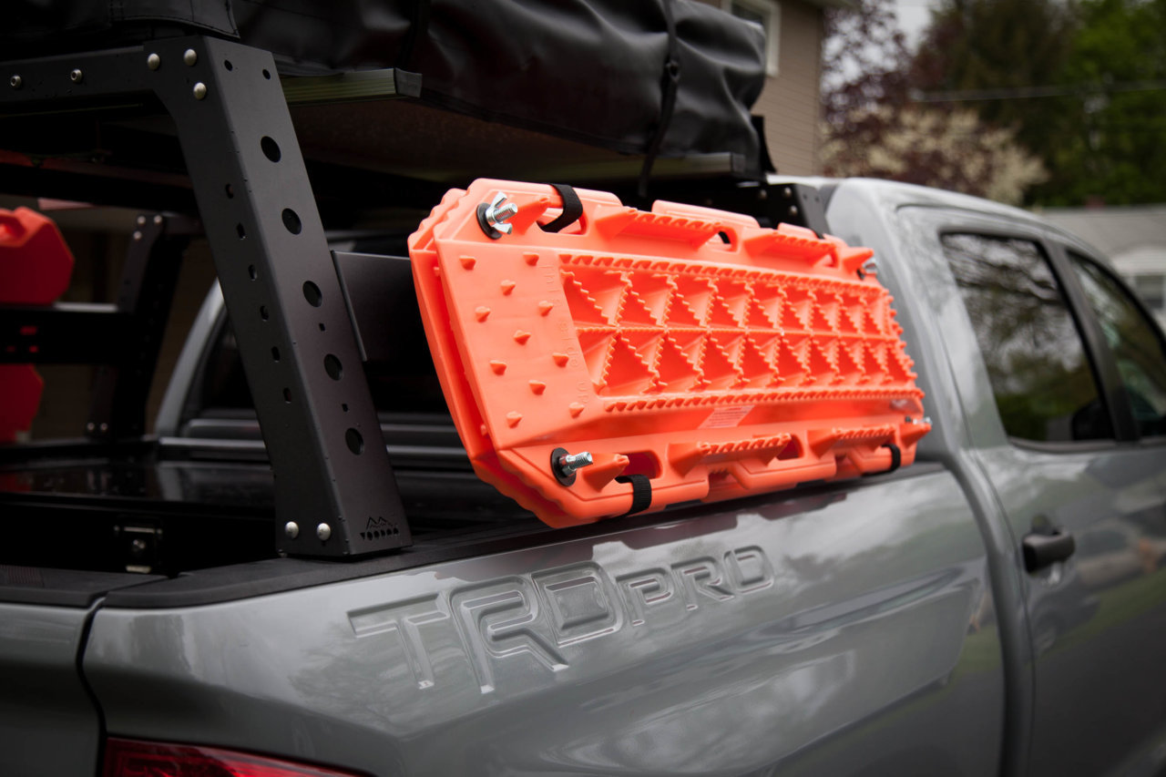

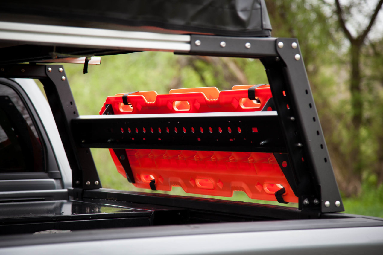

    How did you mount these? I have TREDs too and want to mount them just like this
  3. Aug 2, 2018 at 8:19 PM
    #123
    Strand31p
    Strand31p Well-Known Member
    Sep 4, 2012
    #86249
    67
    Steven
    Glendale AZ

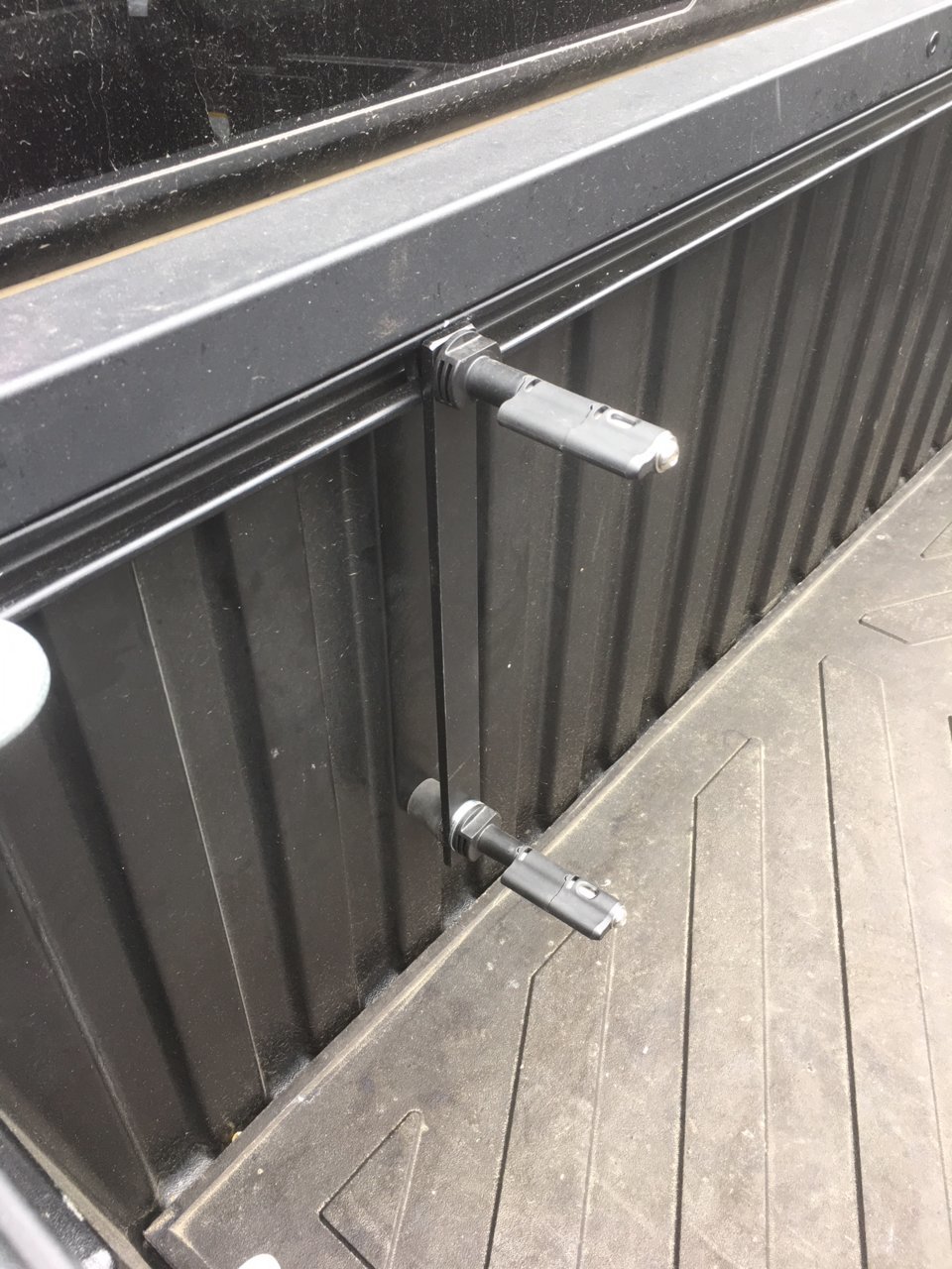

    2017 TRD off-road

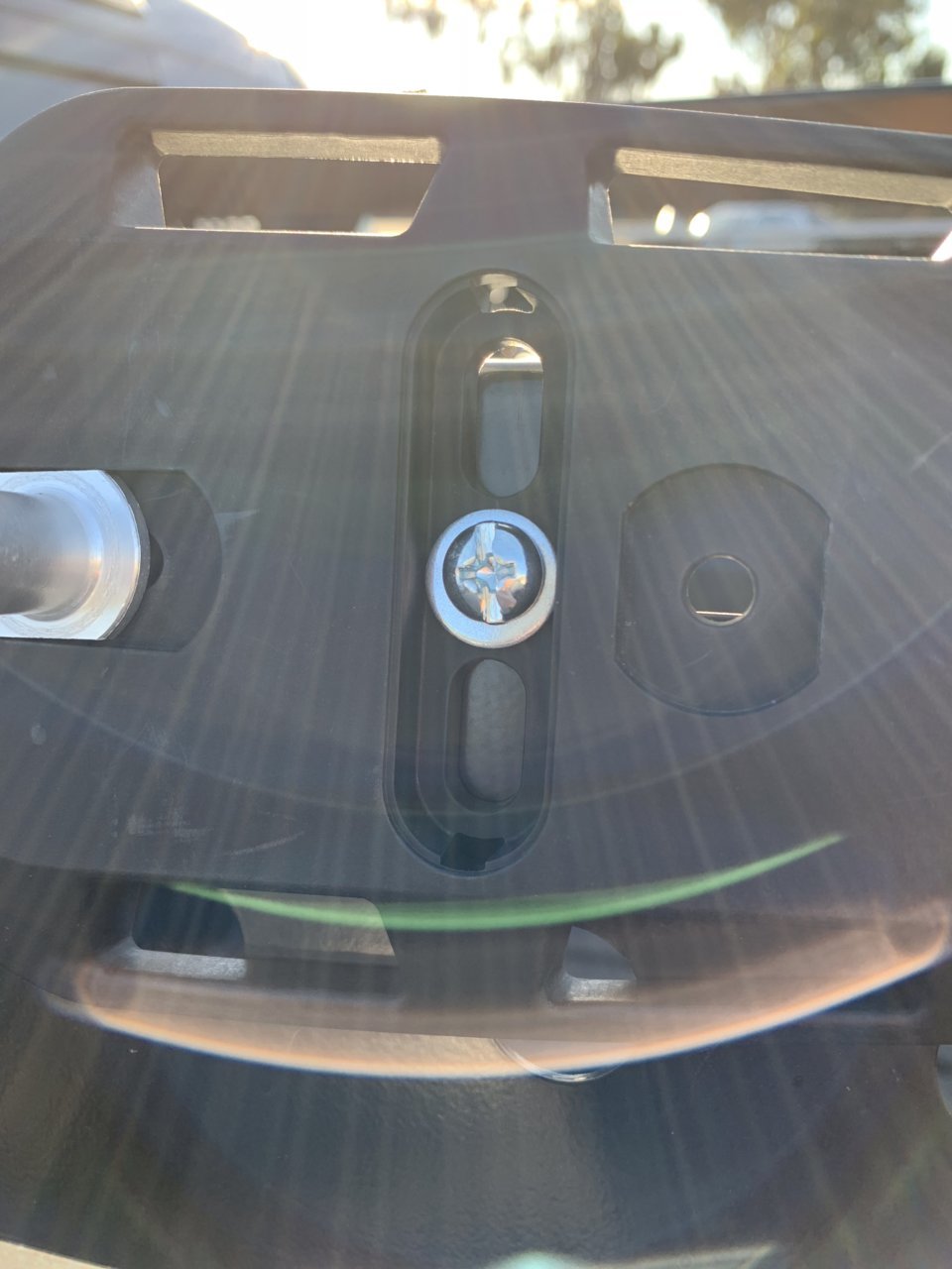

    It’s super easy I used 2 T-Slot nuts that slide in the factory bed rail and just 2 Allen head bolts with washers I had laying around. I know 3rd gens don’t come with the front bed rail. I bought my bed rail off ebay. Bolted right up.

    Got any close up pics? I have some I want to try mounting to the OEM rack.

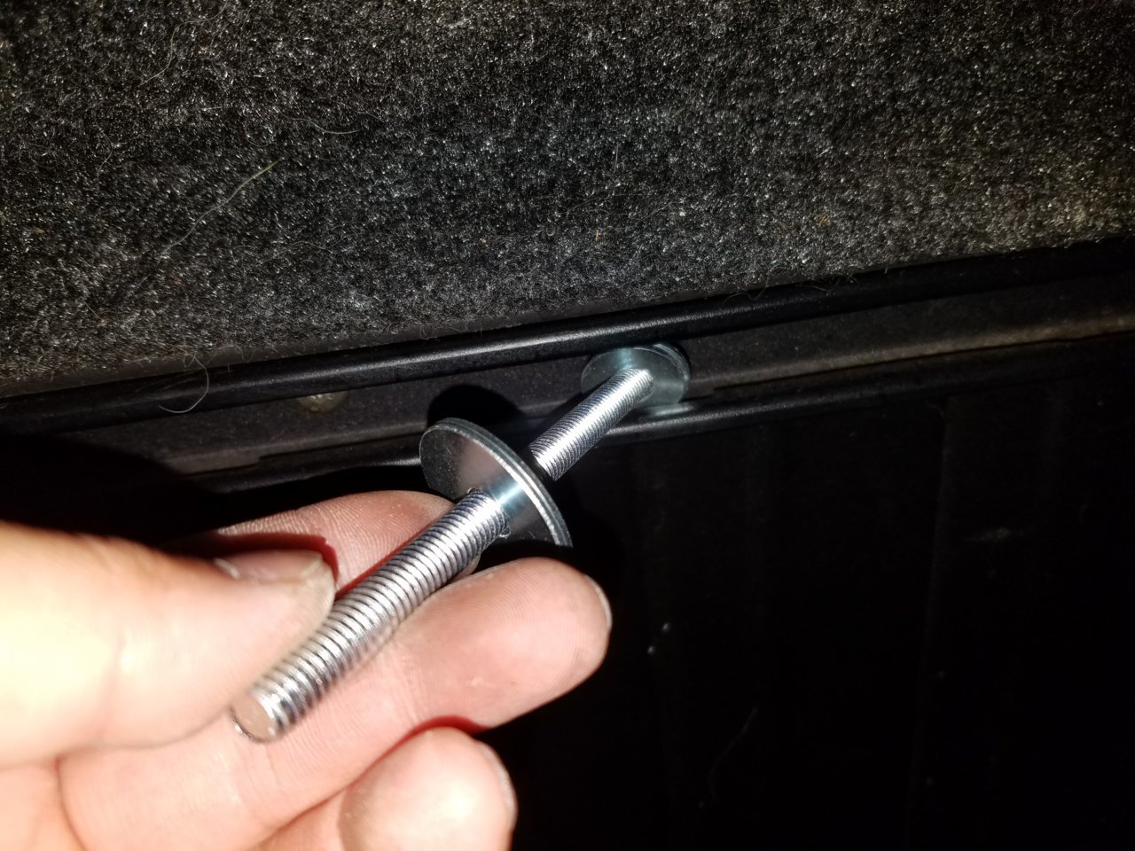

    #142304
    65

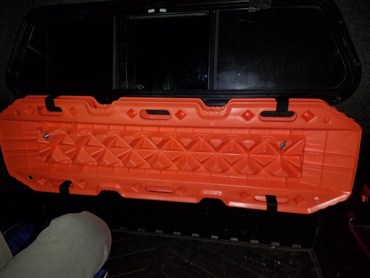

    Went to Lowe's and bought a few bucks worth of washers (1 inch and 1 1/4 inch), bolts, (4 inch 5/16), and nuts.
    Drilled a few holes in the Maxsa boards...
    Buddy of mine helped out. Extremely simple mount lol but it works. I guess the hardest part was lining up the the bolts on the rail to the holes on the boards.

    Where can I buy a set of these mounting brackets?

    I bought the mounts from the dealer that I got the boards from ($30) and the steel strap from the local hardware store.

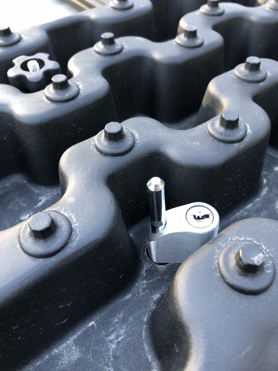

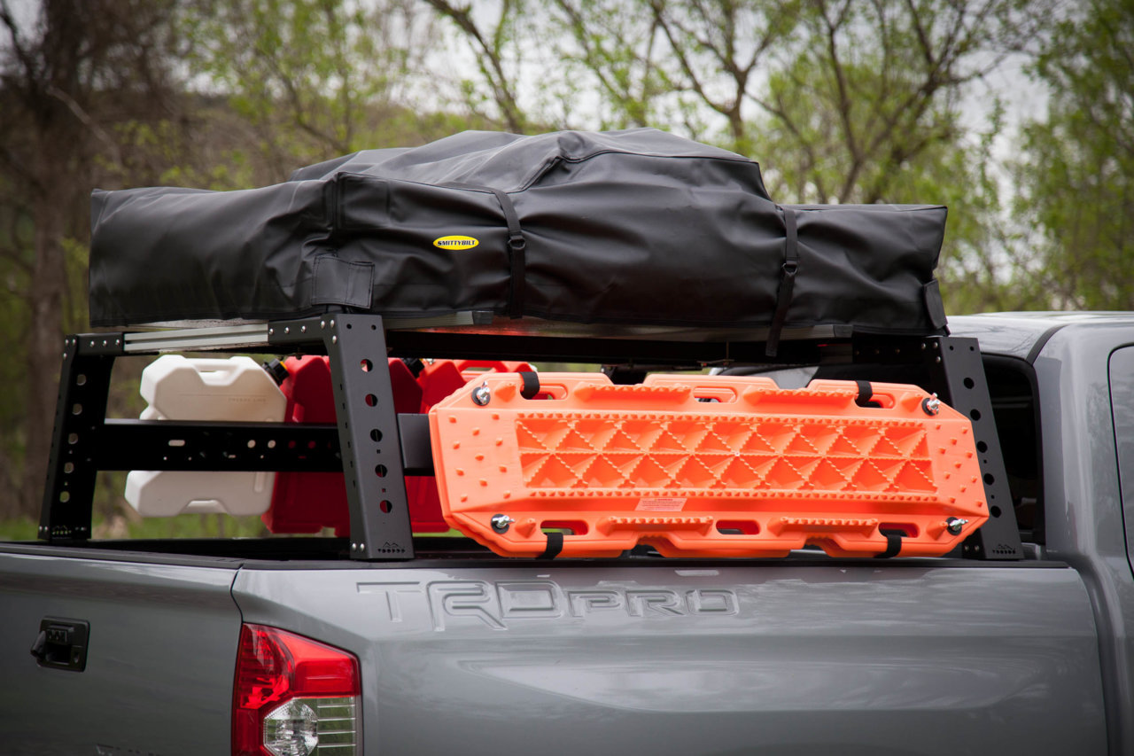

    I used 1/4-20 carriage bolts to mount it to my Prinsu rack with these star knobs: https://www.amazon.com/gp/product/B00GORWKB0/ref=oh_aui_search_detailpage?ie=UTF8&psc=1
    And I bought one of these as a lock. https://www.amazon.com/dp/B00CSBR6UQ?ref=yo_pop_ma_swf
    FYI that lock WILL NOT work as is with the Prinsu rail channels (80/20 10 series) as is. The head is too tall and the shank is too wide to pass through the slot opening. Even though they call it 3/16”, it’s actually like .280”. I turned the bottom of the shank down on a lathe to .240” and cut the head down and now it fits perfectly. It’s a sweet little lock so I’d thought I would share it. Unfortunately you have to have access to a lathe or get creative with a grinder.

    Also, I used 3/16 stainless carriage bolts on my rack (not prinsu or whatever), cut them to size, and used Gorilla tape on top of those knobs to prevent water penetration as it doesn't look like hardware inside the knob is stainless. Works close to 4 months now. Might have to come up with better plan for the winter.

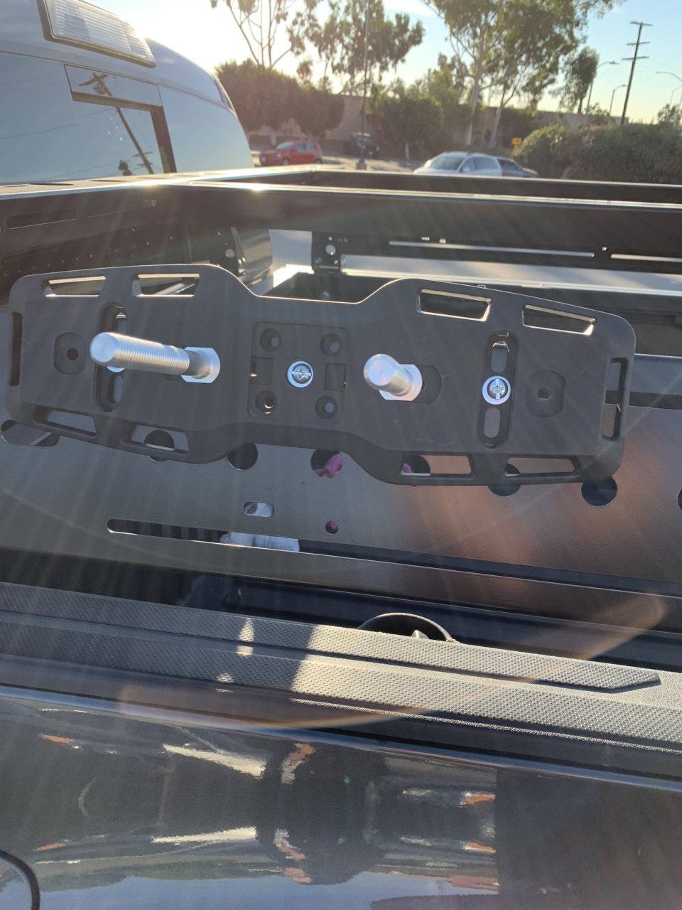

    TRD Pro Skid Plate, TRD Pro Grille, Interior LED Lighting, Front Window Tint, KB Voodoo Bed Rack, Cali Raised Side Projecting LED Ditch Lights, Hood Vinyl Wrap, Wheel Vinyl.
    Will this also work on the Long bed mid height rack? Don't want to get the brackets and it scratches the truck.
    Thanks

    Yes, it will work without touching the truck.

    I grabbed some cheap xbull traction boards from Amazon. I think I am going to try to mount them to the tail gate by mounting a bed rail then using t nuts and bolts to secure the boards. should be pretty simple as long as it doesnt interfere with my bed cover

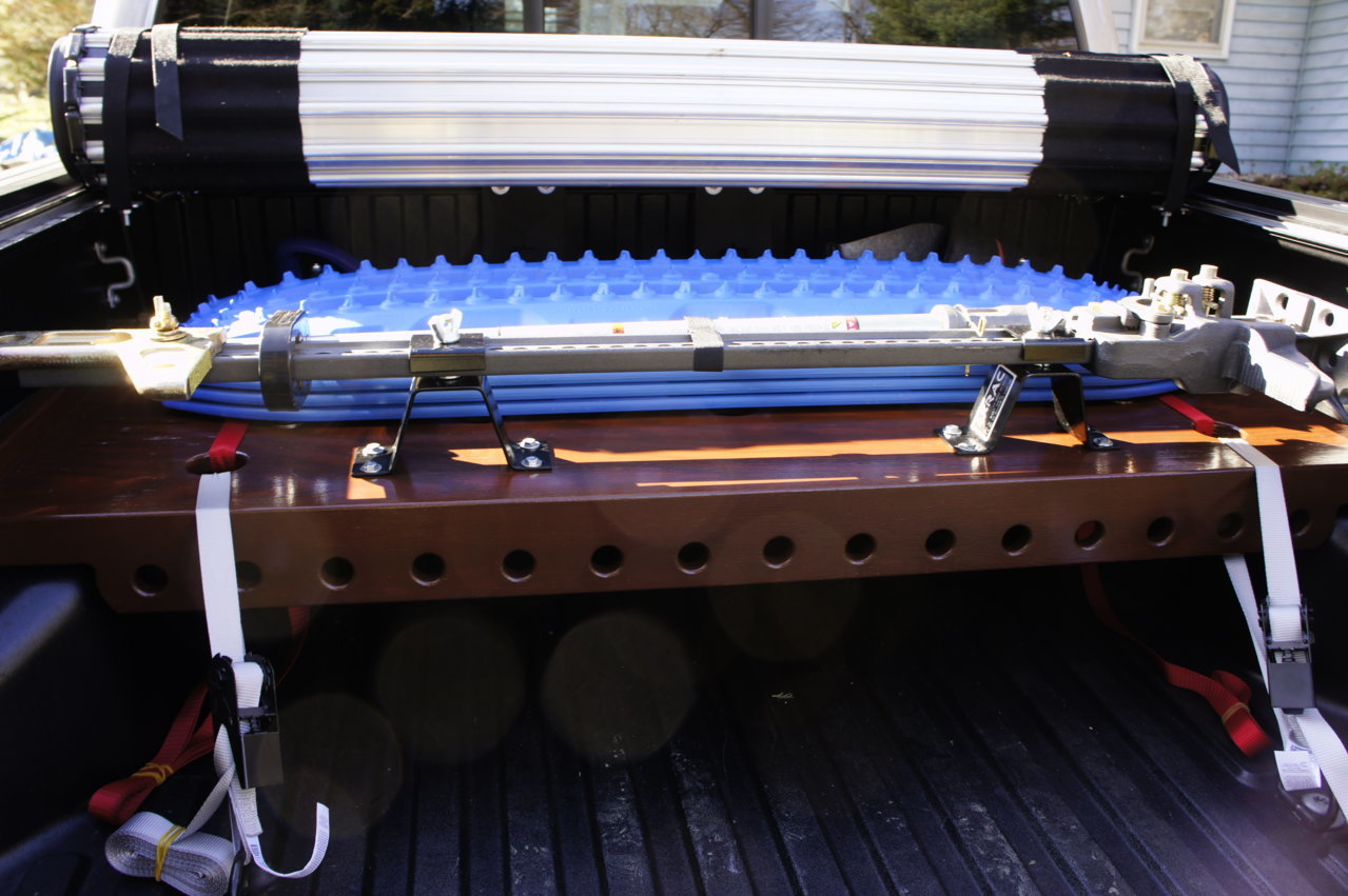

    Here is how I attached my xbull boards...
    Clevis pins are the shit, 4 of the 1/2"×3" ones and a cable lock and I'm good to go... slowly becoming EAF :oldglory:

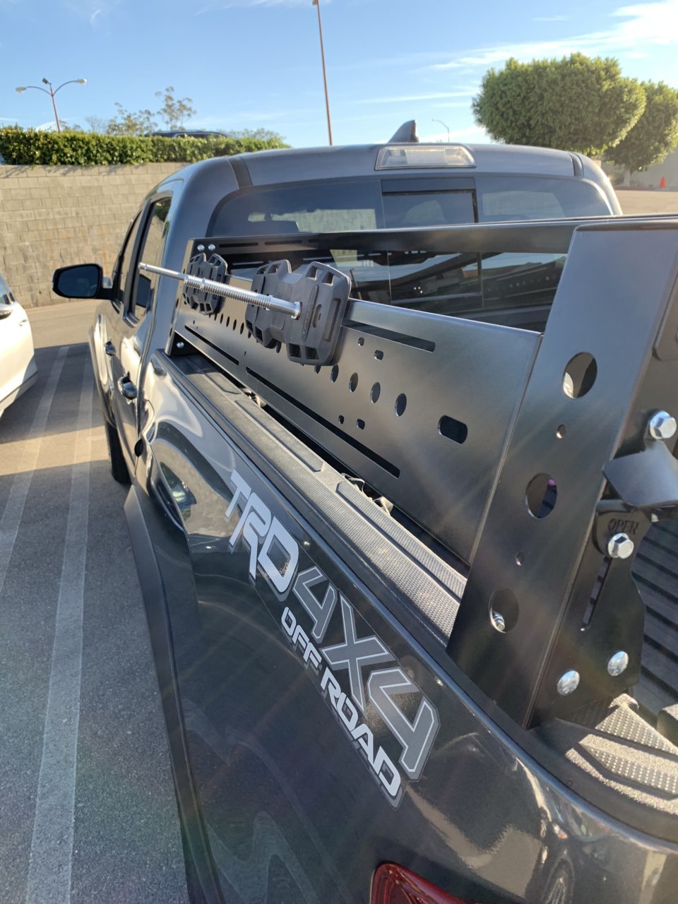

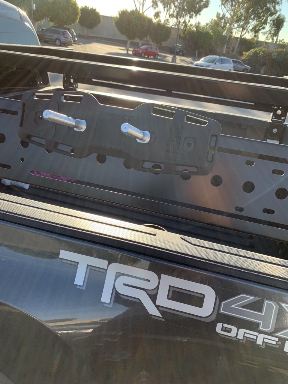

    xGRIMEYx
    xGRIMEYx Go follow #RheaTheGray on IG!
    Oct 11, 2011
    #65066
    301
    RheaTheGray
    fort worth, tx
    17’ TRD PRO
    Fox 2.5s w/resi SSO slimline front bumper OVTune 1.05 SCS ray10s 285/75/17 KO2s JL Audio C5s Rigid Industries ditch lights & light bar Warn VR8-S gen II RCI rear bumper 5.29 nitro gears UpTopOverland roof rack TJM sliders ARB twin compressor bed mounted
    oh i thought you had it mounted in the bed, i don’t have a rack to mount it on so i’m wondering if that mount can go in the bed some how?
