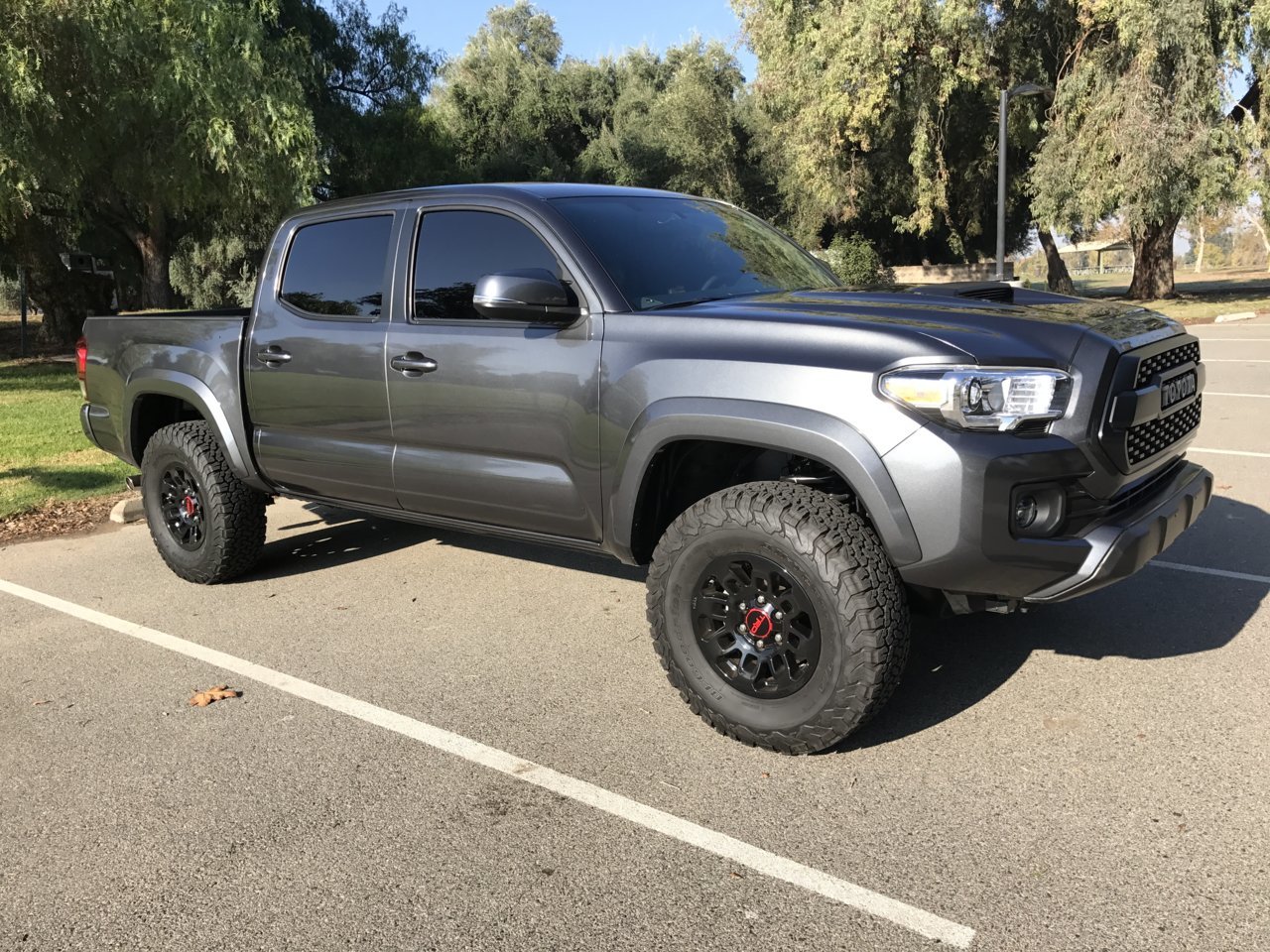

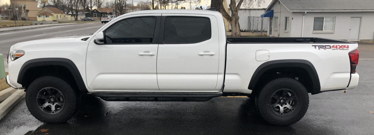

    Well I can add to this thread since I gave in to the want to do a small level on my truck.
    First pic is with 884 springs
    Second is with stock springs and 5100s on third (1.1) perch

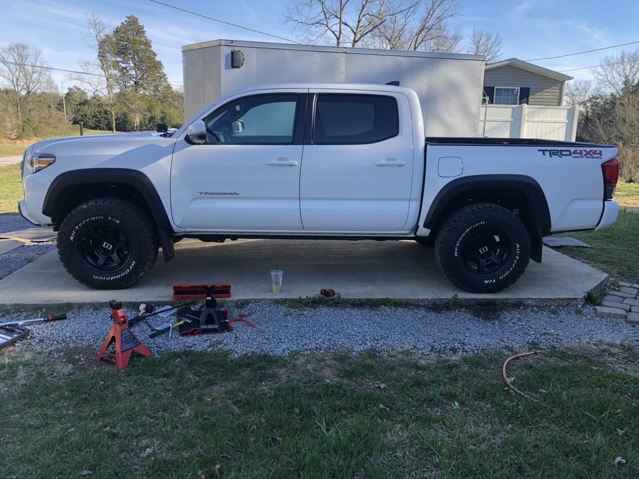

    OME 886/HD Leafs w/nitrochargers LVL8 MK6 16in Wheels w/265/75/16 BFG KO2 Rigid Ditch Lights w/CaliRaised Brackets Various MESOs B&M Trans Cooler WeatherTechs LED Hi/Low w/Fogs Pop N' Lock Tailgate UltraGauge MX HD Front Brakes OVTune 1.05 2000 T4R SOLD 2014 RAV4 SOLD 2008 FJ Cruiser RIP 2010 Scion tc
    Super easy, they sit on top of the strut so it doesn't have to be torn apart.

    Enough threads left? I thought I read the studs had to be pressed out. I’d do this if it was really that easy.
    How much did you have to disassemble?

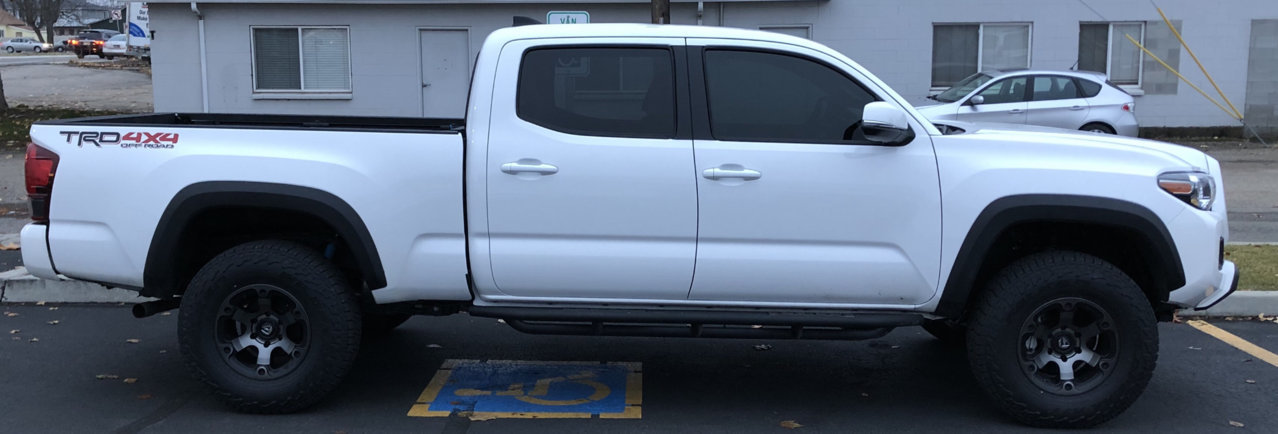

    I just went thru this Dilemma.
    The truck comes stock with 1.5 inches of rake
    I did not want to tear apart the strut. the 1" spacer kit makes you replace the bolts and i was not going to do that
    This left me with 2 options. A 1/4 inch spacer up front or a 3/4 inch spacer up front and a 1" rear block
    I took a Jack to lift up the front 1/2 an inch and was like "NAH"
    I went with option 2. I did have to cut down the threads with a cutoff wheel to the front studs but zero issues so far.
    When the struts/shocks wear out I will put a 2" lift out front and a 1.5" ALL in the rear
    Recently took a road trip with the back seat filled with stuff and the bed also. No bro lean. If i had put a 2" spacer up front i would have had lean
