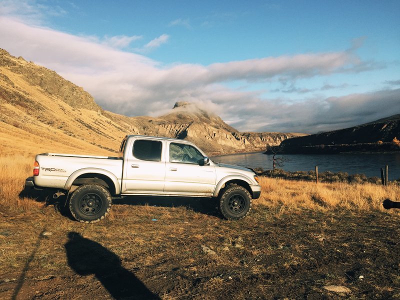

  8. Nov 8, 2016 at 1:54 PM
    #268
    Pescado
    Pescado Well-Known Member
    Nov 26, 2015
    #170696
    93
    Vancouver
    2002 Lunar Mist TRD DC
    265/75/16 BFG KO2, Pro Comp 7069, General Springs HD leaf pack, Bilstein 5100's, Snugtop Canopy
    I have the 7069's and am still very happy with my choice. I have only about 1.5" of lift and they fit 265/75/16's with no rubbing. Here they are with the rear end getting a bit of flex..

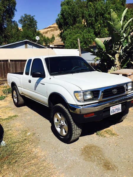

  11. Nov 8, 2016 at 9:10 PM
    #271
    FLBAdrian
    FLBAdrian A Pretty Sizeable Onion
    Oct 25, 2016
    #200619
    2,613
    Adrian
    Hanford Ca,
    1996 X-Cab 3.4l 2014 Tacoma crew cab
    Too many…

  14. Nov 9, 2016 at 7:28 AM
    #274
    FLBAdrian
    Oct 25, 2016
    #200619
    2,613
    Adrian
    Hanford Ca,
    Too many…
    Yes they 17 idk about sport wheels.

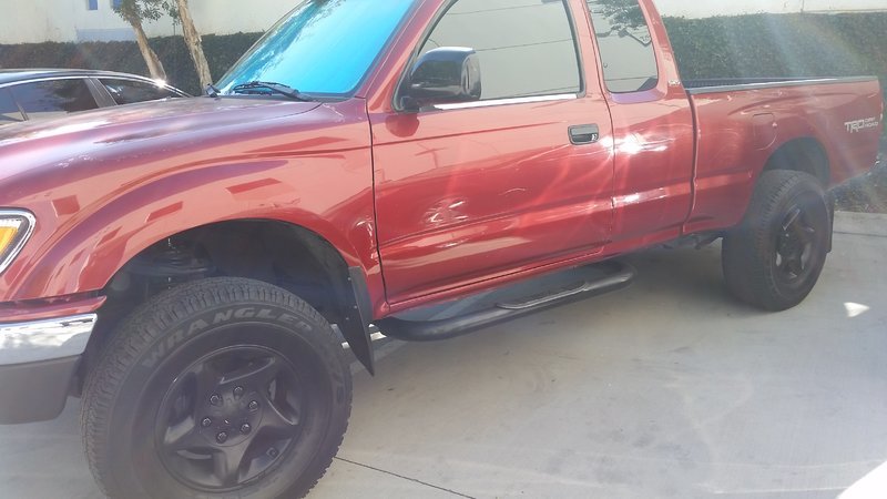

  15. Nov 9, 2016 at 8:36 AM
    #275
    taco03Trd
    taco03Trd 03 rig trd v6
    Sep 29, 2016
    #198568
    1,150
    Carlos
    Riverside ca
    03 DC prerunner trd v6 2wd
    Ome 881 5100's jba's looking for more
    20161108_101950.jpg here's my 01 pre trd just upgraded supension to 5100 all around going to add aal this weekend .
    LOOKING to upgrade to 265/75 next
    lucky13don likes this.
  16. Nov 9, 2016 at 10:47 AM
    #276
    FLBAdrian
    Oct 25, 2016
    #200619
    2,613
    Adrian
    Hanford Ca,
    Too many…
    How you like the 5100?
  17. Nov 9, 2016 at 10:53 AM
    #277
    taco03Trd
    Sep 29, 2016
    #198568
    1,150
    Carlos
    Riverside ca
    Very happy with this set up . got my trd's coils at middle setting the ride is great ..no complaints at all .. you looking for the same set up ?
