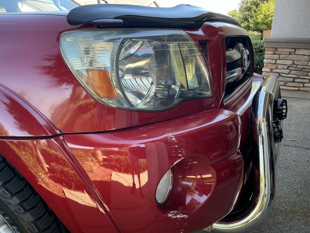

    IMG_1474.jpg Restore them. I used Meguiars heavy duty restore kit on my 15 year old lights a few years ago and they still look like new. I just spray them with UV Protectant once a year and they are good. The truck is outside 24/7. Here’s a pic
    The lights you show are made in china. They are likely crap

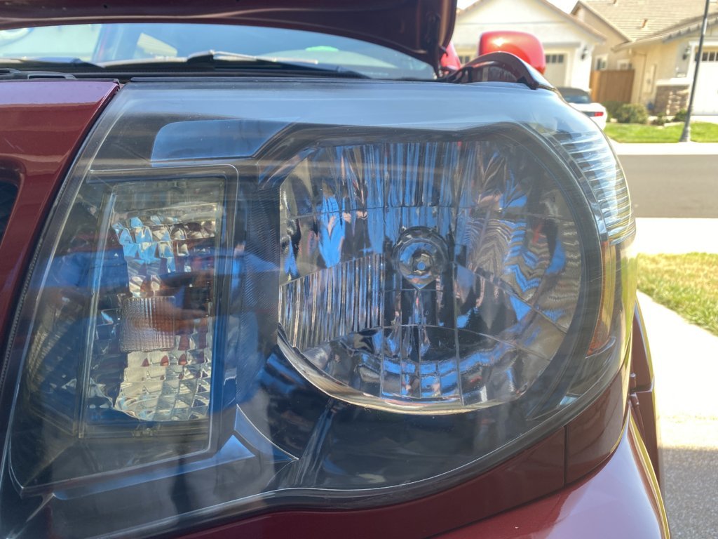

    Many people do not have good success when they restore headlight lenses. They polish the headlights until they are clear then sit back and complain when the lights start to fog and yellow after 6 months or so. The reason they get hazy again is that a UV protectant isn’t applied. I apply UV protectant twice a year (even though it only calls for once a year) and my lights remain clear as new (or almost new). I originally did my lights about 7 years ago. I did a 15 minute touch up on them about 2 years ago. Here’s a pic I took 2 weeks ago. It’s not a good pic of my head light but it shows how clear it (still) is. The pic was meant to be of the scratches on my bumper , (which are now painted and can’t be seen)but it shows one of my headlights. Also a pic of the protectant I use.
