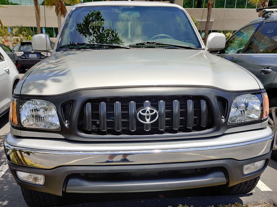

    Here is a mini review on this ebay 5 piece grill set (two headlights, two corner lights with black trim, and a black grill/surround). I hit 200K miles so I decided to give her a little TLC. Replaced the stock plastic/chrome grill (previous owner had installed a billet grill that I painted black) with a black grill/surround. I like the look of the vertical bars on the stock grill.
    This is the 5 piece set https://www.ebay.com/itm/Toyota-200...Black-Headlight-Park-Light-5Pcs-/170668031919
    I just wanted the black grill and corner lights with black trim, but this combo with the lights was about the same as buying the grill and corners separately.
    Grill:
    Came well packed. The nine attachment points lined up very well. The grill came with the seven small clips already attached and they seemed to be almost as good as the OEM clips. The two large clips that it came with (attach to the plastic piece at the bottom of the headlights) didn't want to click into place. I got two large OEM clips from my local Toyota (OEM had a much larger "barb") and they clicked right in.
    The only problem with the grill was the oval recessed area for the Toyota emblem was not big enough. I thought maybe the clip holes were not exactly where they needed to be so I broke those off the emblem and it still didn't want to go in all the way. I could get the top or bottom of the emblem to sit down in the oval, but not both at the same time. I took a Dremel tool to the bottom of the oval. Didn't have to remove much plastic and then the emblem fit right in. I used shoe-goo (black) to hold the emblem in place.
    Overall I am happy with the grill. Only had it a week so hard to say about durability.
    Light housings:
    Decent cut-off line, but splotchy. The pieces that swivel and attach to the truck had a lot of play in them and the housing would move a few mm if you pushed on it.
    Corner lights:
    They slid right in. There is what looks like a glue or plastic weld line that goes around the perimeter of the lens that isn't straight (it meanders along), but they fit well and if you aren't looking at them from a foot away look good. The black trim on the corners is more of a gloss compared to the matte black of the grill, but they are a decent match.

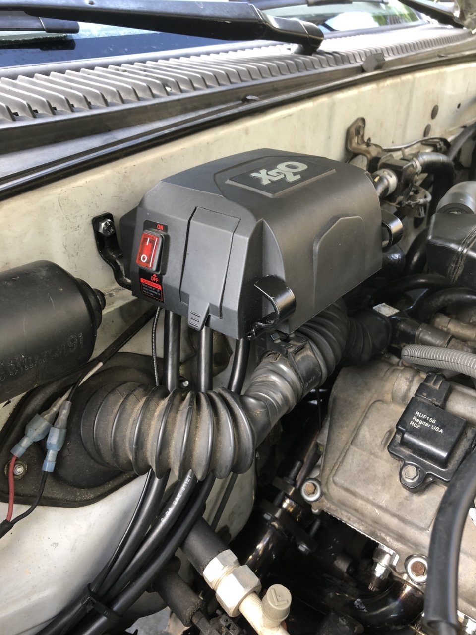

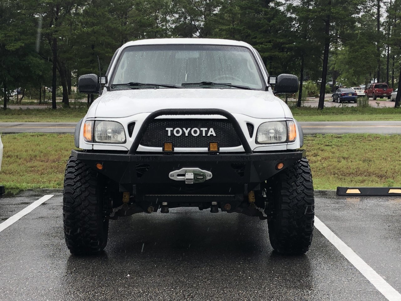

    EBay raptor mesh. Turned out decent enough. I had to relocate my winch solenoid to the firewall though to avoid cutting the grill.

    Anybody know what bumper this is? It matches exactly what I’m looking for.

    it’s CBI’s MOAB 1.0 WIY (weld it yourself) They also sell the MOAB 1.0 completely assembled.

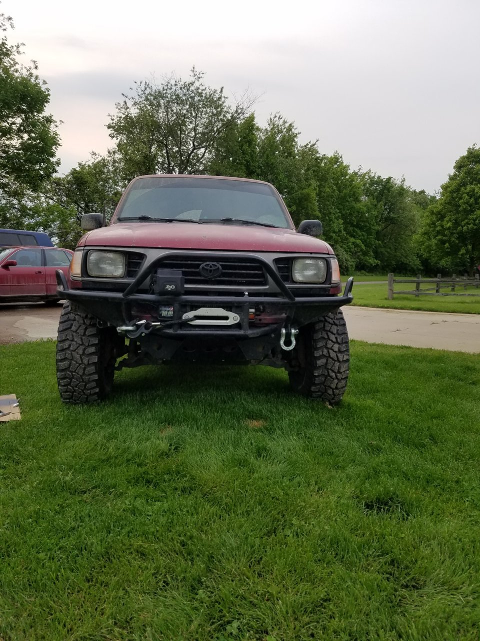

    Anyone know which bumper this is? It looks a bit different than the common ones I know

    Trail gear with a possibility of a custom hoop.

    It was mine. Trail Gear low profile with their optional light bar
