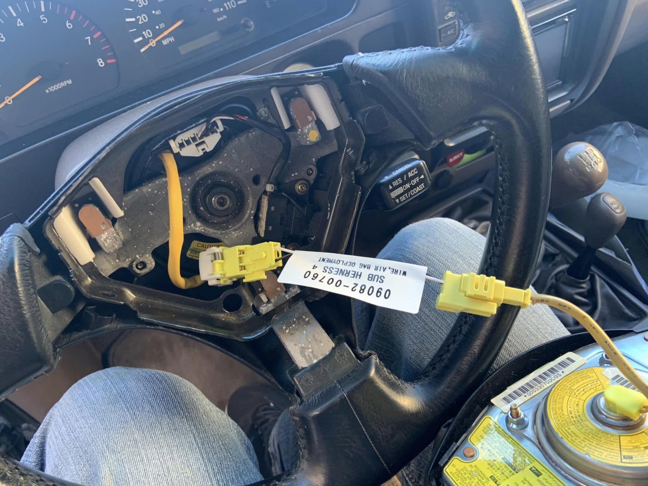

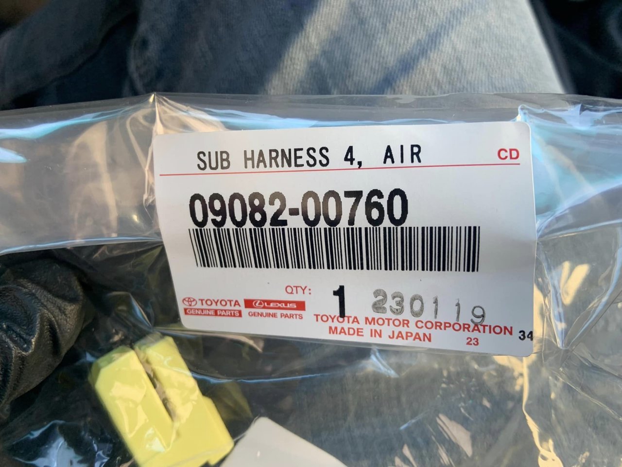

    i know this is an old post, however i ran in to the same issue. 99 SR5 here, swapping in an 01 is300 manual steering wheel.
    the airbag connector from the OE tacoma clock spring is a different connector which is on the IS300 bag.
    Toyota sells a JDM conversion plug "Sub Harness", part number: 09082-00760. I got it from a vendor in Japan via Ebay that sells these so you can put the IS300 steeringwheel on 3rd gen Supras, etc.
    These clip right in- There is just enough room in the IS300 steeringwheel to stuff the connector (bottom left) without interference with the OE clockspring... I have not tried to re-wire the cruise control yet (i really dont use it that often and i didnt have time to 3D print a cover for the IS wheel.. so i left the stalk there.. Horn works fine which is most important to tell losers on the phone in front of me to move ...

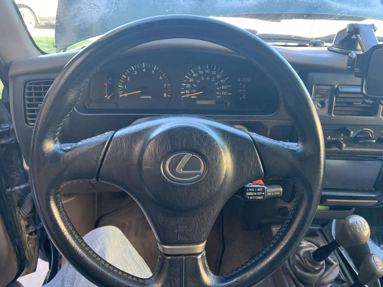

    Installed my iS300 wheel yesterday.
    Very happy with the result.

    SRS Adapter:
    The Ebay Seller I used was "Candy-Japan".. It was sent FedEx and was very well packaged. Here is the listing for the SRS adapter.
    https://www.ebay.com/itm/314217642998

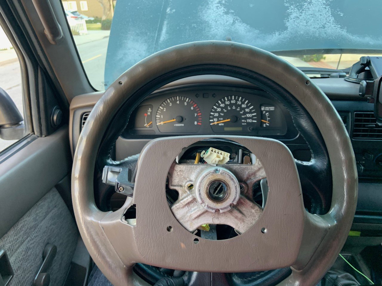

    Here is a comparison of the two size differences between the IS300 and OE Tacoma 2spoke.
    I think the IS300 steering wheel is approx 370mm which is ~ 14.5"
    The IS is very nice, has contours for thumb grips and just in general a thicker/firm feel compared to my spongy de-laminating Tacoma steering wheel.
    I was able to find the manual version locally, sourced with airbag for $150 off FB marketplace.

    You're the MF MAN! I don't have the truck anymore, but will let my Brother in-law know this will get the SRS working again. Light off, and all?
    Thanks!
    #37
  18. Apr 17, 2023 at 11:20 AM
    #38
    chebosto
    chebosto Member
    Mar 30, 2023
    #421437
    17
    Gen 1 SR5 4x4
    Correct. No SRS light.. light is off. Airbag fits. Horn works. Have not re-wired for Cruise Control tho... dont really plan on that tho- haven't decided on that..
