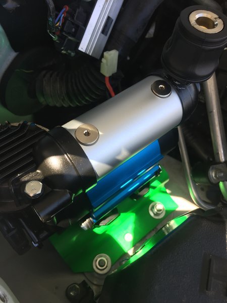

  6. Dec 6, 2016 at 4:22 AM
    magnus 15
    magnus 15 Well-Known Member
    Jul 21, 2015
    #159989
    113
    Kevin
    017 TRD offroad
    Google arb compressor mounting location tacoma world, this is how I found a spot to mount my twin arb. Another member had mounted his and posted pictures and I copied his idea.

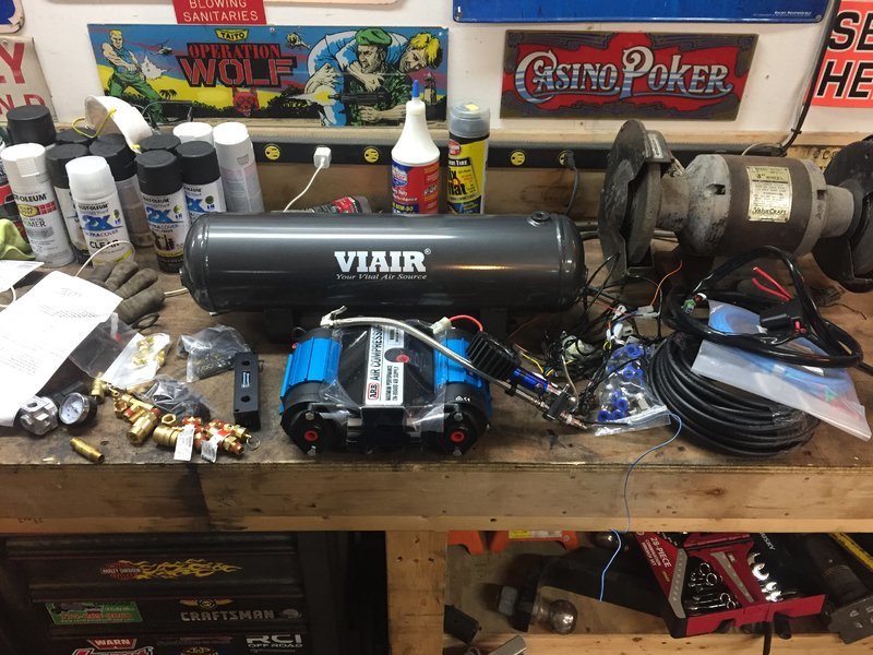

  10. Dec 6, 2016 at 5:03 AM
    HolyHandGrenade
    HolyHandGrenade NOOB
    Mar 25, 2013
    #100579
    11,800
    Tim
    Garage Most Likely
    DCFB (RIP)
    Some Stuff
    As far as I've gotten thus far...
  11. Dec 6, 2016 at 5:08 AM
    greeneggsnspam
    greeneggsnspam ಠ_ಠ
    Oct 30, 2013
    #115524
    42,619
    Houston, TX
    .gif
    Too poor to list anything interesting.
    Looks like the point I'm at with several projects.

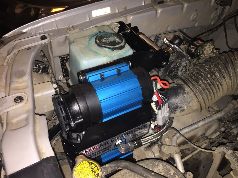

  15. Dec 6, 2016 at 10:46 AM
    chenbro
    chenbro ¯\_(ツ)_/¯
    May 27, 2009
    #17697
    3,334
    Broomfield, CO
    2009 Silver DCSB TRD OR
    What haven’t I changed?
    ARB Twin with remote manifold installed with the Slee bracket. I used aftermarket stainless steel hose and fittings to plumb the manifold to the compressor because the Slee kit came with a piece of plastic tube. They have since replaced the plastic tube with a braided stainless hose like the short one that comes with the manifold (and even sent me one free as a replacement), but it's still 1/8" ID and I'm lazy so I'm sticking with my aftermarket one.
  16. Dec 6, 2016 at 10:52 AM
    #16
    duvinclunk
    duvinclunk Well-Known Member
    Jun 9, 2016
    #189147
    1,300
    Davin
    Salt Lake City, UT
    2016 DCSB|OR|QS
    I'd like to do this with a braided line but have quick connect where the manifold mounts instead. Need confirmation the manifold isn't needed...
  17. Dec 6, 2016 at 11:00 AM
    #17
    chenbro
    chenbro ¯\_(ツ)_/¯
    May 27, 2009
    #17697
    3,334
    Broomfield, CO
    Manifold isn't needed unless you're going to run air lockers, so you'll be fine if you just need the one quick disconnect to air up tires or to connect other air attachments like a small pneumatic impact driver.

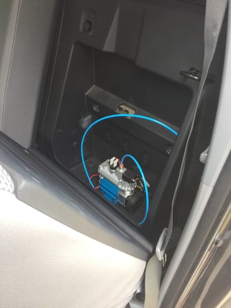

  18. Dec 6, 2016 at 11:07 AM
    #18
    jakebray
    jakebray Well-Known Member
    Apr 6, 2015
    #152649
    1,045
    jake
    SoCal
    13 PreRunner
    Locked DCLB with Kings and crap
