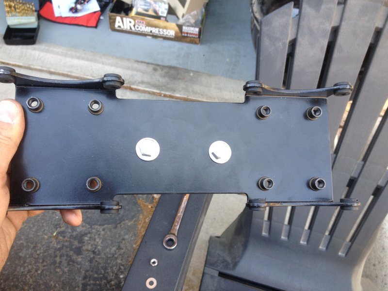

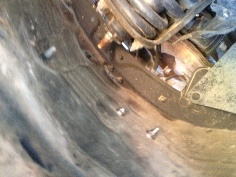

    The second picture is of the bolts dropping through the wheel well.

    so you didnt use those 3 bolts that are coming up from the wheel well?

    I honestly can't remember :oops:.

    It came with it. I believe I have an extra one too.
