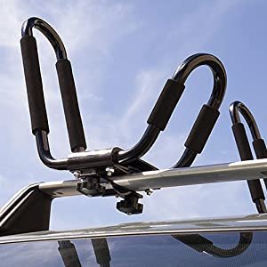

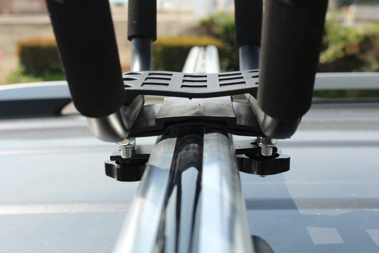

    I don’t have actual photos but it looks like this
    6E1C3BBC-89BE-4B5A-BFD8-DF9DD504B896.jpg A0EDFE3C-8649-4D00-93AE-03D857F741EB.jpg
    It works fine but there are definitely better options. The prinsu rack is too flat for the curved j hook clamps at the bottom

    I see, so the T slot track in the prinsu bar isn't being used. I have similar stuff needed mounting, I tried t slot method, just won't fit tightly unless I damage the track.
    I'll look into the clamping mechanism, thanks

    Yakima Jaylow kayak racks are perfect for racks with 80/20 crossbars. The clamps grip the sides of the crossbars, not the top and bottom.
    I don't know that I would trust the t-slots for mounting kayaks anyway. not enough surface area on a t-nut for something that will catch that much wind. traction boards, cases and such I wouldnt have a problem with, but not a kayak. We use 80/20 a lot at Amazon, and I've seen how little it takes for a t-nut to vibrate itself loose.

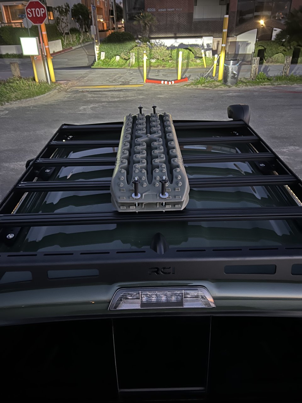

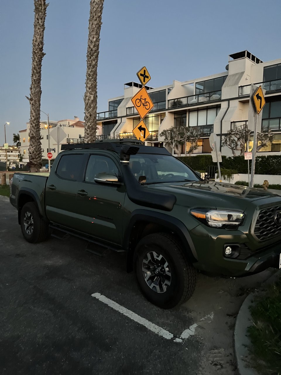

    2021 Tacoma OR w/ RCI DCSB roofrack. Super easy to setup and install. Feels really solid so far. Easy to mount accessories using 1/4 - 20 - 5 1/2 inch carriage bolts. No complaints so far.
