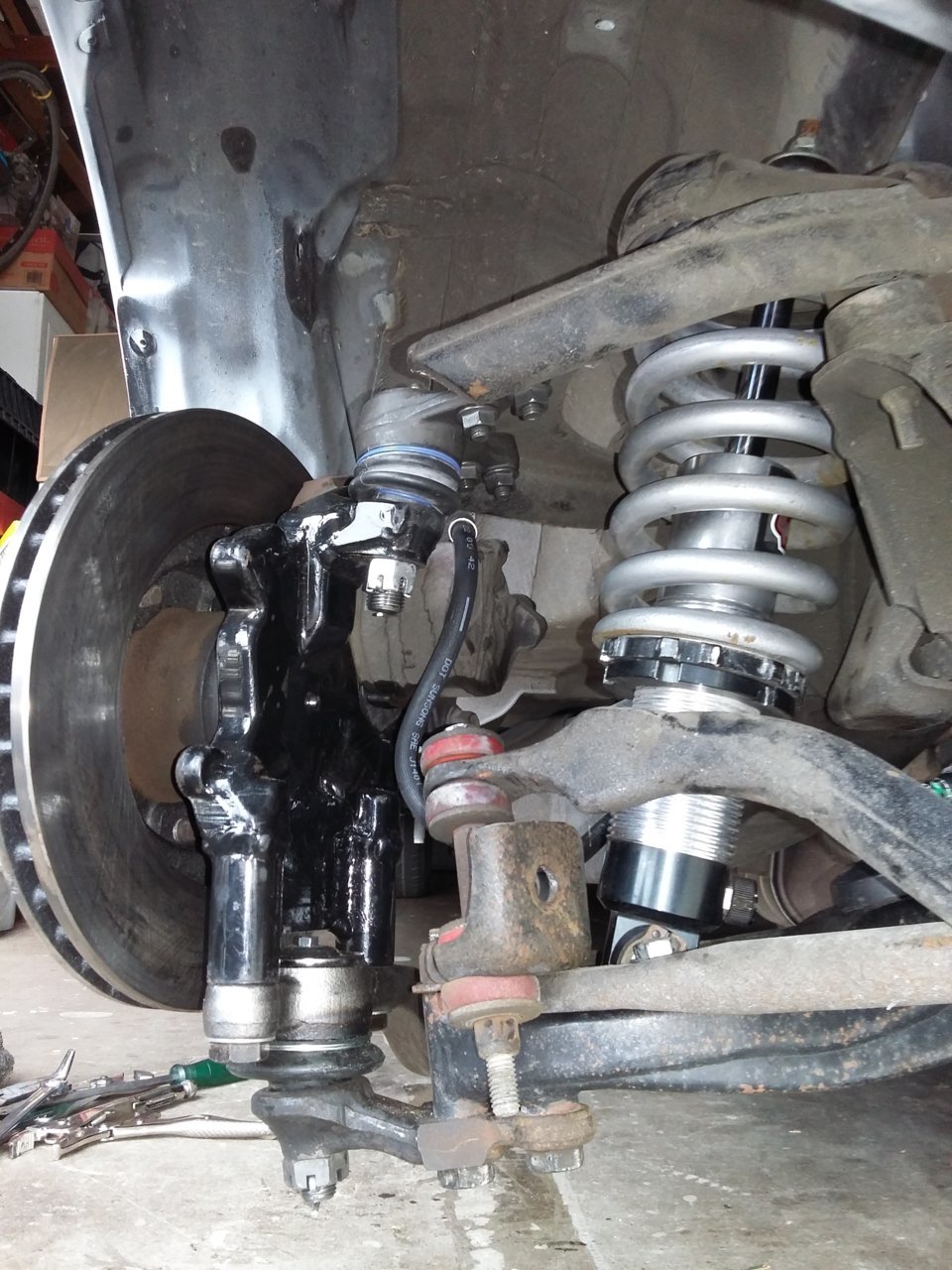

    QA1 coilovers, catfish customs drop spindles, DJM upper control arms in front. 4x4 s-dad mod leafs and 3" blocks with vw bug rear air shocks. 18x9 square set of 370Z wheels
    Once I do notch I'll be going down 1" up front and 1.5" out back. Just enough to barely tuck tire like my 2000

    You used 8” chevy coils right?

    Yes, correct.

    You think 10” coils will fit?
    Because I believe with 8” coils the middle setting is like 2” drop? And all the way up is stock highet.
    Sorry for the questions You are the first person i can across with qa1 lol

    No worries. The 8" cool works best for drop although the 10" may be better for less drop if that's your aim. The QA1 shock body is very short travel so the 8" works well. The 10" may give a quicker preload though and work better for the entire travel of the shock.

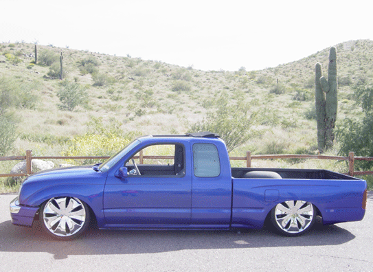

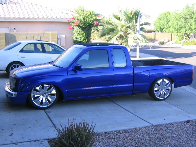

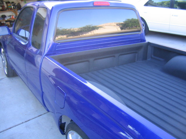

    I miss my bagged 1st gen. Really wish I didn't sell it but at the time I had 3 broken ribs, broken sternum, shattered right ankle (it was manual) and other damages from a car accident. Couldn't drive it because it was manual and the ride just killed my ribs. I found the truck a few years later and some asshat ruined it by being an idiot with it. He has video's of him on the highway laying frame dragging the shit out of it. So much time and work wasted. Wish I never saw that video. oh well. Now I have my wife's 2000 Civic Si that I shaved and is in the process of getting bagged.

    That’s one very nice yota, it’s shaved everywhere. I love getting rid of the corners like you did, the front end means business. You did alot to your truck I feel your pain.. I would show pics but they are so old I’d have to scan them to show em lol. I had an 89 with Japanes bed rails that I flipped and and later saved it, I c sectioned and new cab onto,and a 90 fastbagged with oasis air compressors and nitrogen that would jump 3’ from stinkbug laying frame in the front, then another a completely shaved 91 no body lines,flames lol, and that 22re engine was built hardcore. You my friend are not helping with my addiction to slammed trucks! The new chevy trucks tuck some serious wheel sizes and are the only other vehicle I would slam. I would really like to find an old school Chevy Cameo pickup w/the belair bed style and do something despicable to it.
