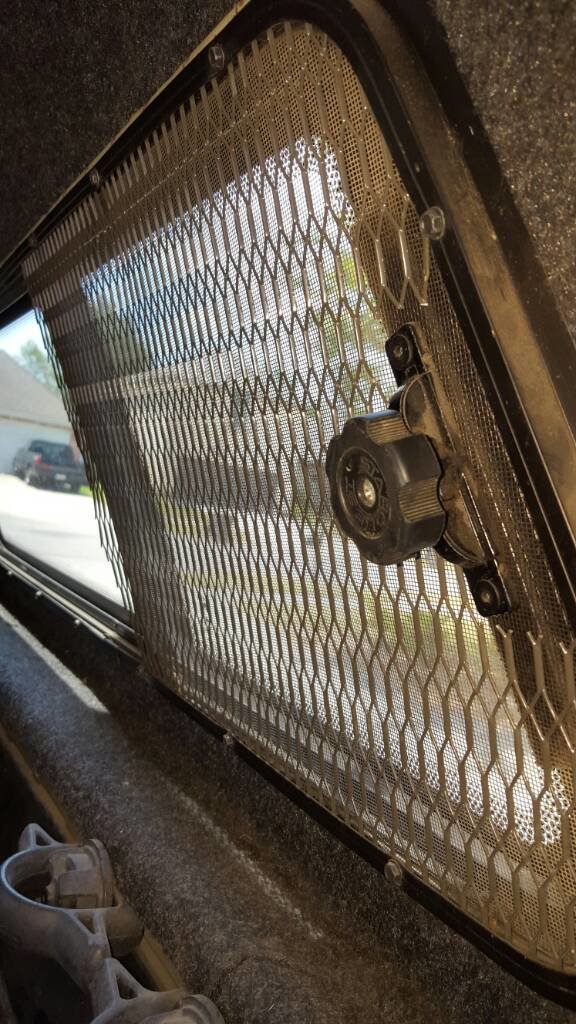

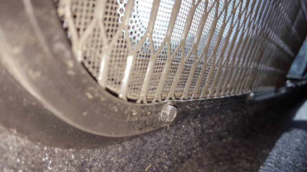

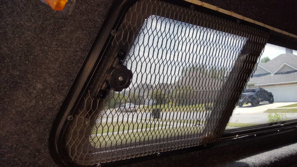

    You can buy a screen door protector at home Depot for about $30. 1 will cover both screens. I made a template with cardboard then cut with tin snips. I painted it black and looks factory and a lot stronger. Took me less than 1 hour.

    Use your imagination! I'll take a pic later today when I get back to my truck.

    It did happen! :D

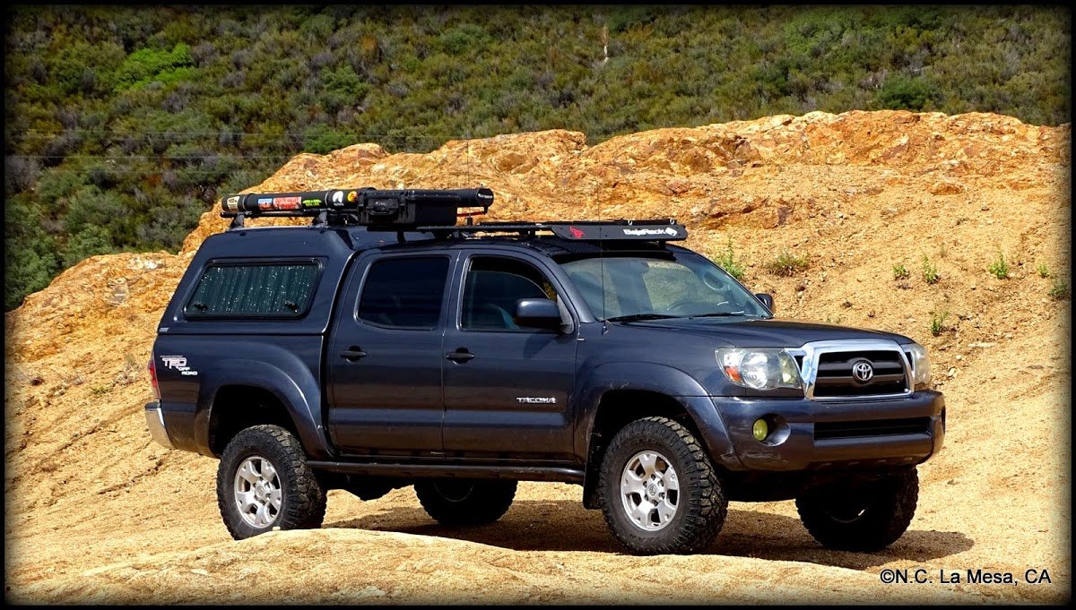

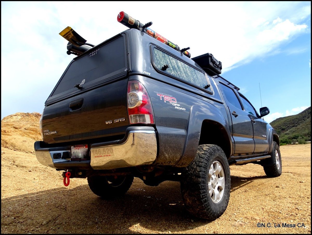

    My A.R.E MX shell is 3-years old this month. I still love it! So much utility, value. :D

    That looks awesome dude!!

    Cool! Who needs easily cut through screens when you can have this. Thinking about doing this as well.
