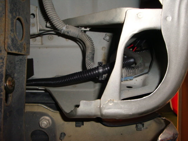

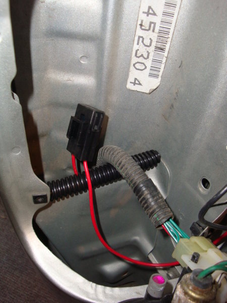

    Ugh. Cap wiring by dealers is often ghetto, low grade, and prone to failure. I'm glad I'll be doing my own on the used Leer I got. I bought the necessary harness and will get to it when I can do a quality job with soldered connection (wherever exposed to elements and quick disconnects not needed), heatshrink, and protective split loom.
    It sounds like this sort of failure was what I foresaw and prevented here on my 01 when installing aux backup lights. I used split loom over the sharp sheetmetal edge where the fused hot wire comes up from under the bed and to the light. Another tip: remove any inline spade fuses and dab some dielectric grease on the spades.
    Here looking up from the bottom, you can see my new loom for the reverse lights zip tied to the OEM loom. If you look carefully, you can also see the typical half-assed sort of work by cap dealers for the interior dome light: the black hot lead with a blue crimped connector and no protection/loom. The Snugtop was on the truck when I bought it used, and I did not have any problems with the wiring, but YMMV.
